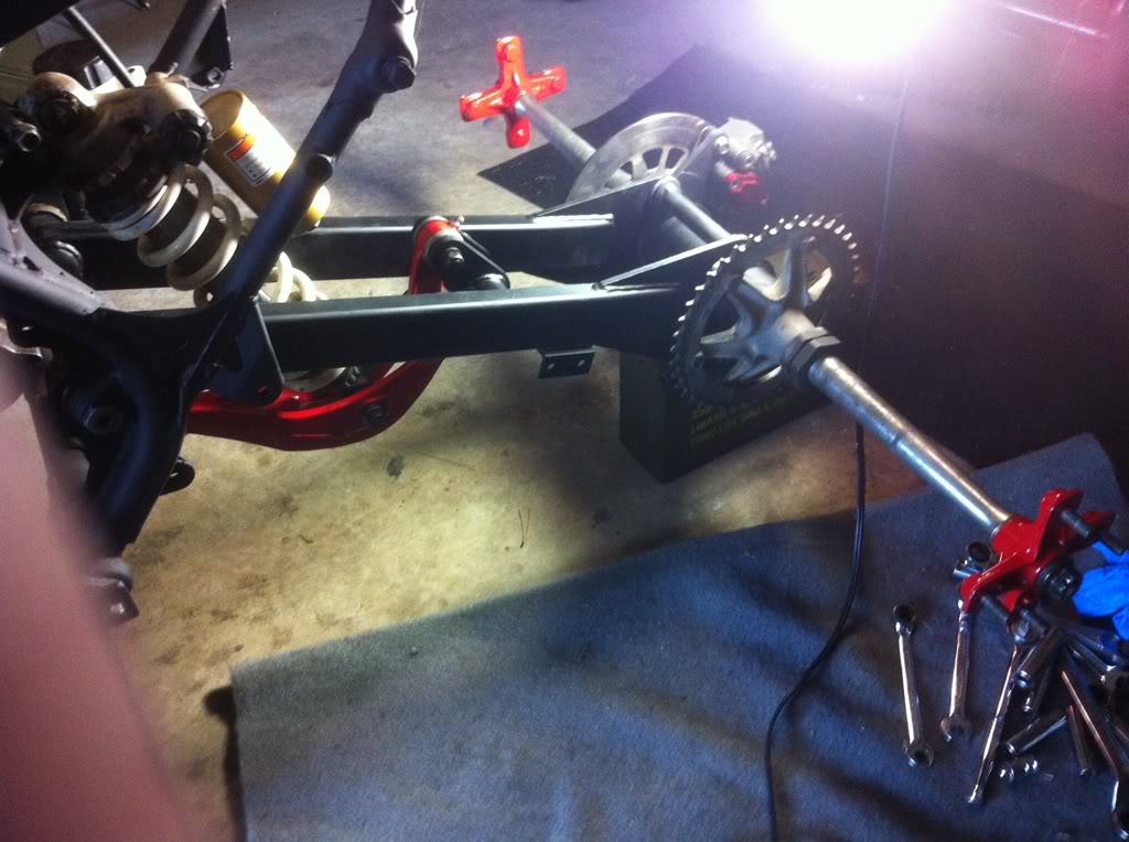

My swingarm finally arrived !!!! And I had no idea it was coming with a spare carrier !!! Bonus !!!!!! Plus adjusters and a nice TM Design Works chain roller!!!!
And the pivot bearings are in great shape!!!!

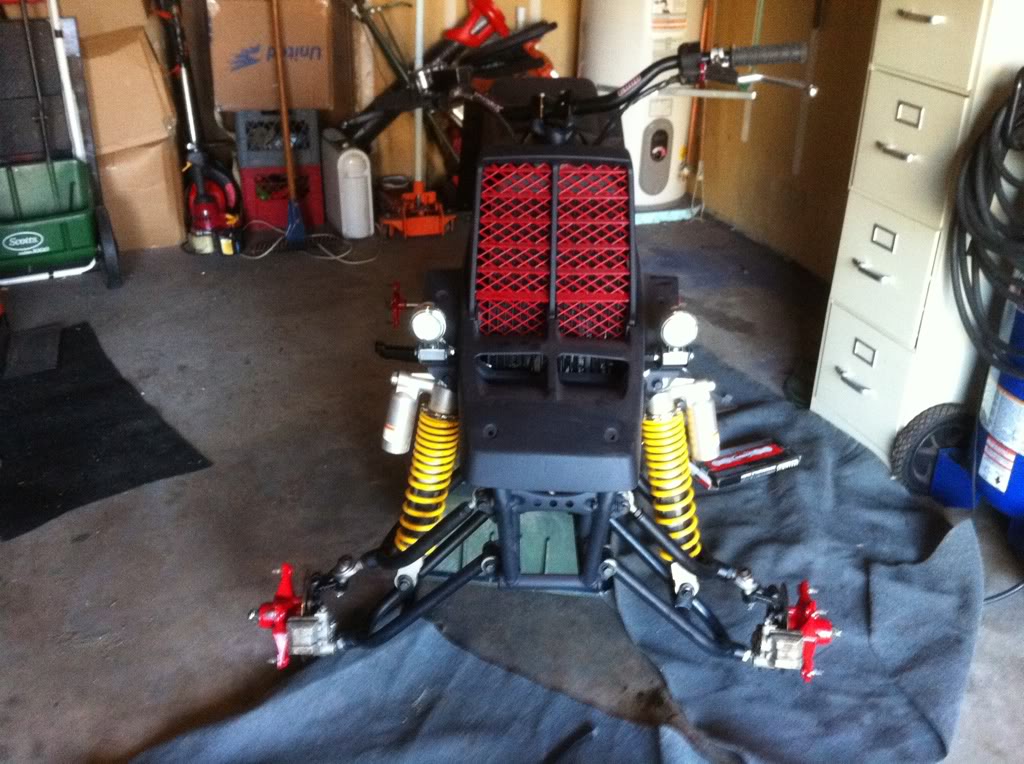

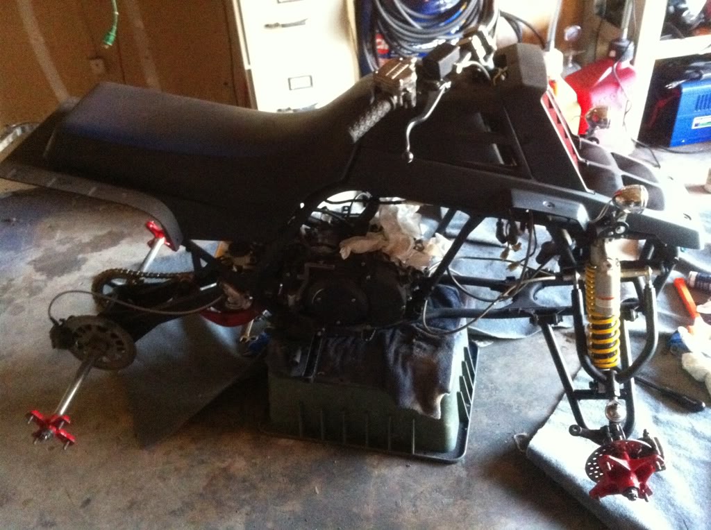

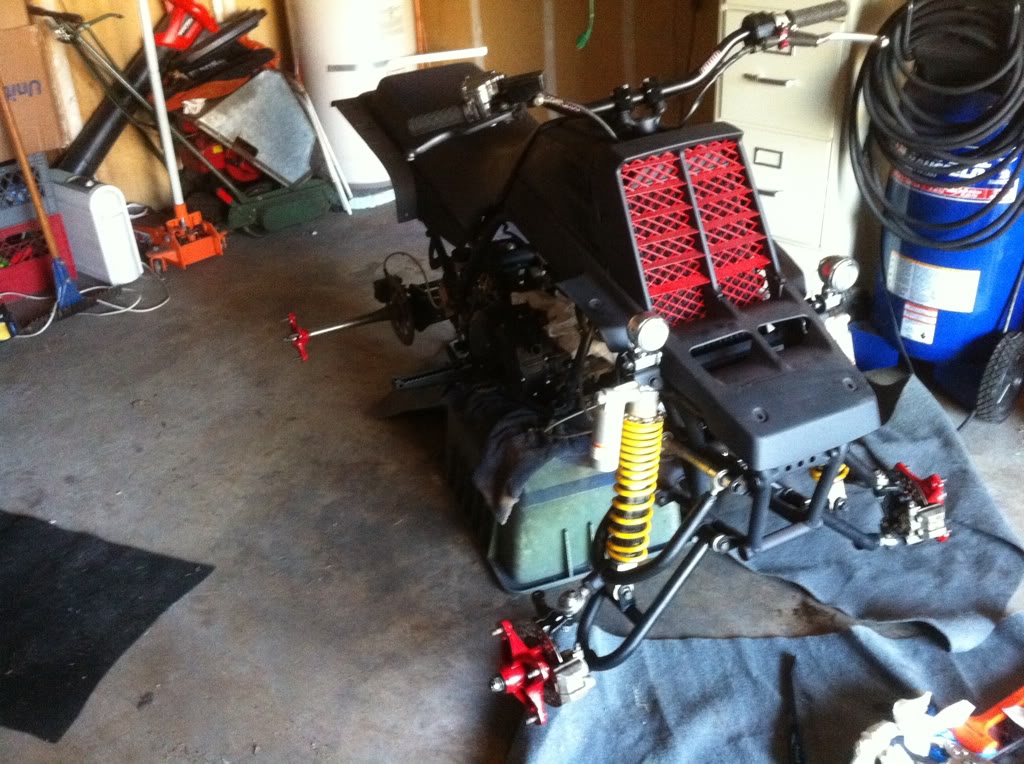

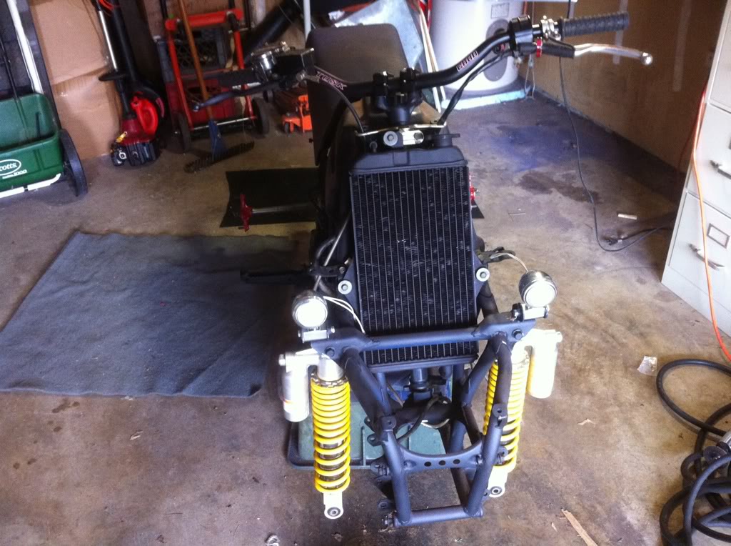

I made more progress today !!!! The shee is coming together pretty quick .
One day I'll be able to do a proper powder coat job and add some trick billet stuff , but I'm just glad I have a bike to ride .

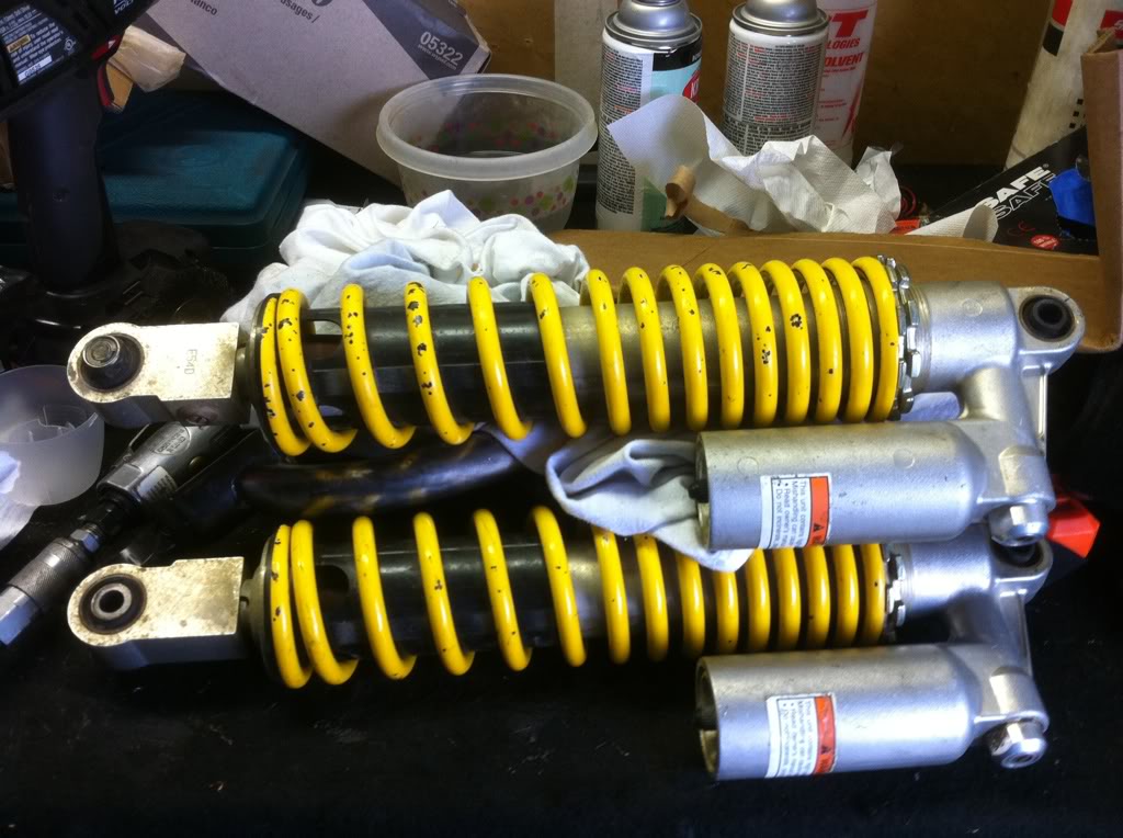

I got the + 4 swinger , axle , dog bone , and rear shock installed , installed my +4 brake line and got the brake filled and bled . My YFZ 450 shocks came , I had to clearance the upper mounts about 3/16" by using my air grinder . Next up is finish painting my lower a arms and install them and it's back to a roller !
Well here's some more progress , my asr tie rod ends are on their way and once they are here it will officially be a rolling chassis again just waiting for a top end!!!!
