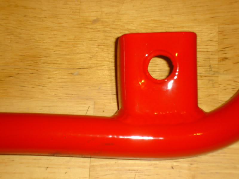

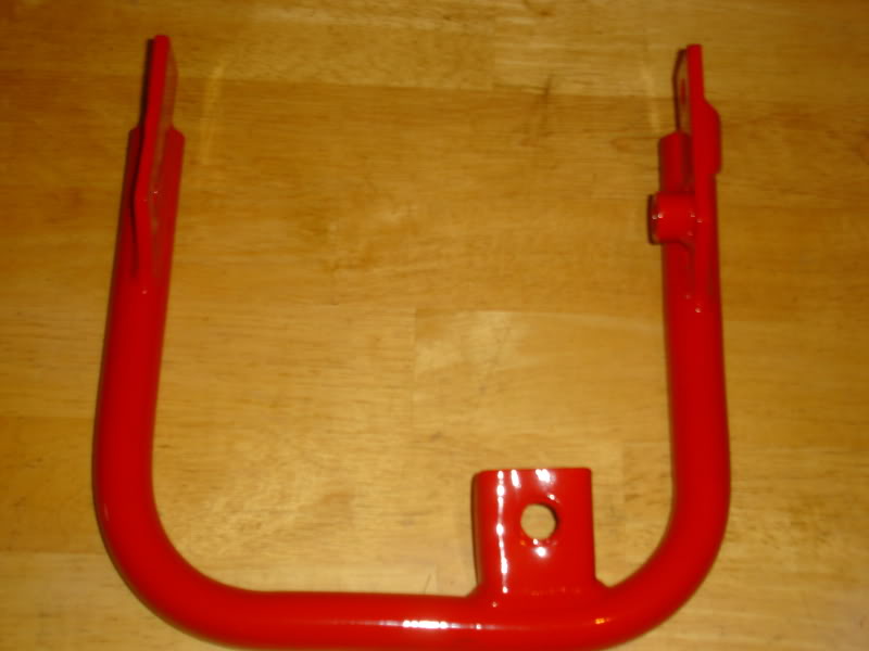

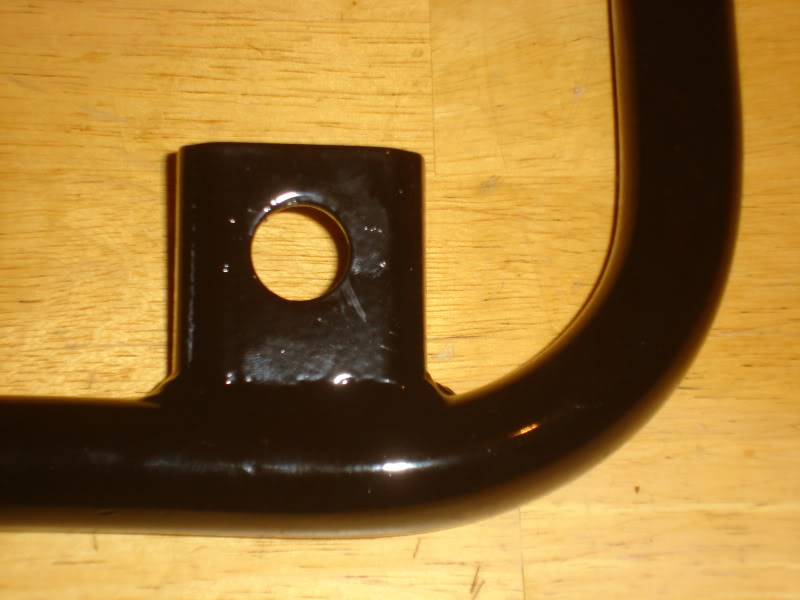

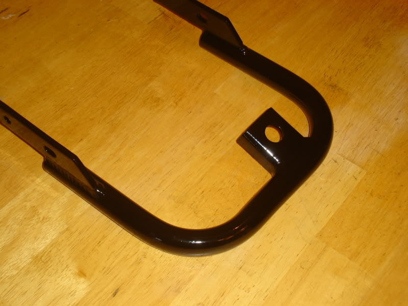

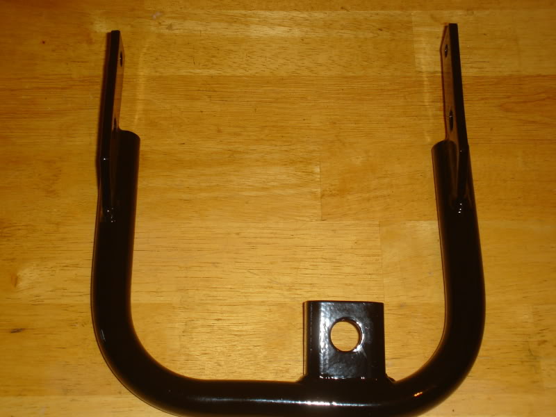

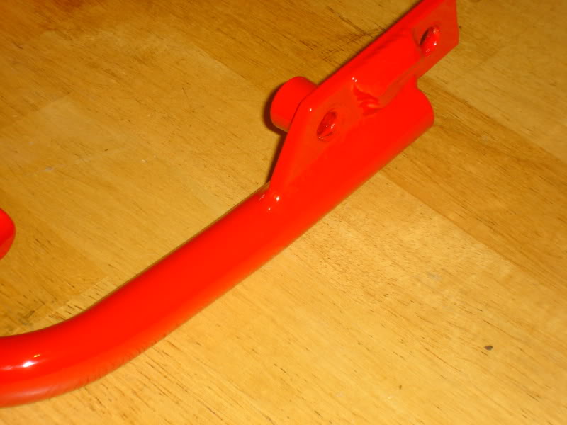

Did a Set of scoops and 2 grab bars today. You guys have seen a million pics of the scoops so, I just took pics of the 2 grab bars. The red one is a banshee one that d.jack12 modded to fit a blaster and the other one is blaster one.
More PC work to be done tomorrow!
Enjoy the pics!

I don't know it looks good but when I look at it all I can think is it looks spraypainted...

Spray paint hun? That hurts!!!

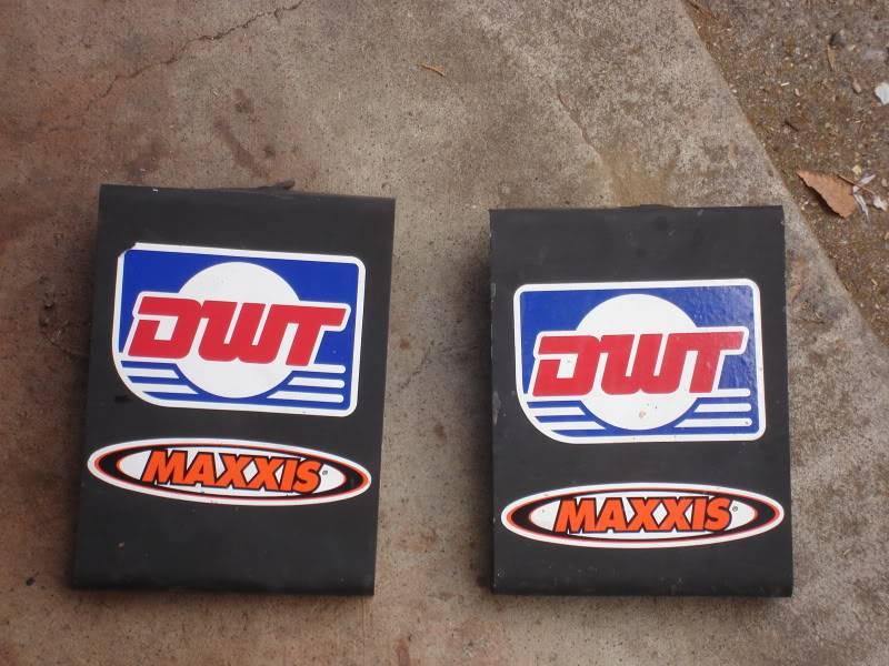

First are the air scoops. They were the second set of scoops ever that David and I made so, they were spray painted. The first pic shows what they looked like when I pulled them off the bike to prep.

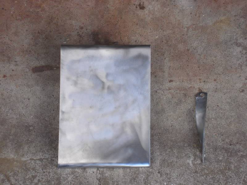

Next, is the scoop after I hit it with air craft stripper and the wire wheel.

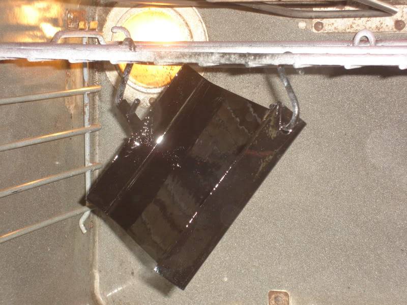

One of the scoops baking in the oven

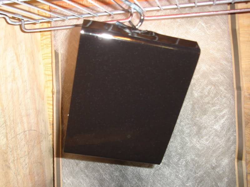

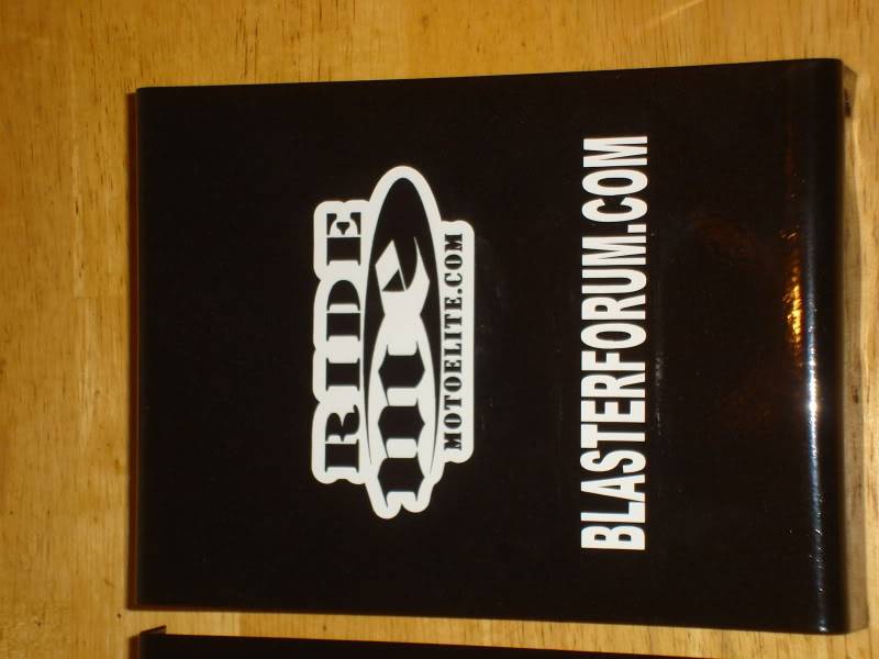

One of the scoops right out of the oven cooling in the spray booth.

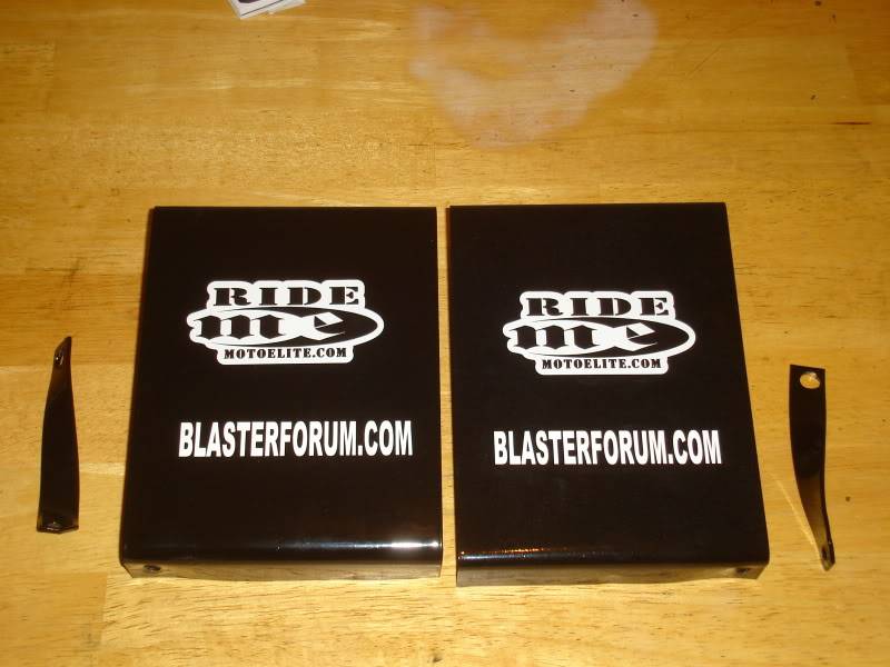

And, finally, The scoops finished with the only two stickers that are going to be on my quad!

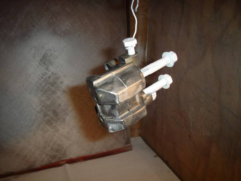

Next, are the 03-up calipers that David did. First a pic of them all prepped up and hanging ready to be sprayed.
