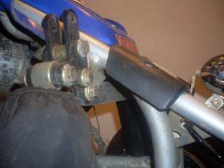

Never the less, DO NOT USE the tie rod extencion, those are crap i bented mine after 50 miles, and yes its dangerous. Just buy a new extended tie rod set.

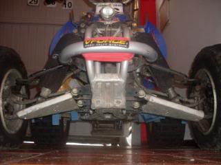

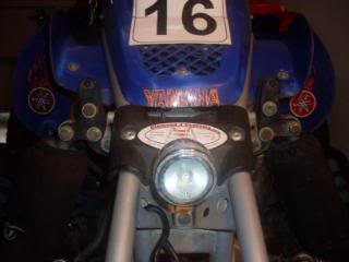

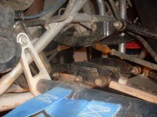

Gona try and setup some pics from my kit.

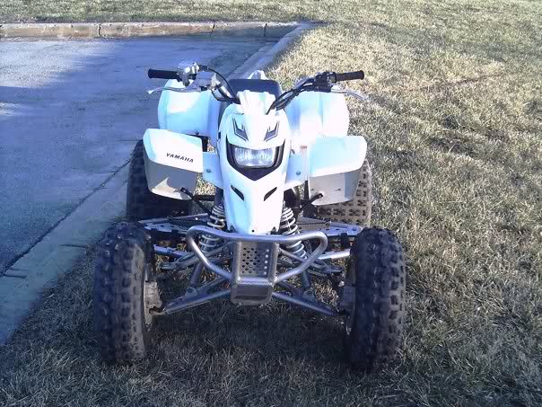

How about just a set of Douglas 10x6 with a 2.0 + 4.0 offset. Not only does it make it wider you also get a nice set of wheels too. Here is a pic of my wifes with 2.0 + 4.0 offset wheels with no other front end mods.

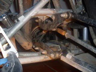

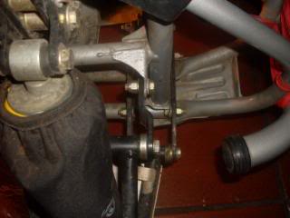

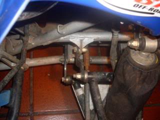

here you go BaggedMazda, hope it helps, still think its easyer to try and get a kit on auction at ebay.
About the rusty tie rod extencion, the ones that came with the D.J kit bented, so i hade to fab this ones cause the new ones still havent arrived, bought them last friday and takes about one month to get to the Azores.

so basically they bend in to put it back inline to where the the stock mount is well if i can measure it up we have a nice press break at work i can get a bend in it that way.
is it only the top with the bend in it? the bottom one looks just flat. maybe i will attempt some a-arms this winter i can make a jig that slides the desired amount so everything stays where it should while extending how far i want them
