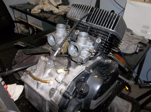

I was building a nice Blaster 67.50/Keihin 36mm/super ported cylinder/FMF pipe, some other goodies. I decided the blaster motor had to go, in the process of selling that, PM me if you know of anyone looking for a brand new rebuilt/fresh motor.
The motor is a 1974 Yamaha RD250. Although these motors are old and air cooled, they aren't outdated by any means. These were rated at 30WHP at 7500rpm, so it should be pretty rad on a blaster. So far, the plans are to ride the bike with the stock 250cc cylinders with my custom out of frame pipes. Eventually, going to get the RD400 cylinders, port them and I have 28.70mm Mikuni Round Slide carbs, gonna jet them and dial the bike in. Should be in excess of 50WHP at that point.

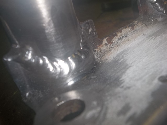

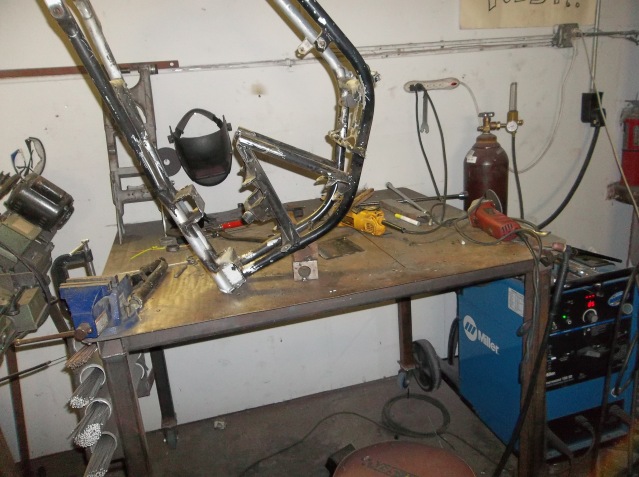

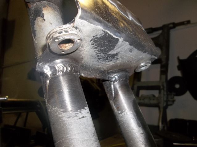

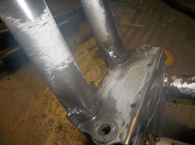

Time to get down to business, I had the blaster all disassembled and ready to get powdercoated. The motor fits surprisingly good on the frame, better than I thought.
I know that the bike isn't designed for this amount of power or this heavy of an engine, so I am thoroughly bracing the frame. If you have a spare frame and want to have this done, we provide a service, we sandblast your entire frame, grind down the sh*tty factory mig welds. We then TIG over the factory welds, add gussets and supports. We can also powdercoat the whole frame any color you'd like. PM me if interested.
