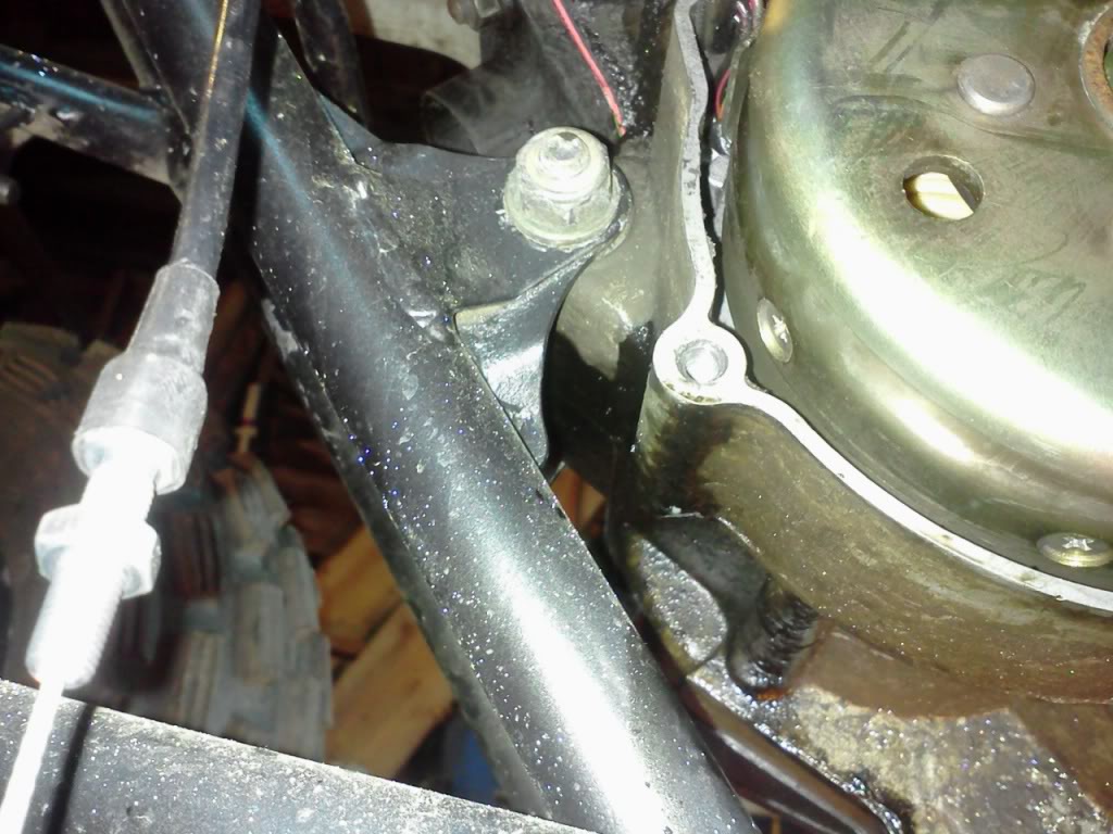

Can you identify what type of oil is leaking.
It just maybe that the gearbox is leaking and oil is finding its way to where it is accumulating.
Believe it or not the taste test works.

Ok, so, I should've look a little further. :-[ Apparently I need a new donut gasket on my exhaust, or I am so rich right now I'm blowing a ton of fuel thru.
I can't see for sure if it is coming out from behind the exhaust flange or if it is just blow back from the pipe. I will check for that tomorrow. But all that black you see is on the cases is wet and running down to the fly wheel cover and collecting on it.
So ya found the problem, sweet! Get that flange off, clean it, then put some Red RVT on that and slap it back on!

LOL, it kinda looks like that already...alas it is not though. I had to chop up an old TMNT Basketball to create my exhaust flange block/sealer for my leak down.
Anyhow, will the RTV stand up to that amount of heat??? I will have to check my packaging and see what the specs say. Also, wouldn't it be wiser to get a new donut gasket under it?
So it wasn't the crank seal?8-|
Nope, it was the result of a lazy rider, with clean clothes on and thinking about other things. I looked into the fly wheel area and it was dry up inside, the oil was only on the surface of the case where the cover seals. So then I started looking a little more and a little more...then got some cardboard and look underneath...that's when I saw the trail of black liquid coming down the cases seam, to the bolt location and running out toward the cover.
