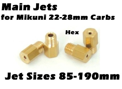

The main jets have the number stamped right on the end by the hole. Sometimes on the side.
Pull off your float bowl and you will be able to see the number.
The jets look like this...

Mine has a 310 in it right now. I am trying to adjust the floats according to Awks thread but is there anyway to tell what carb I got? I measured the opening on the carb that goes into motor and the inside diameter is 28. Is that how you tell what for carb you got?
That's a Mikuni VM26...a stock carb that came standard on the Yamaha blaster!
A great carb! Easy to tune!
