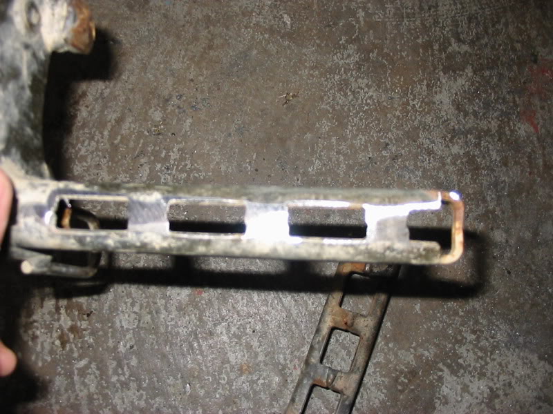

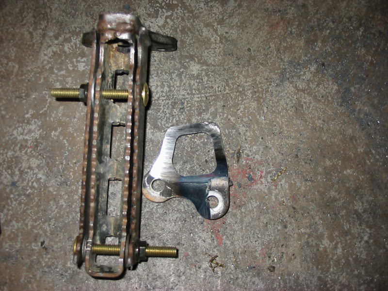

Decided since I found a super deal on these rappy250 pegs, 10 bucks, I figured I'd be different than just double pegs! I also wanted to keep the holes for mounting the heel guards the same as the stockers, well turns out the holes line up perfectly, should of figured this since alot of guys have put 450/rappy heel gaurds on.

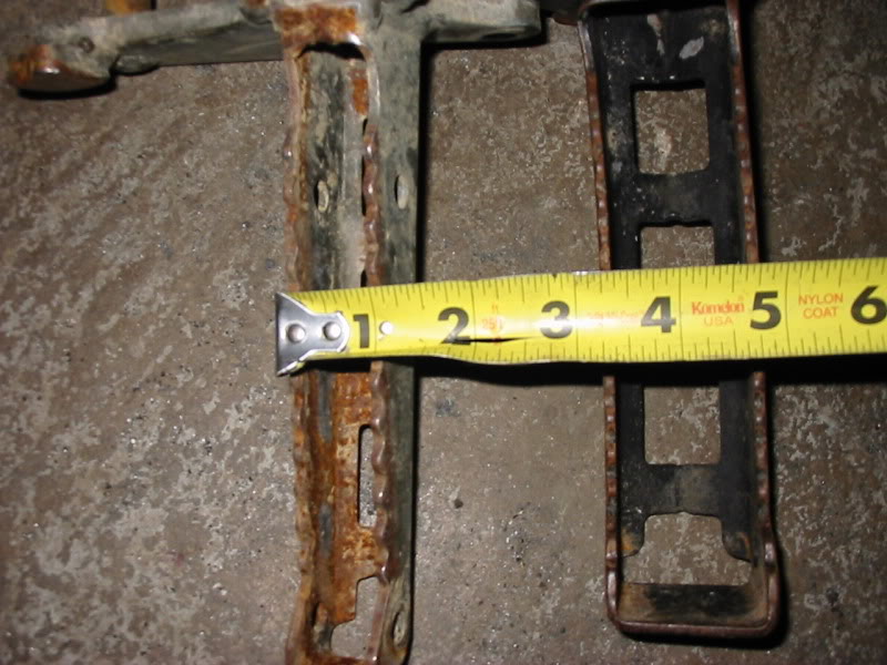

Easy to do and the rappy ones are almost twice as wide as the little 1" stockers!

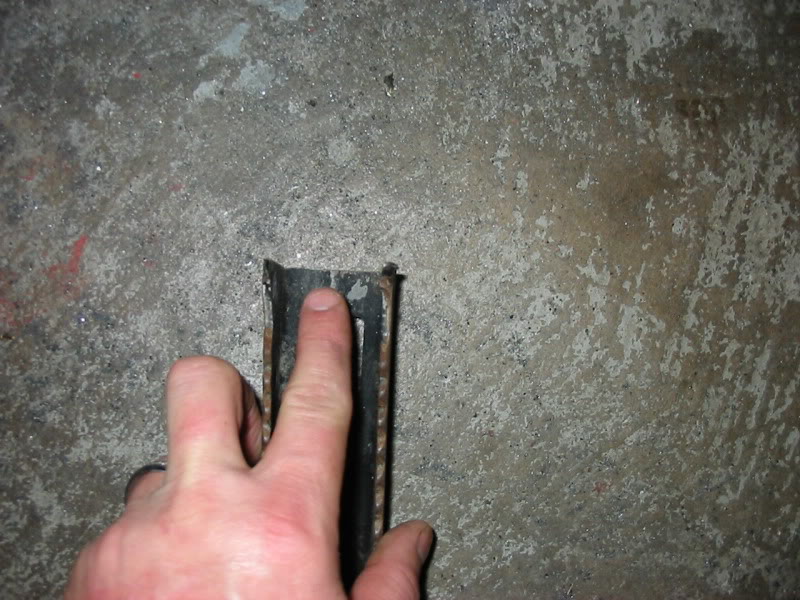

First cut off the rappy pegs at the mount-
Then remove the front piece that is higher than the pegs ( i call it a foot keeper)-

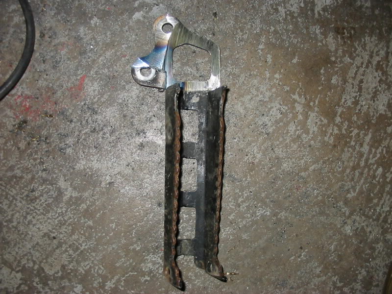

Then the back top piece that was welded on the rappy mount or the peg wont slide over the stocker.

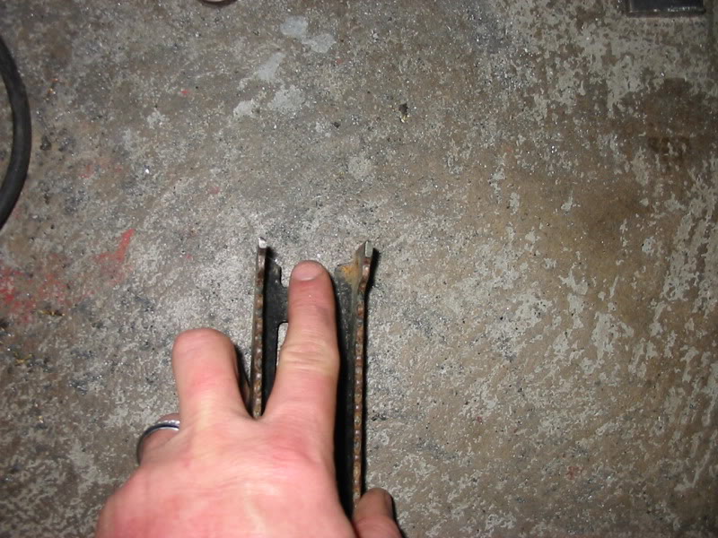

Now ya have to grind the welds down on the middle of the stock pegs som the holes line up!
Line the holes up- center the stock peg buy using washers and bsnug it up for welding!

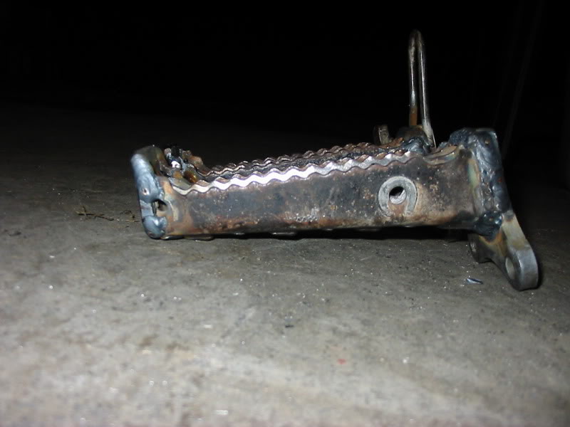

Weld it up and bam ya have some double wide peg mounts that use the stock heel guard bolt location! Pics of weld to follow after dinner!!
Welded up and worked out awesome!
Side shot-
Looking good brotha. Gussets are a must if you are already torn down. Nice job. The welds look alot better than those steelers!!!!!!!!! hahahaha
