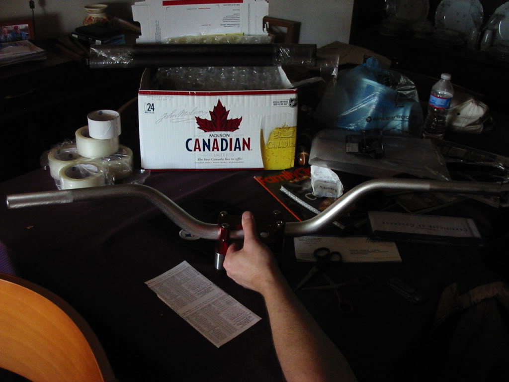

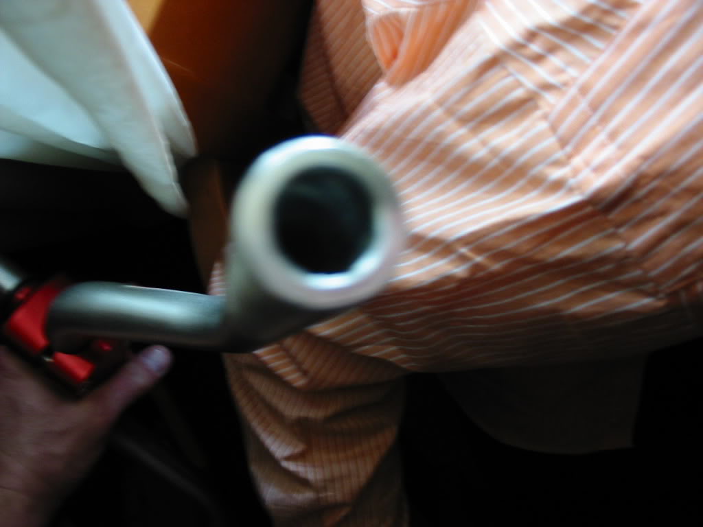

I wasn't sure how I was gonna like a fat bar. These things are awesome gonna really set the stem up great!
Super thick and rifled insides!
Mounted!
