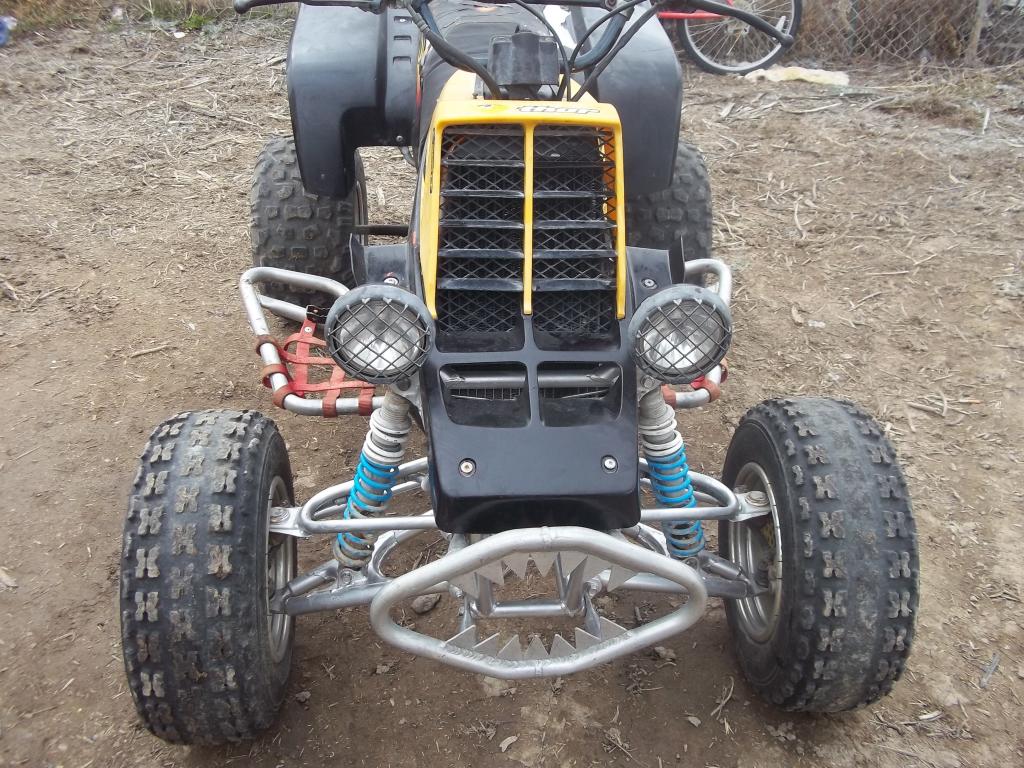

Wifesblaster Built not bought Feb 10, 2012 3,513 111 105 45 Maryland Mar 2, 2014 #123 Well I run a craptor 660 rear shock. It has to be the one with a remote rezzie though. Put the works on the front and leave the rear alone for now. Traction is always an issue with banshees on dirt. Make the rear shock as soft as you can without bottoming out and get some good tires.

harley1-5 Active Member Jul 28, 2013 3,465 236 115 Elko County Nevada Mar 9, 2014 #133 well update time got my works dual rate fronts installed.
harley1-5 Active Member Jul 28, 2013 3,465 236 115 Elko County Nevada Mar 9, 2014 #134 supposed to be bartering my labor for some tires
Blaaster Moderator Staff member Technician Jul 18, 2011 15,384 1,120 165 eastern australia Mar 10, 2014 #135 Them front rubbers have been run with way too much puff in them!
harley1-5 Active Member Jul 28, 2013 3,465 236 115 Elko County Nevada Mar 10, 2014 #136 yes they have,hope to have new 1s soon
harley1-5 Active Member Jul 28, 2013 3,465 236 115 Elko County Nevada Mar 10, 2014 #138 thanks guys just waiting for my throttle cable im to grip it and rip it.The rear shock on the other blasty [works rexie] turned out to be a shee shock,was same length
