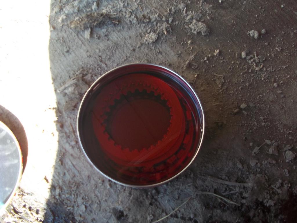

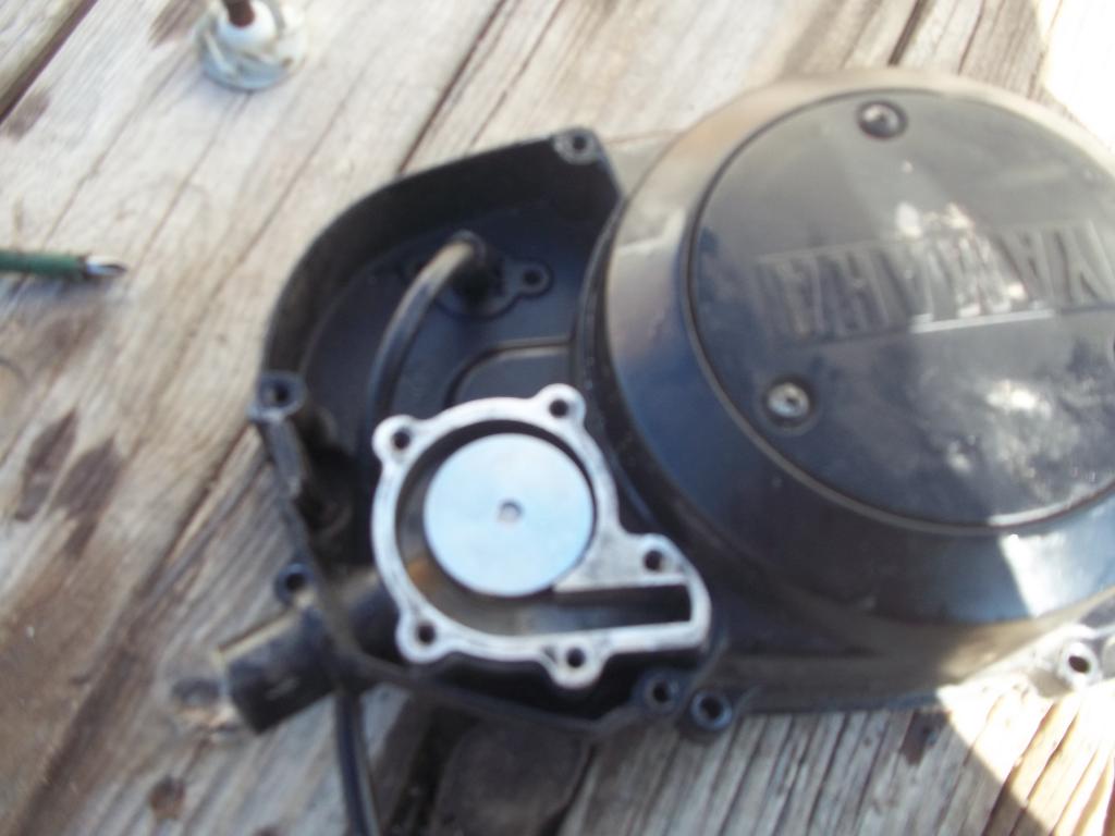

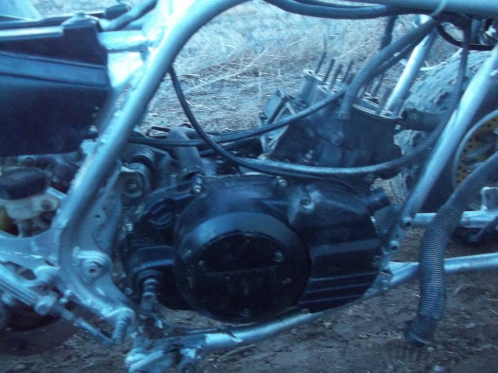

put the cover on,.fill full of fluid. run it and it should run correctly. is the clutch perch adjusted correctly? how much slack in the cable?got new clutches in [soaked for about 4-5 hrs in type f].Torqued to proper spec.Internal adjustment correct[arrows line up]Cable adjusted.I put it in gear and pull in clutch and it doesn't disengage.side cover is not back on yet.Will it make a difference if cover is on and full of fluid?
