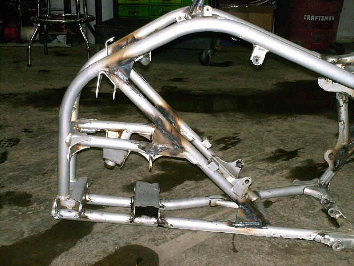

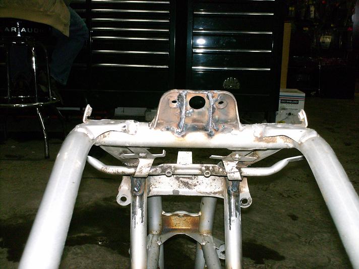

Well here are the pics of the gussets I made all welded in. I made them all from 1/8" plate steel. More than enough for the Blaster frame. Took me about 4hrs in all, and no dollars. Had the steel sitting around the shop. Yesterday the snow kept the customers away so we did it all on company time. Anyway here are the pics.

Beefed steering stem mount!
blaster2
A better shot of the side of the front gussets.
blaster3
12 pieces all together!

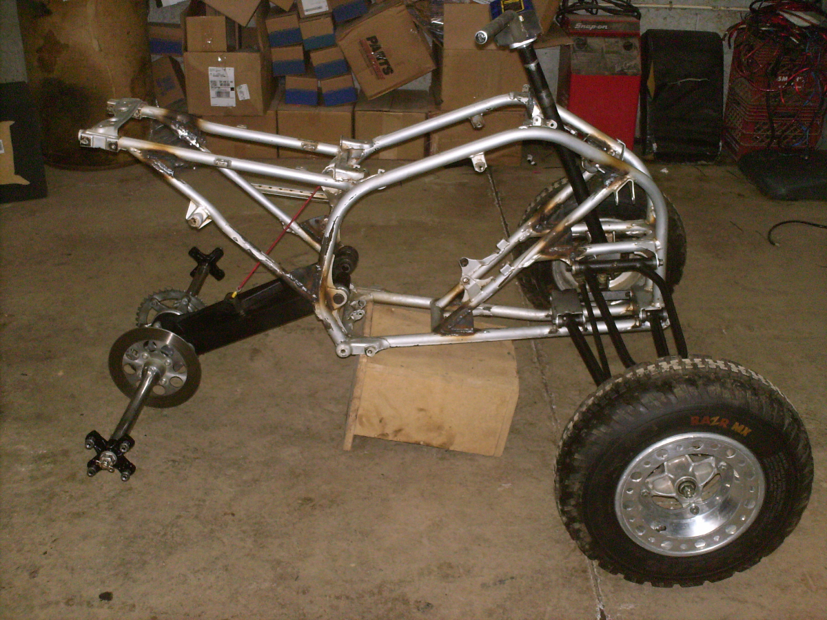

I picked up some goodies. I threw some of them on for a mock up.

Just a side shot of the progress
blaster5
