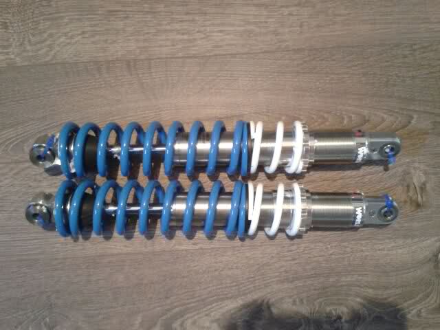

its like christmas is May. finally got my new shocks. put them on and tried to go for a ride but the wheeler was actin up. found out the head gasket is leaking so gotta fix that first. but from what i can tell from bouncin in and out of some ditches there amazing! bumps that usually jolt me were barely noticable!
and there threaded preload compared to my old ones on my banshee with the clip. also these are made for my weight so they feel great. top notch work

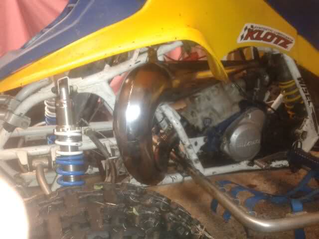

just snagged a fmf header for free. my buddy got it with his new lt250r as a spare. i helped him work on it cuz its a bit dicked, so he said i could just take it. it was rusted to f**ck but i used a wire brush on a grinder and some rubbing polish and threw it on. bumped the main jet up a size and its running really well. took it out on wet pavement and it definitely quicker, spun the tires like crazy though, cant wait to try it when it dries up.
my dg pipe was essentialy the same as stock, and like a "left bend" pipe for a blaster. this fmf resembles a right bend pipe for a blaster.

Nice let man those works were a great investment I got a set off one of dads buddy's banshee with rezzis and its amazing
