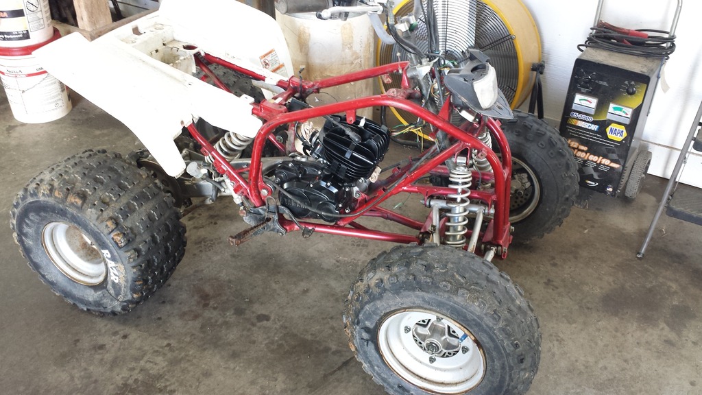

Sorry guys, I got too excited and didn't take any pics of the process but took a pic of how it sits now.
Got my motor back from Ken. Porting looks beautiful. I only had time to clean the frame a bit and slap the reeds and manifold on the motor. I threw on all the electrical stuff I had to sort threw the wires a bit. Looks like previous owner already did the tors delete. Then I mounted the motor. Looks like previous owner messed up the beginning threads on the swing arm bolt. But looking good so far.
Reactions: OConnor Racing
The wiring does look messy but that is just temporary till I find if I'm still getting spark after the harness swap before I put the final touches on the harness. Hopefully in the next few days I'll find time to put my carb, air box, and pipe on so I can do some heat cycles.
I didn't tell my dad the surprises I have in the motor so he still thinks his lightly built blaster will beat me. Boy will he be in for a surprise. He keeps talking trash but I'll show him soon.
Reactions: jus_me and Awk08
