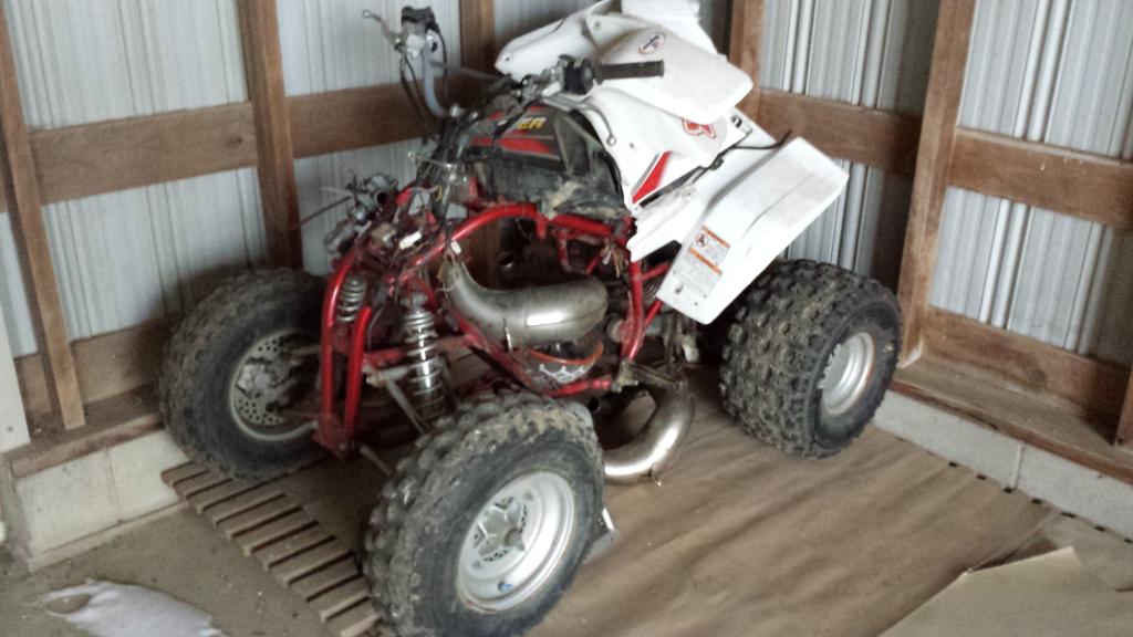

Here is how I bought my blasters. This one had the motor still on it because of a failed attempt to rebuild it, I had to take it out and do a full rebuild. Thought I'd post a pic while Ken is building my motor. I still need to swap the wiring harness over to the original 5 wire harness. They had the 99 blaster harness on it because the we're using the 99 blasters bottom end. The 04 bottom end is what I'll be running on it. It's also just got all the parts from both blaster stored with it because I'll be using the best of both blasters and putting it on the 04 frame shown.
