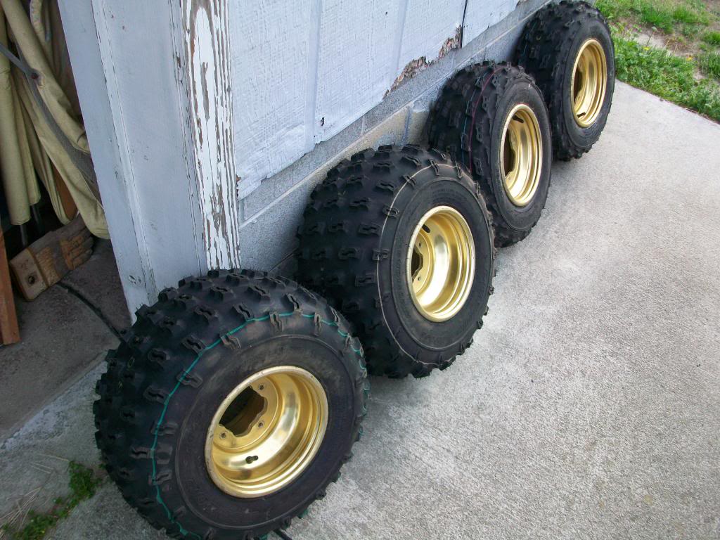

thanks for the suggestions braap. i plan to run the tires that are on it until i can find some cheap warrior/banshee hubs. probably use them for a backup set.

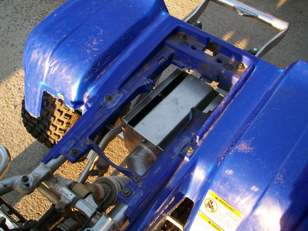

gotta a little more done. figured out a temp mount for the airbox, cut the plastics for the cfm.

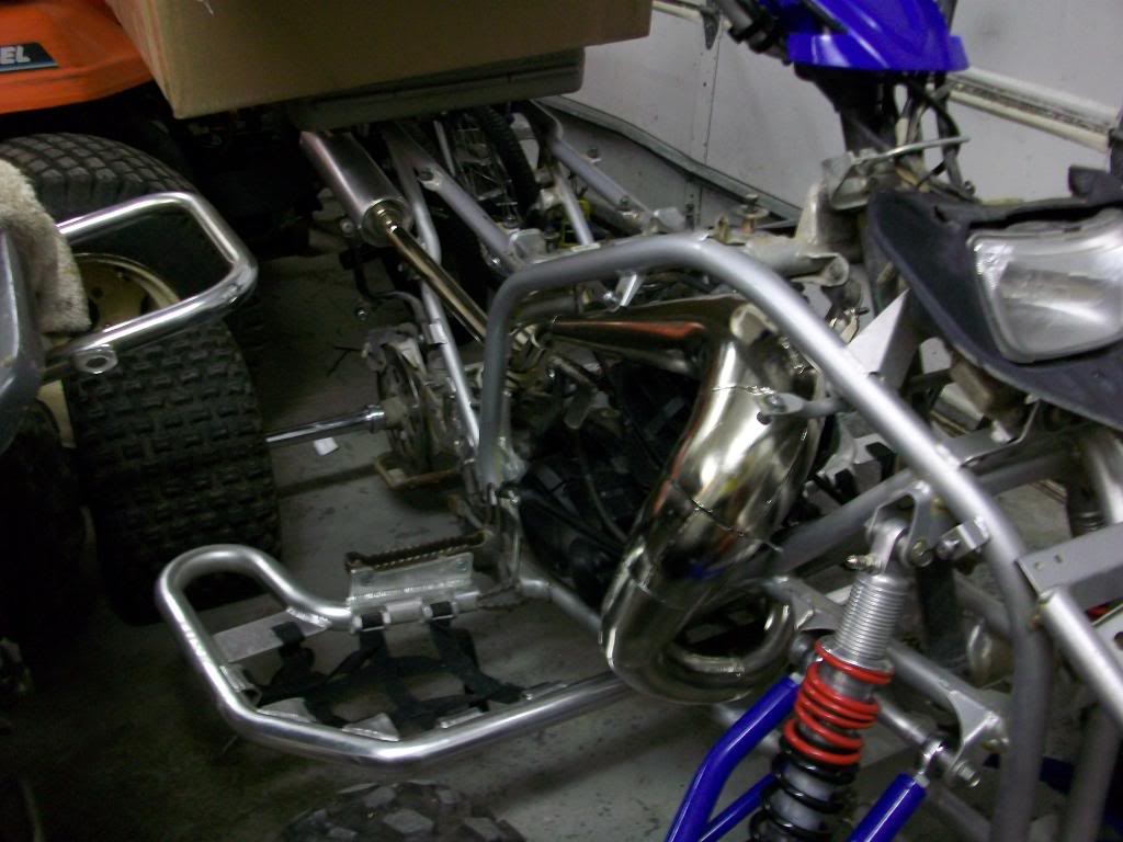

help me get this mofo one step closer to breathing. that's my new trinity exhaust. same thing as ct, f7, power pros, etc.

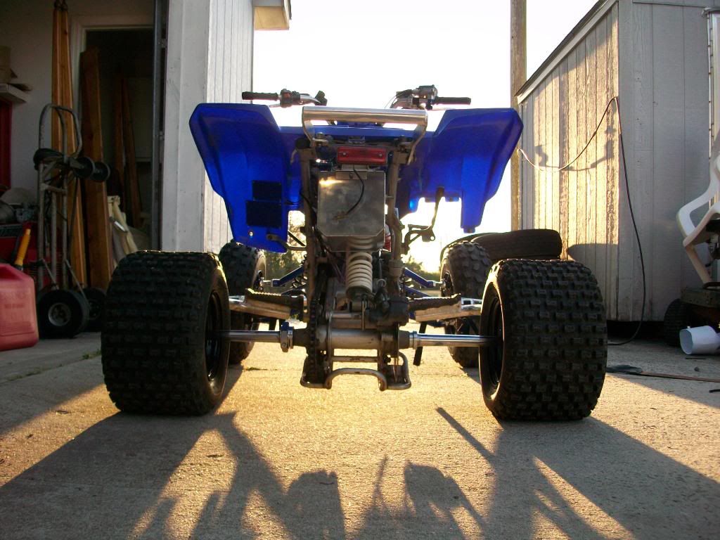

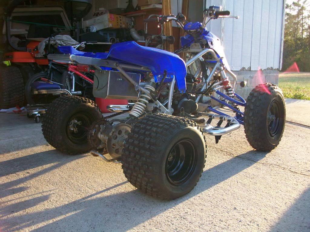

here are my new RMATV special dunlops mounted on my warrior wheels. still looking high and low for a set of hubs so they'll fit.

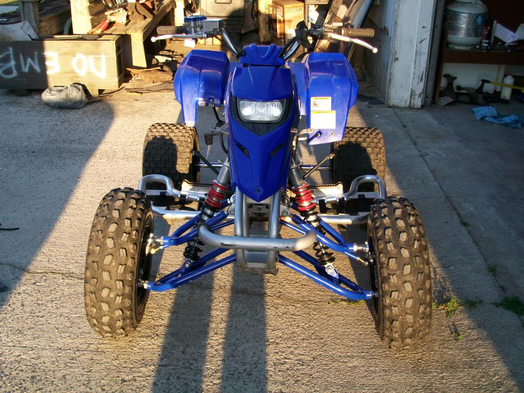

Wow man, what a transformation! And what a steal for $400! Looking really good!
