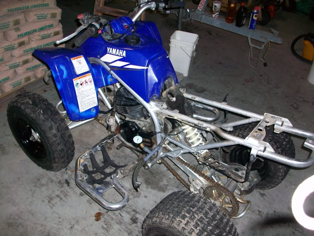

so, i ran the compression test this morning and it only managed 30 psi. i kicked and kicked until the gauge stopped moving. should i wait for the leak down tester to arrive before i tear the topend apart?
Re: My '03 Project

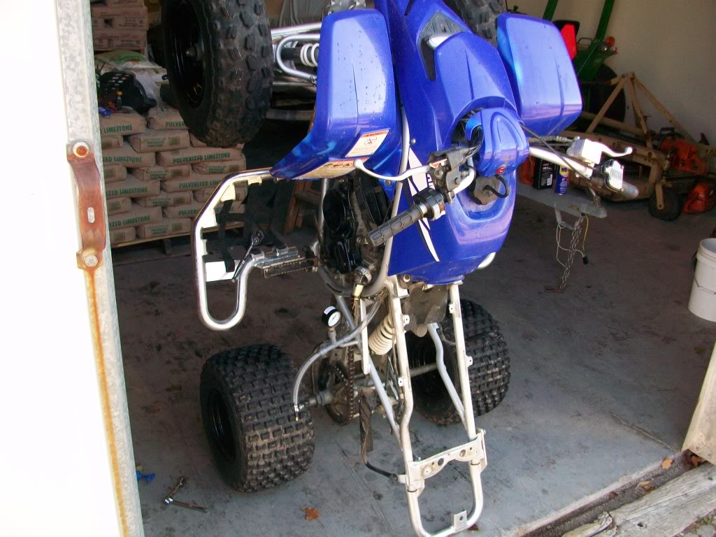

alright guys, finally had a chance to tear into this bad boy today. ran the leak down test and immediately heard air rushing from the head gasket. guess that why it only managed 30 psi on the compression test.

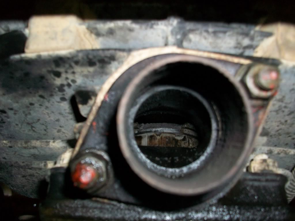

what i found is amazing to say the least. i had the thing running and idling yesterday and also raced my buddies warrior and beat him. i'll let the pics show you.
you can see that there is good size chunk of piston missing. i don't know how it ran, but like i said i beat a warrior yesterday with it just like this. with it damaged like this i guess i'll have to tear into the cases to see if anything else is hurt now. that'd be the smartest thing to do i suppose. don't want it to grenade again.

not sure man. im gonna get ken to do the port job and take it to whatever the next size is. i hope it has a little life left in it anyway.
Re: My '03 Project
wow thats a good one. and wise choice going with ken on the motor work
