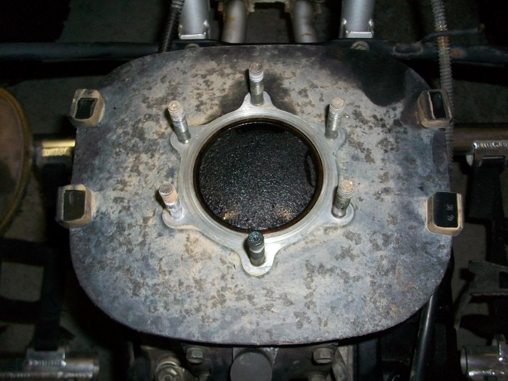

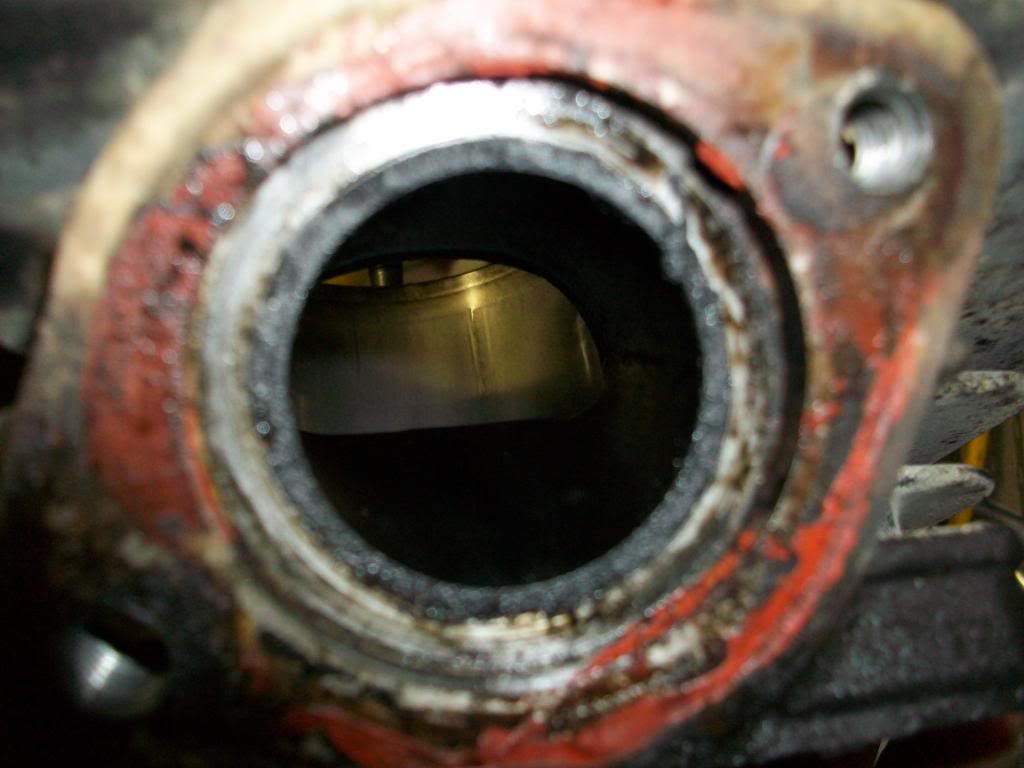

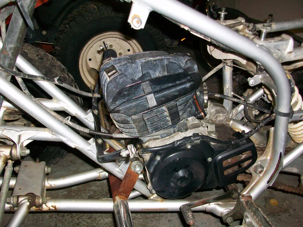

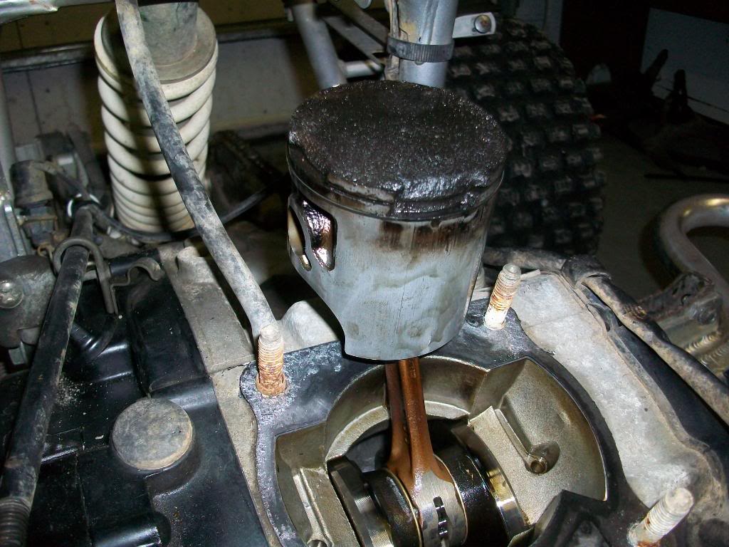

finally the long awaited (for me) rebuild has begun...

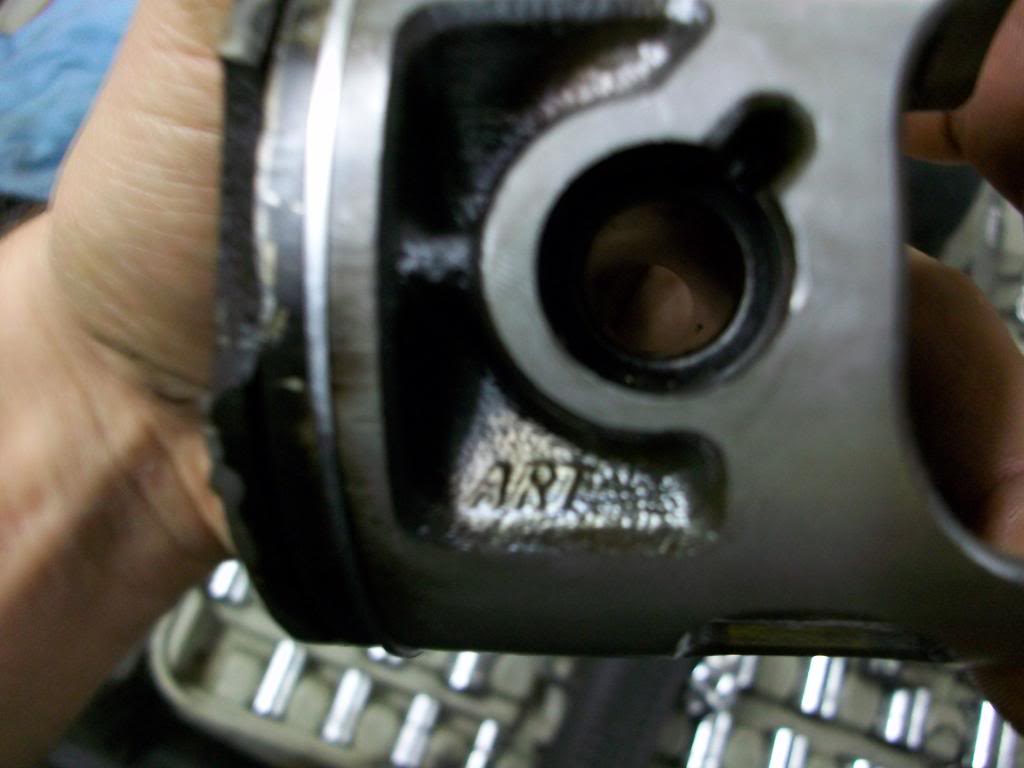

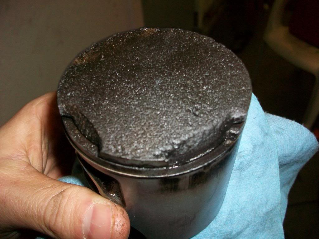

would you look at this piston! two chunks out of the ring lip and only one ring. no wonder i couldn't get any more than 30 psi haha
Re: My '03 Project

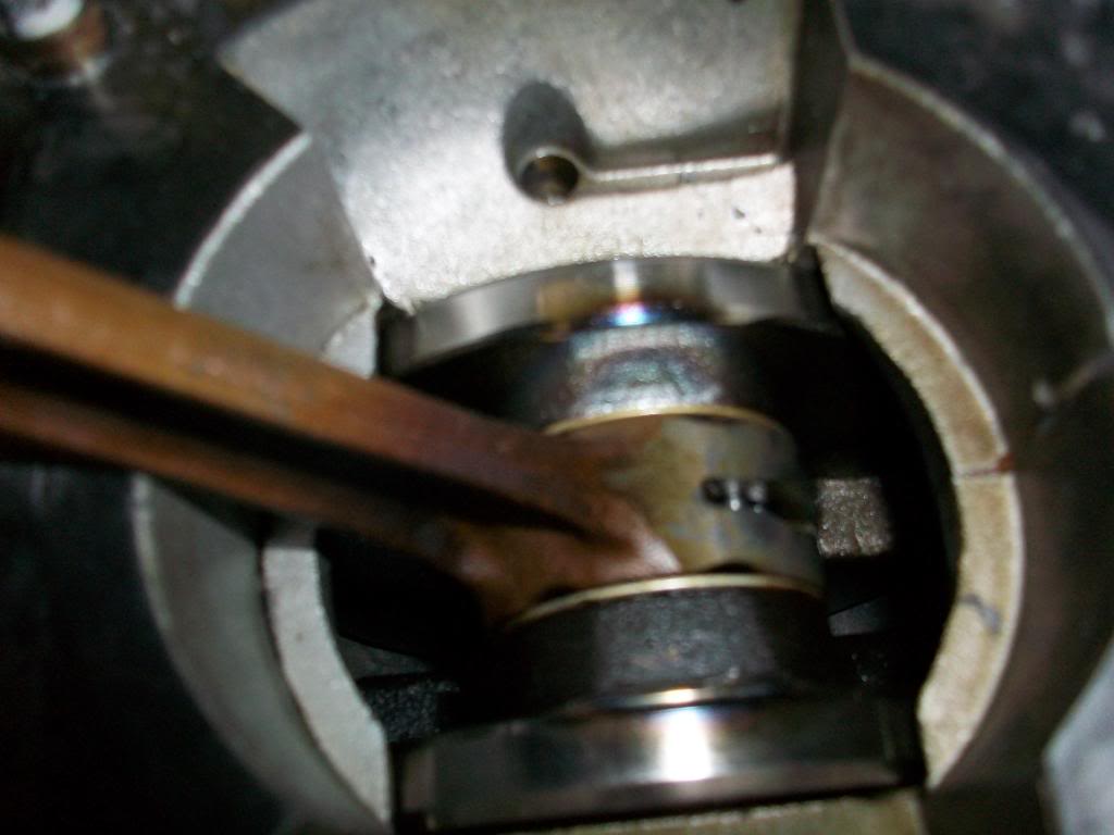

good news for me, the crank is in great shape. very little play in the big end bearing and no up and down play. everything seems solid in the bottom end (big relief).
i think this topend has been redone before. pretty sure this is not an OEM piston. has ART on it, anyone know about these?

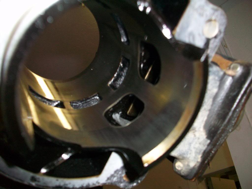

amazingly with all the damage to the piston there was no scrapes or gouges in the cylinder wall.

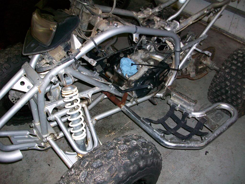

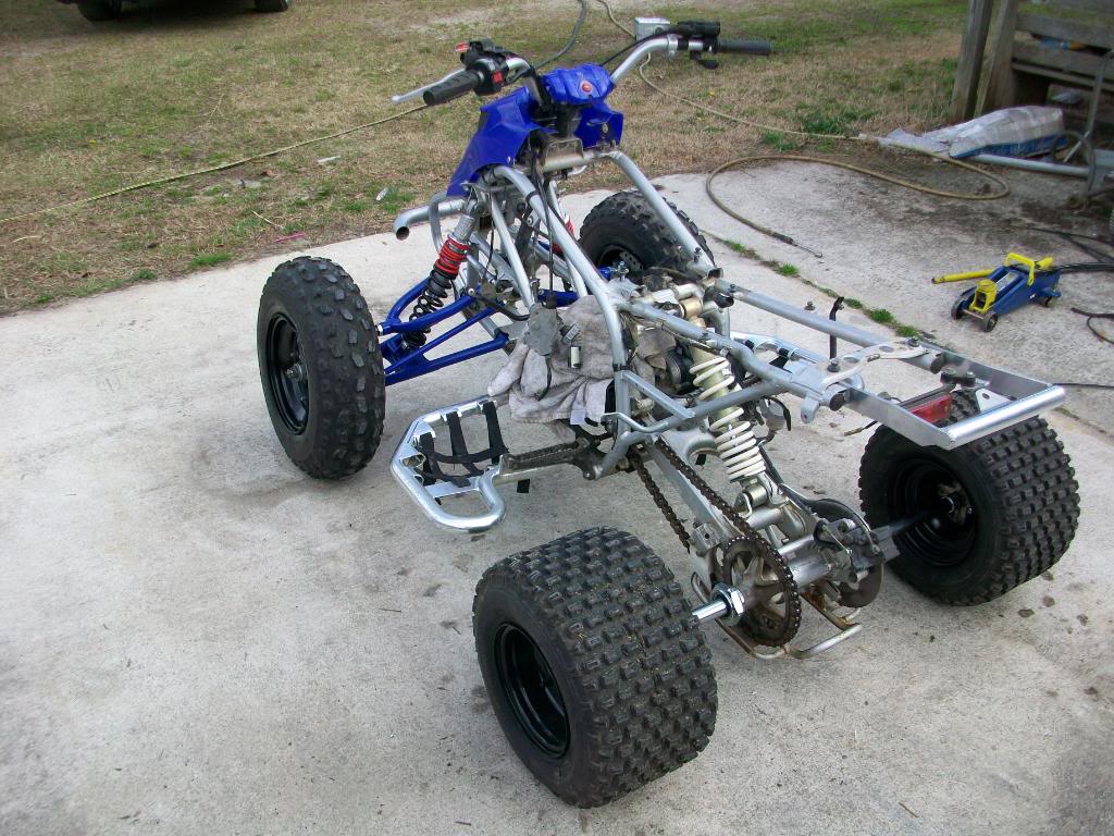

where i stopped at. gonna start back on it when i can get my topend to Ken for the porting, head mod, and bore. i plan to go with a wiseco pro lite piston and cometic gaskets.

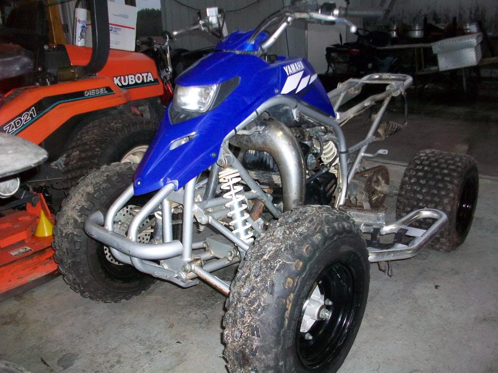

Re: My '03 Project

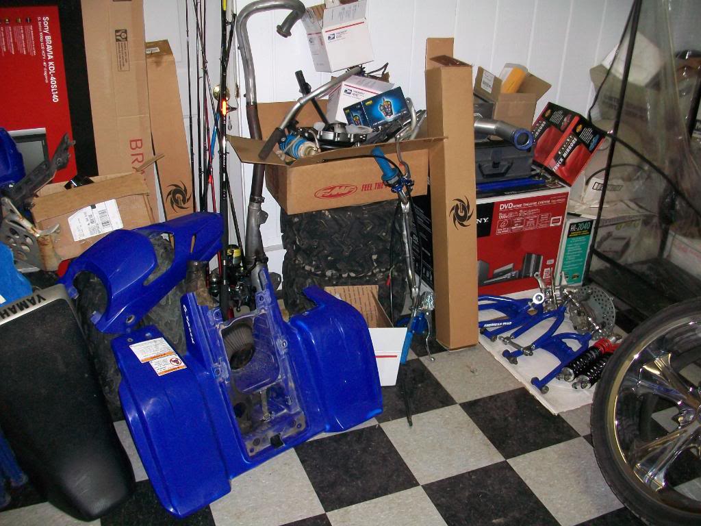

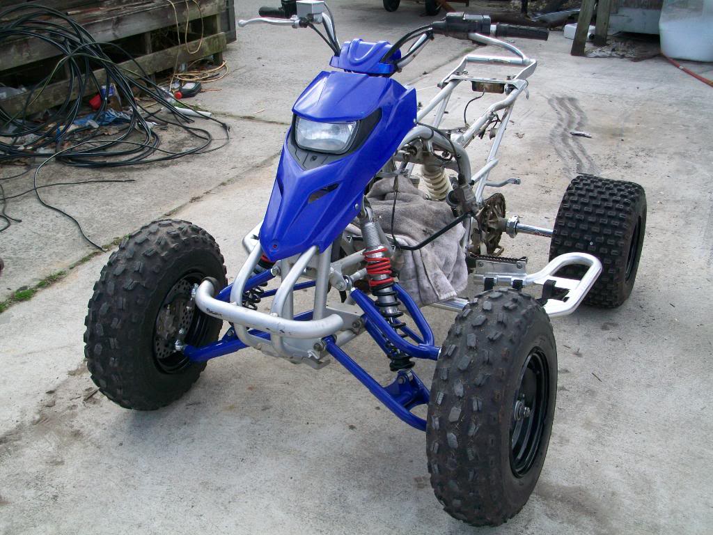

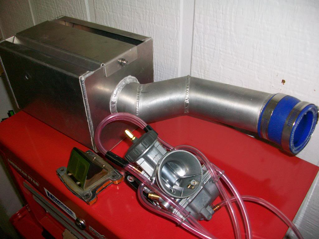

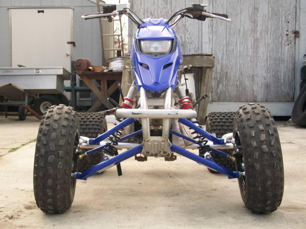

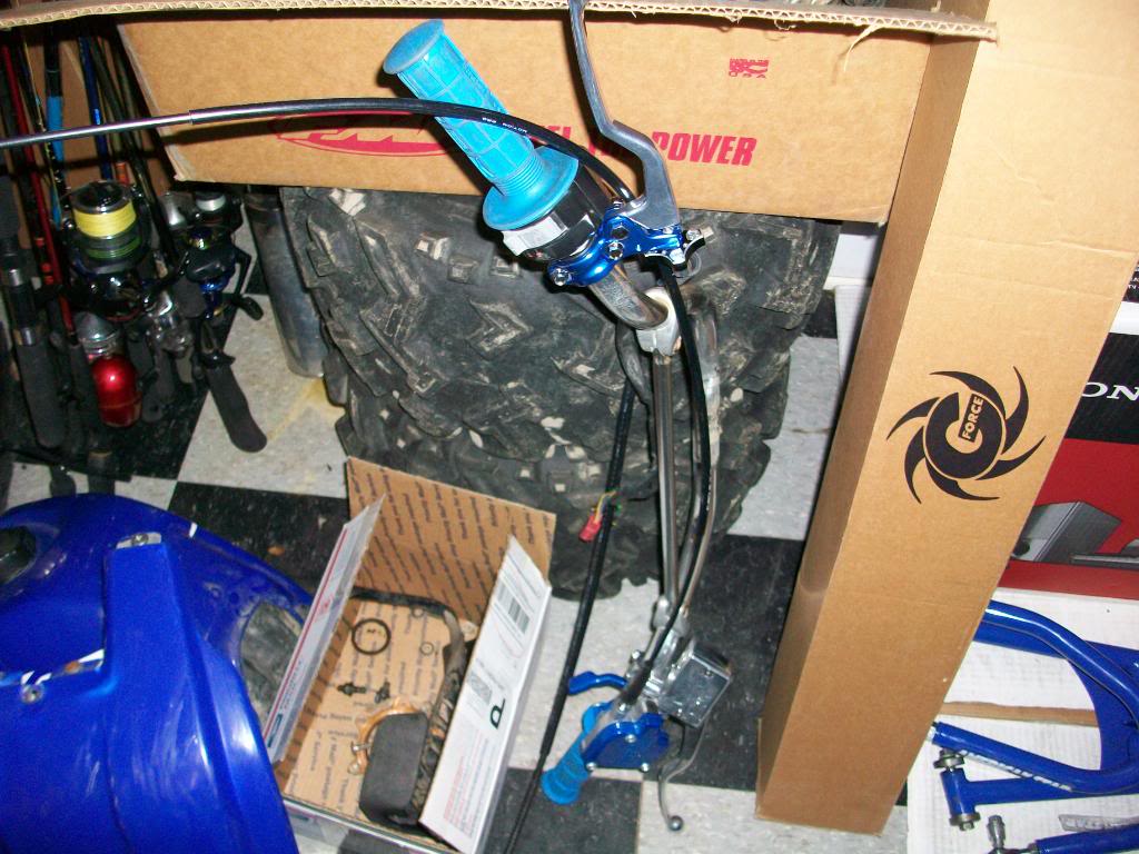

pics as promised:

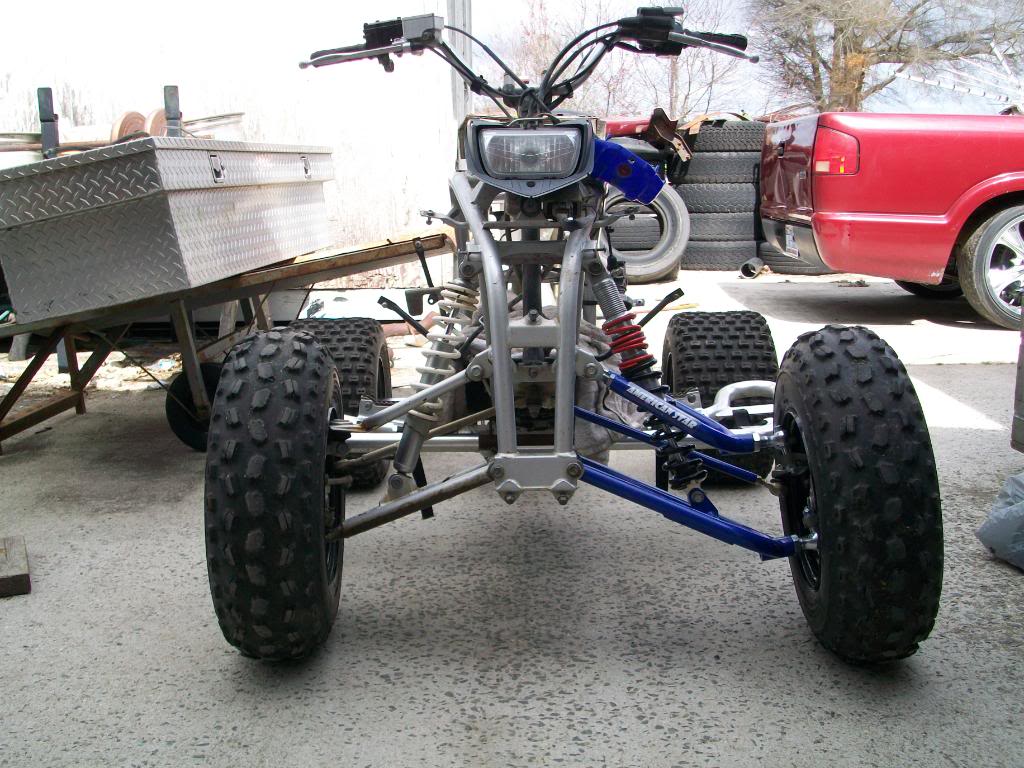

cfm airbox w/ uni air filter, 35mm kehin airstriker carb, and boyeson reeds with spacer

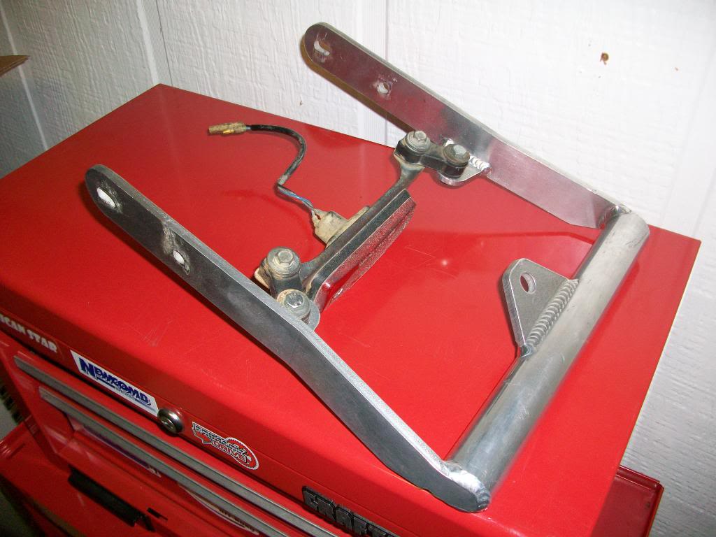

awesome grab bar

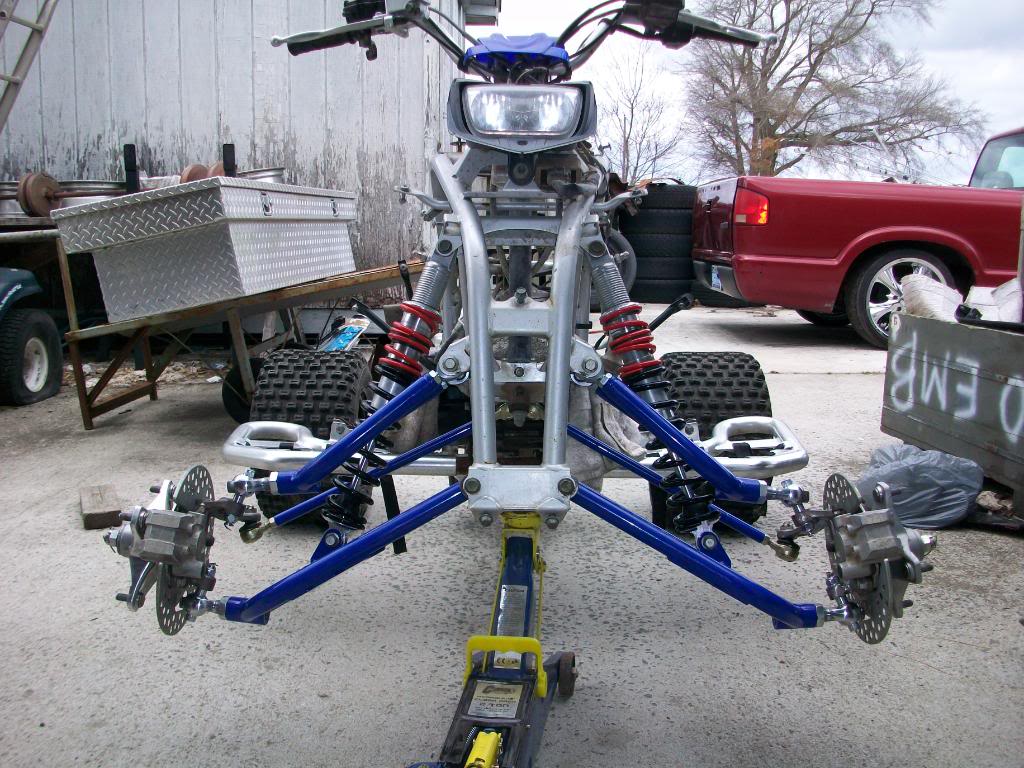

asr +3+1 long travel arms with tierods, yfz triple rate works shocks, and banshee spindles and hubs
brand new never used g-force axle
a/m clutch lever w/ cable, powdercoated throttle assembly, new brake handle rezzie (bars go to my buddy, not mine)

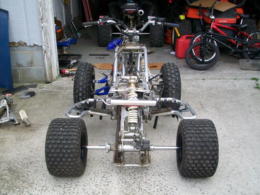

everything waiting to go back together
gonna be far from the "buy it, fix it, ride it" project it was meant to be. should keep me busy the next couple of evenings. then the topend will be here wooooo....

DAMN!!! you have some nice parts there! I would love a set of those a arms. That littly blasty is gonna be kick ass when you get all those parts on it. And Im assuming you got a deal on all that stuff right? lol
Re: My '03 Project
one hell of a deal. stuff hasn't even been used. just put on for mock up i believe. nothing is hurt at all.

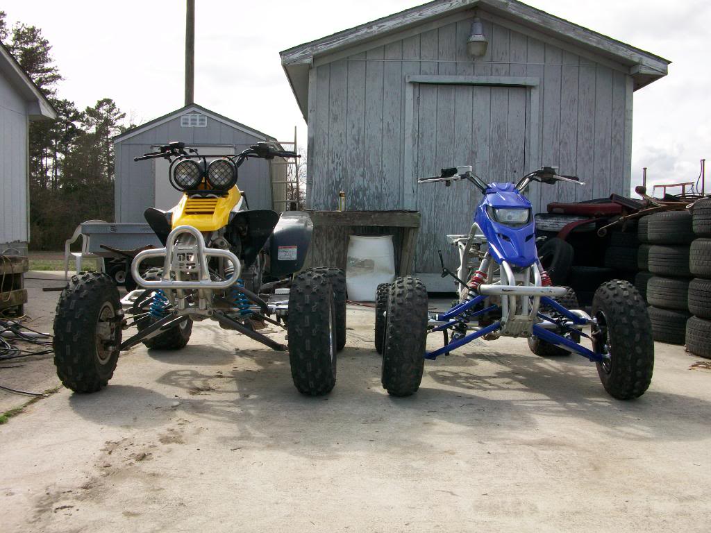

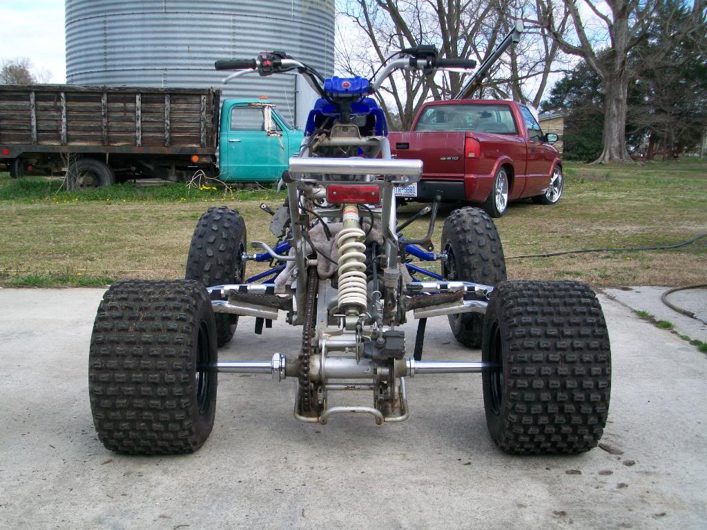

i have returned with mo pics:
still waiting for the topend lol. ready to get this thing blasting...
Re: My '03 Project
oh, yeah. i'll be getting rid of that stock rear shock too very soon. gonna be putting in some kind of honda shock (400ex,450r, or 250r). whatever i get the best deal on more than likely.

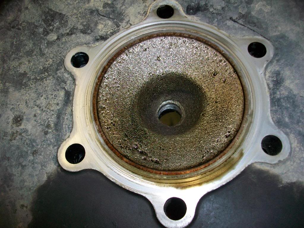

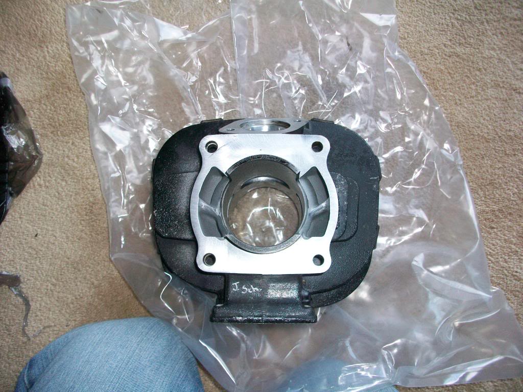

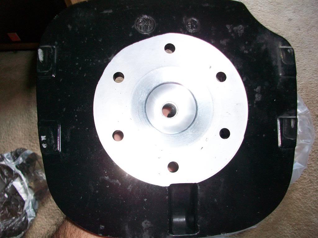

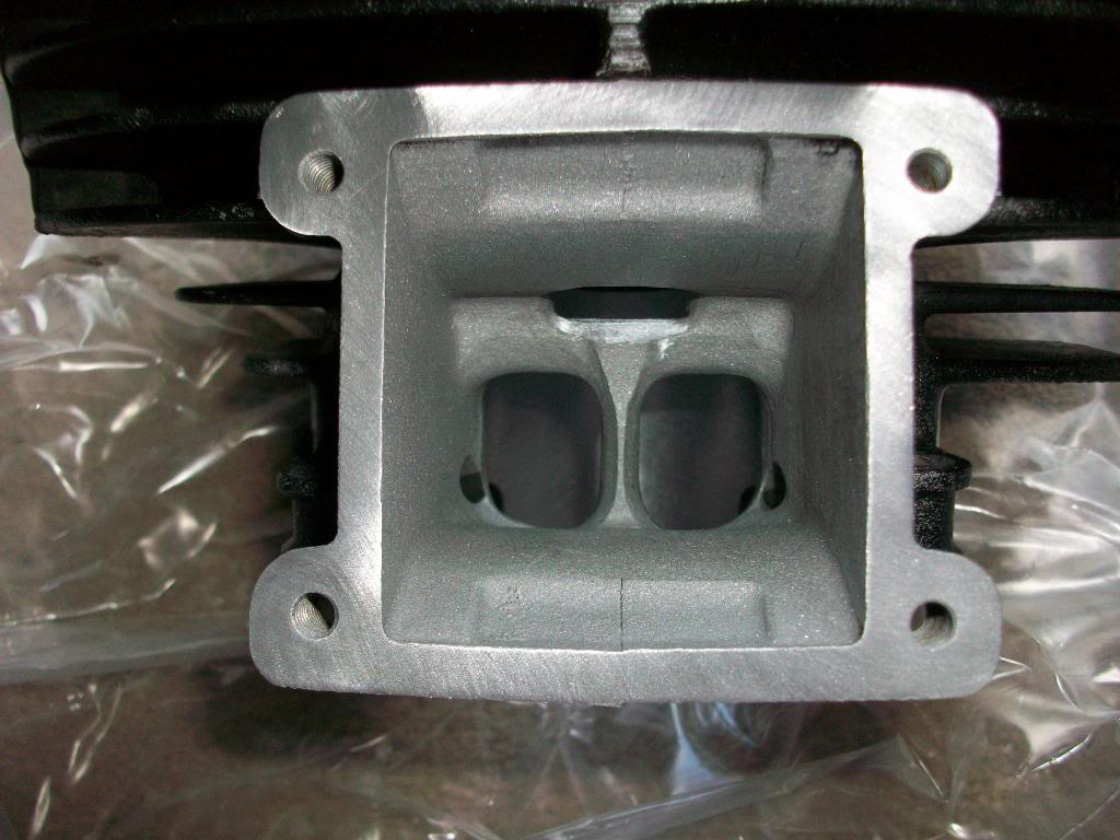

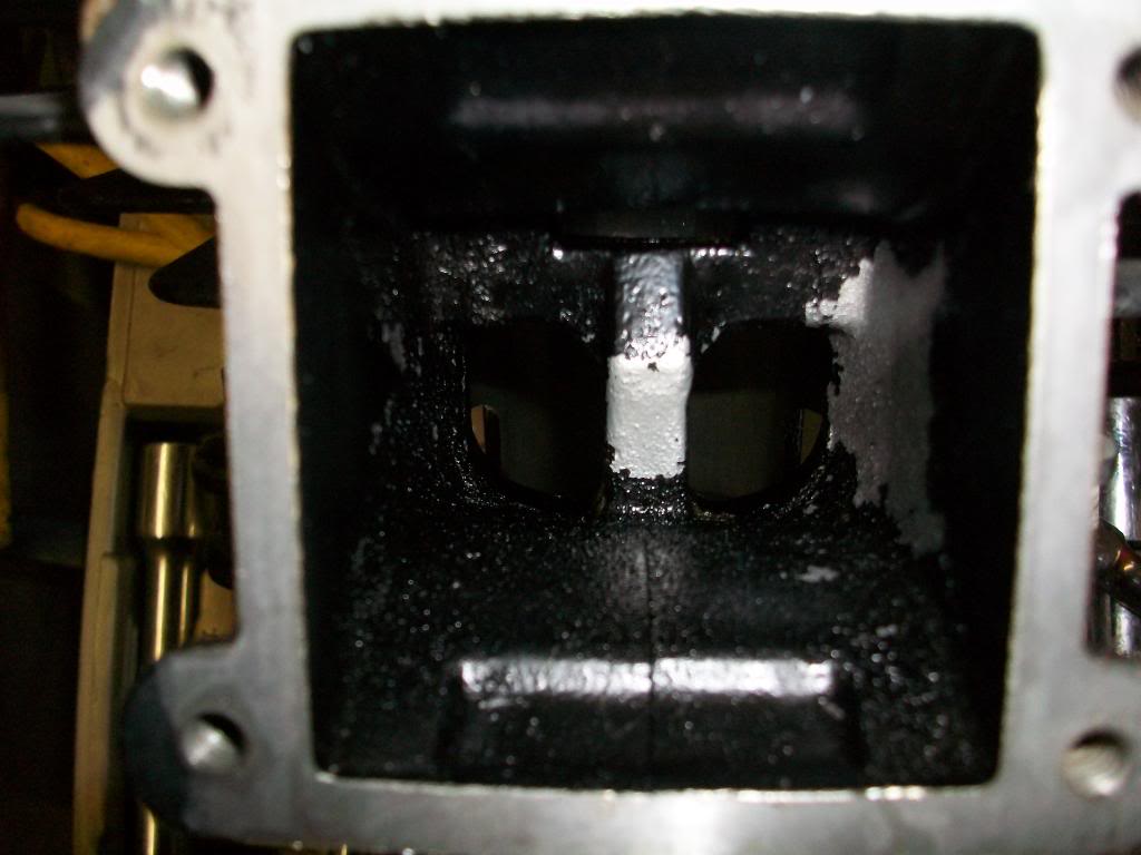

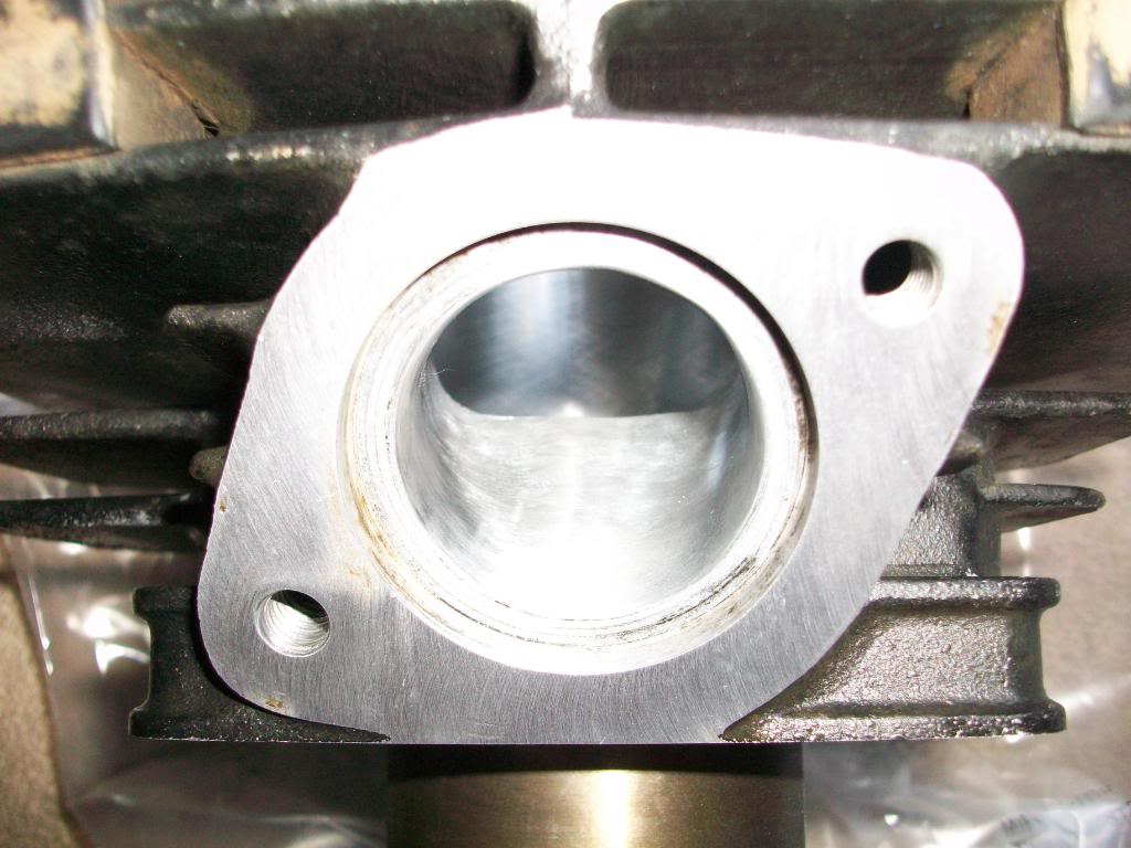

one step closer
before:
after:
gotta give a big thank you to Ken O'Connor. his work is amazing as you can see. i can't wait to get this installed.
next on the list is to get an exhaust ordered.
Re: My '03 Project
one step closer
before:
after:
Damn, Kens work is so freakin neat/perfect. Your going to love that ported motor my friend!!!
Re: My '03 Project
it's amazing dude. can't say that enough. can't do crap until i get an exhaust though.
