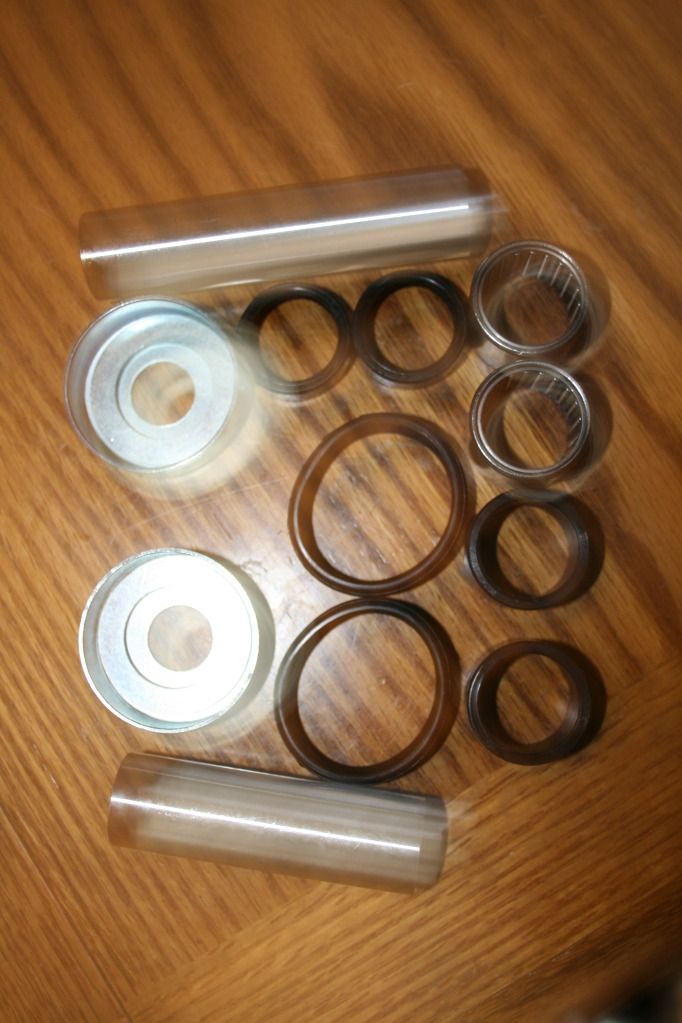

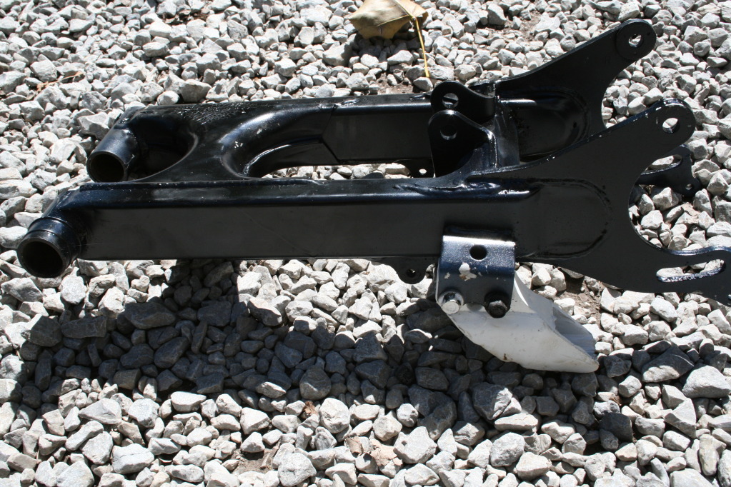

mud runner Member Jan 19, 2012 3,314 29 90 29 leabnon TN Sep 19, 2012 #182 ok iv got a queston is the swing arm suppost to have bearing in it and if they do then what size are they id od and with

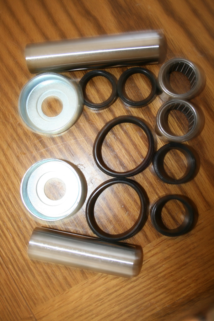

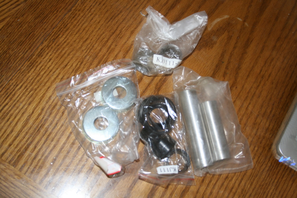

mud runner Member Jan 19, 2012 3,314 29 90 29 leabnon TN Sep 26, 2012 #192 look what came in the mail
B blasterBruce Member May 13, 2008 2,379 41 84 Griffin Ga Sep 26, 2012 #193 Nice what brand are those ?
mud runner Member Jan 19, 2012 3,314 29 90 29 leabnon TN Sep 26, 2012 #194 blasterBruce said: Nice what brand are those ? Click to expand... el cheapos off of ebay im trying too spend as little money as possible on the bike cansidering is spent $800 in the motor
B blasterBruce Member May 13, 2008 2,379 41 84 Griffin Ga Sep 26, 2012 #195 Makes sense with that price of a motor
