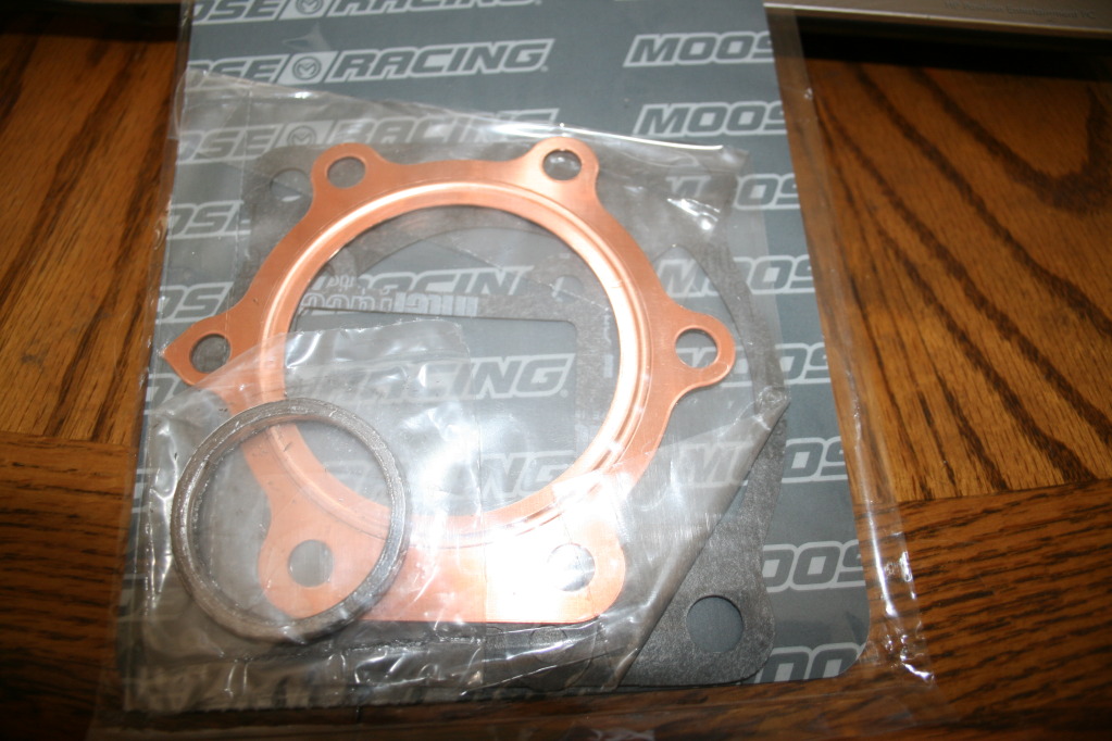

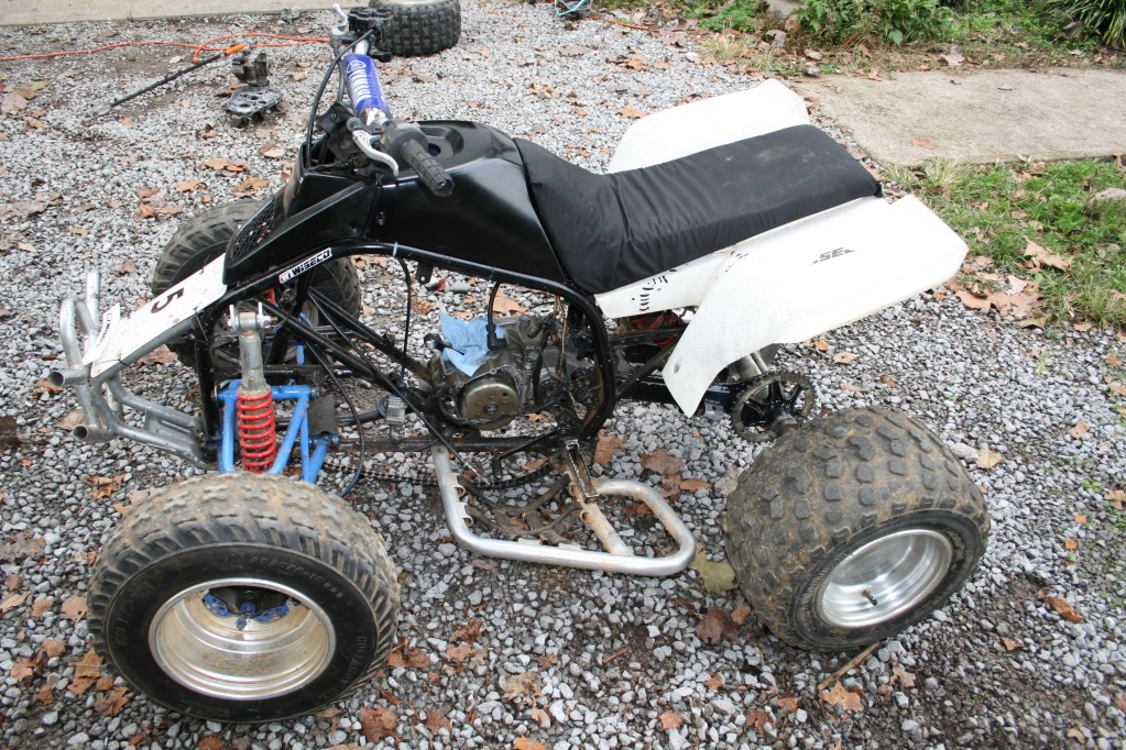

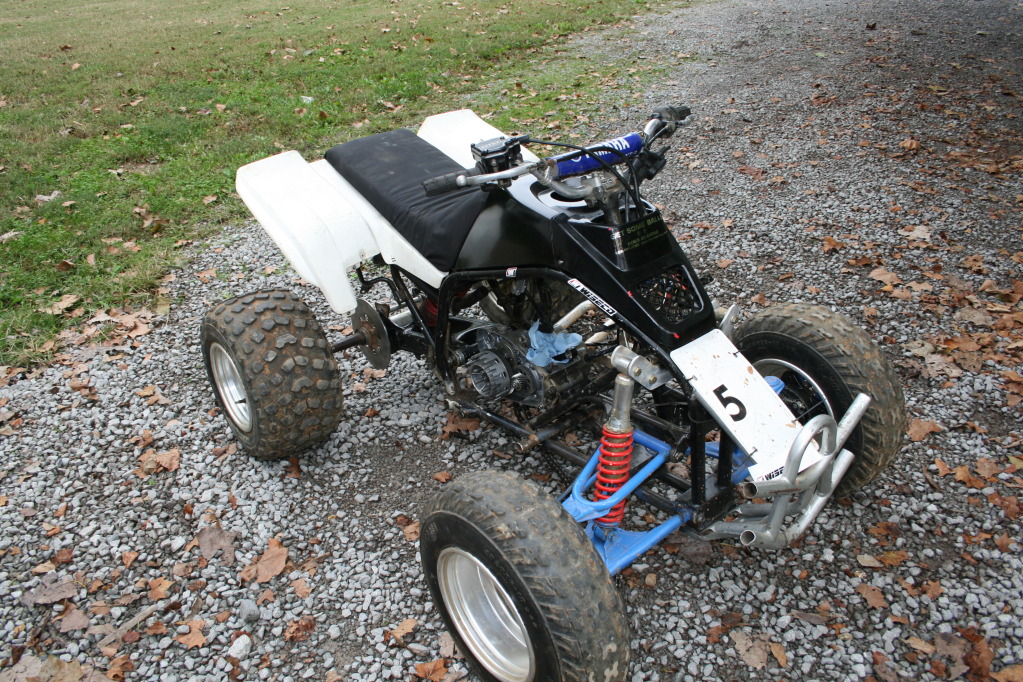

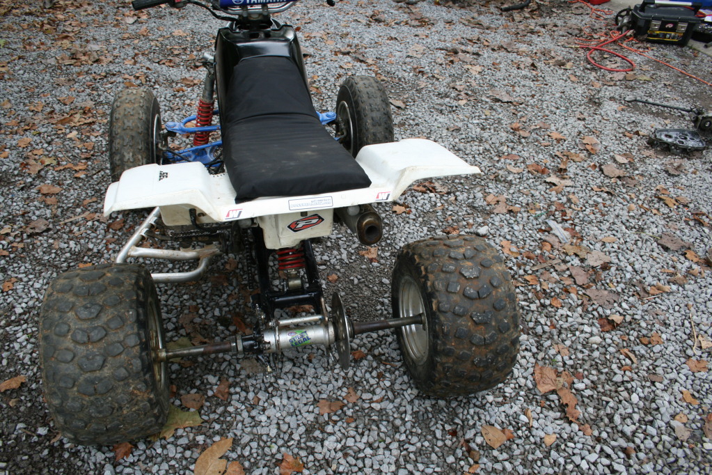

FINALY got the call from yamaha cylinder just got bored with a wiseco 60 over piston will have the topend put back toghter when i get home tomorrow

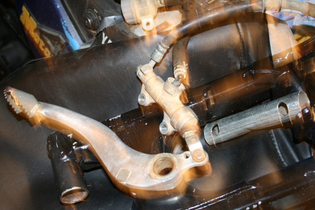

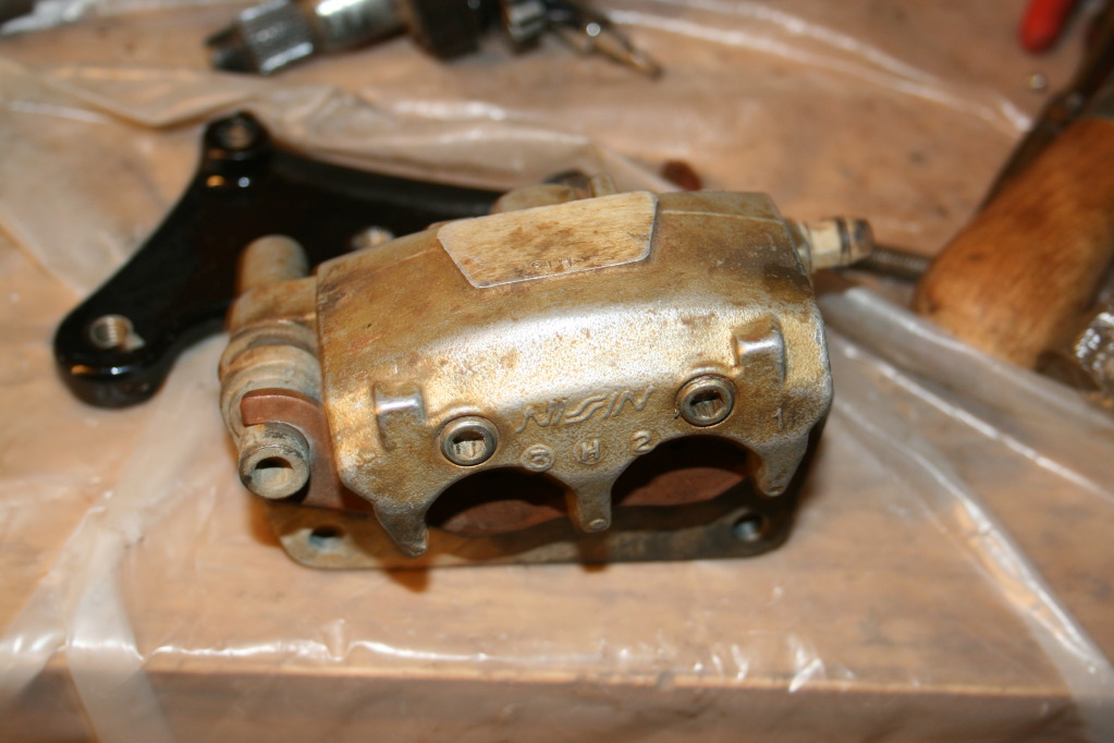

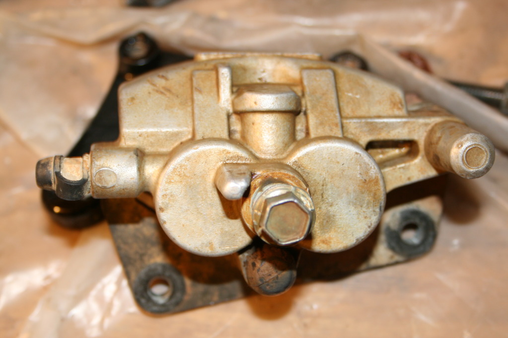

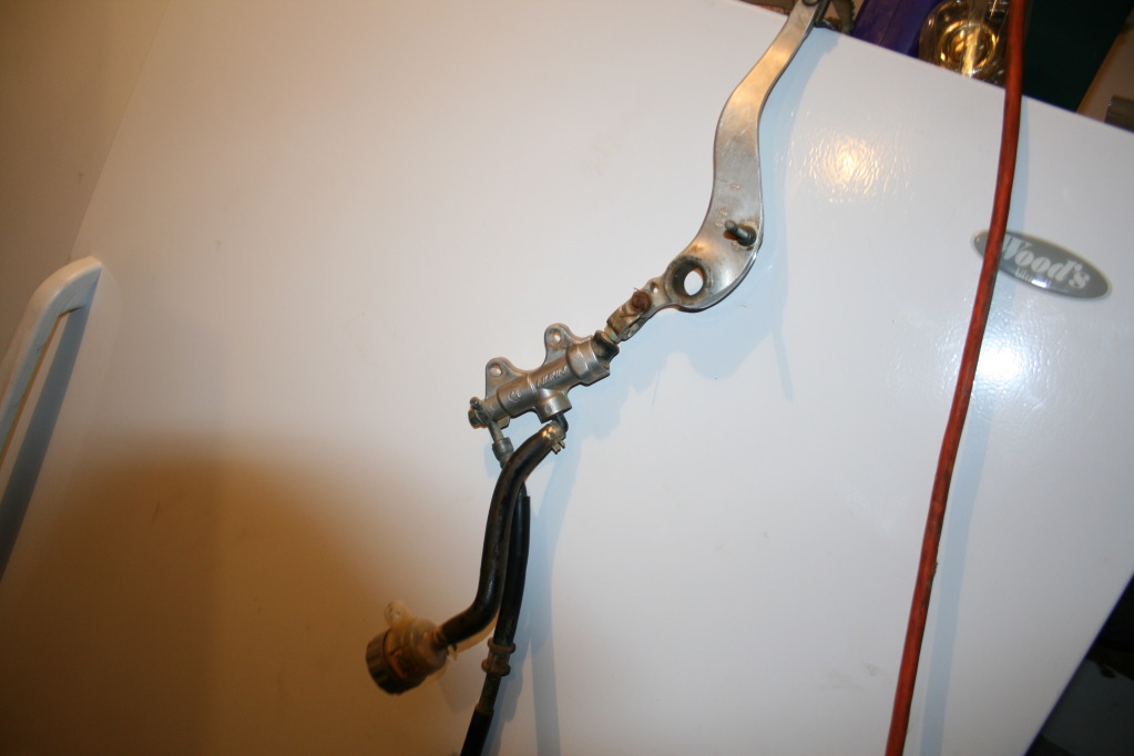

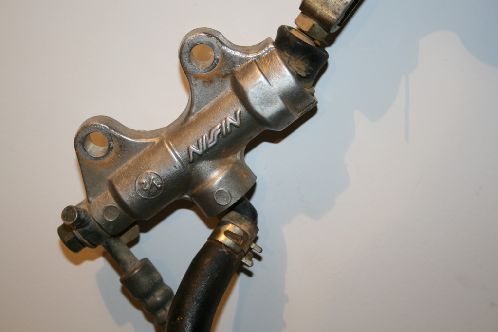

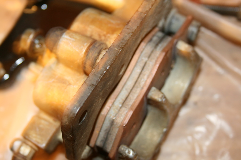

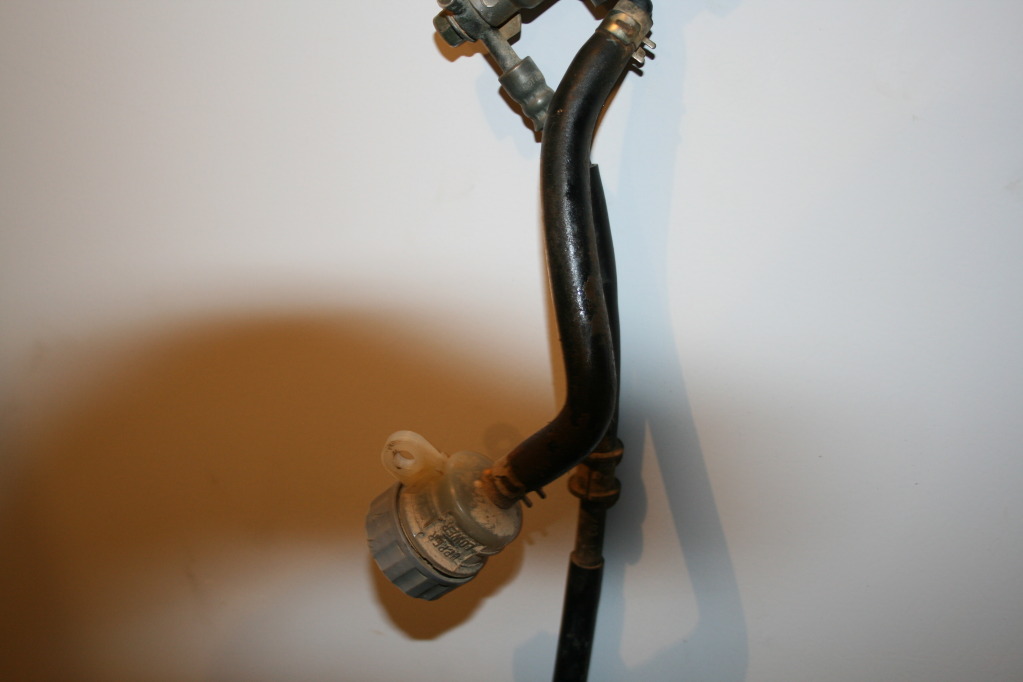

and im pretty happy with it because the only thing im gonna have to do is make a bracket for the master cylinder and res. the caliper bolts direcly to the stock mounting bracket

ya it should be back toghter tonight im having to clean the transfer ports because if you stick your finger in it it comes out black
