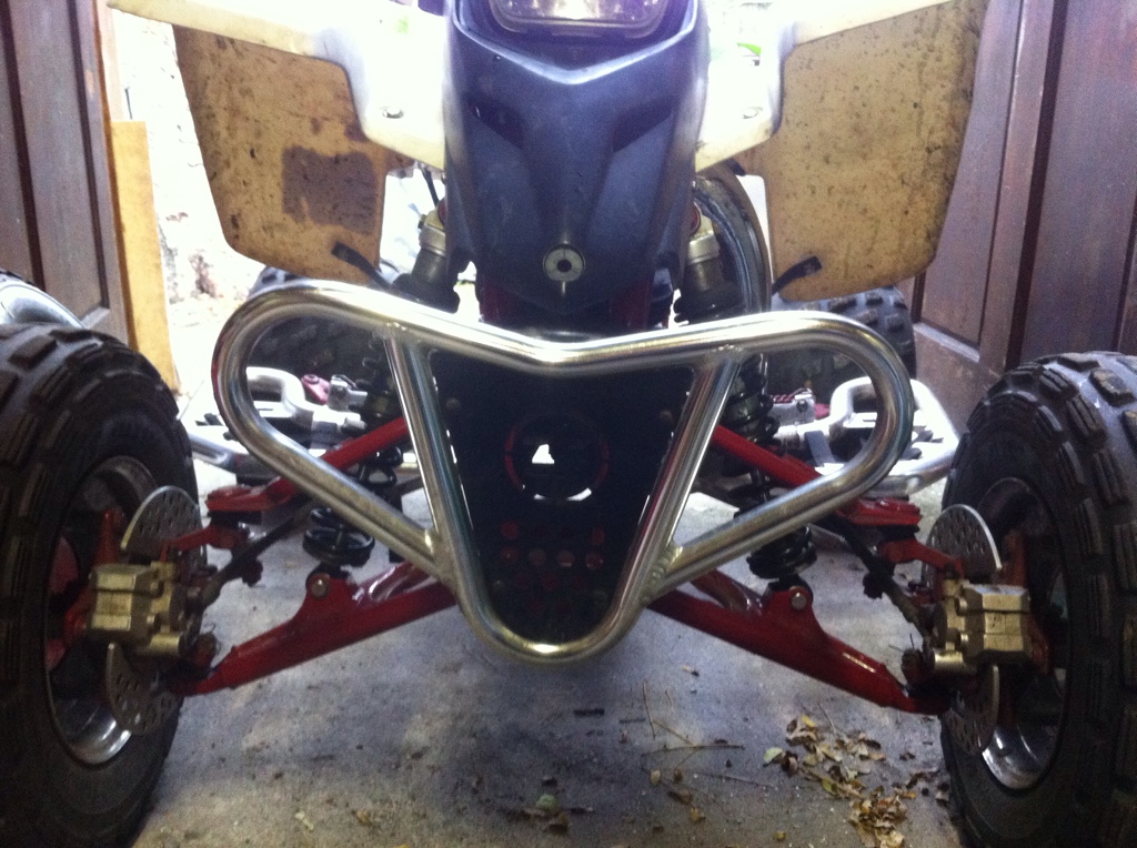

Ok they are on!!!
Man I really was digging that all black thing on the fenders look pretty sweet
