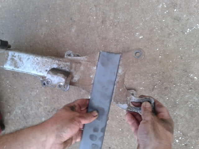

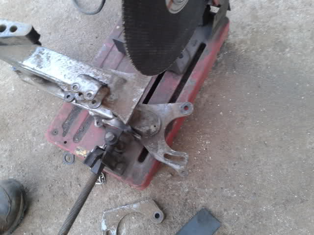

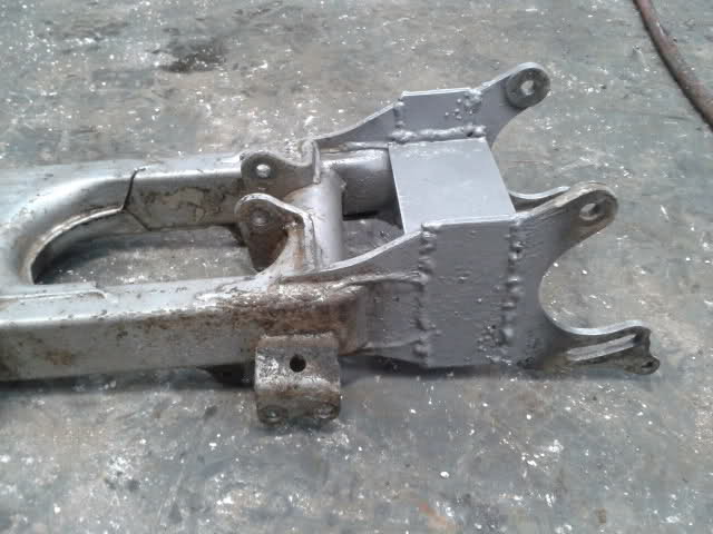

I opted for a 2" extension and am very happy with it:
I cut the swing arm here, and added a piece of 2"x1/4" flat steel here:
And added a horizontal 1/8" flat to it to take out any sway:
You have to be very careful to keep everything square, but not hard with this simple cut and weld.

i like where you chose to extend it, most other diys on here extend the tubes
cant wait to hear how it holds up,this might be how i replace my extention
