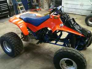

Can anyone on here put a pic up for me? I'm on my cell phone and I want people to see the lt250r I can either email or text you a picture. Or have you look it up on craigslist
by the mods its fine, put a 39mm carb on it, and a pro design head and tear sh*t up, if its truly ported that motor will make close to 50 hp if not more depending on the porting, the fmf is a good trail pipe for them but again depending on the porting you may want to find a used dr q pipe ( i say used because a new q pipe is like 900 bucks!) or a aaen almost a clone to the dr q or a ftz super fat pipe. or pt high rev
heres the lt

heres the lt
its not bad looking from the pic. always freaks me out not seeing a pipe running down the riders right side of the bike. Zuki sure did do things different back in the day.
you need to look this bike over real well. the upper shock mounts crack, so look at them closely.
when these motors are running well and not wore out they make very little engine case noise, if they arent, youll hear rattles in the bottom end.
dont get "new-bike-itice" and over look either of these. If you think it's expensive to repair your blaster, these are even more. If there's any doubt, walk away.
I does hit my strangely why the guy is willing to trade down in size, other then if there is something wrong with the bike that he's not telling.
