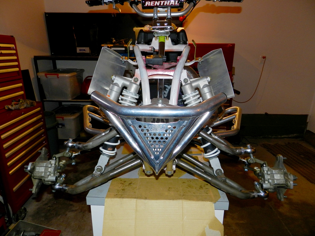

I finally got time to work on the blaster. Still trying to dial in the a arms, the rezzies aren't mounted and the brakes aren't ran but the a arms and shocks are on. Haven't ridden it but it's gonna be so nice to have disk brakes and not bottom out on our tabletop anymore lol
