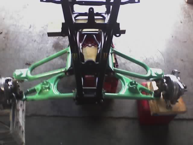

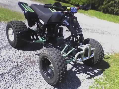

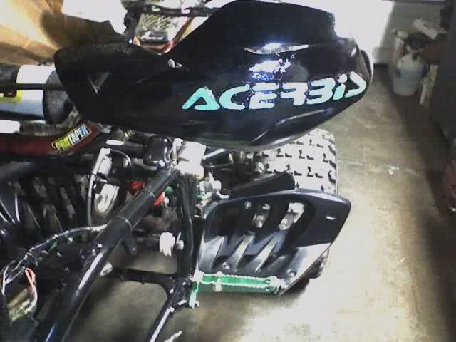

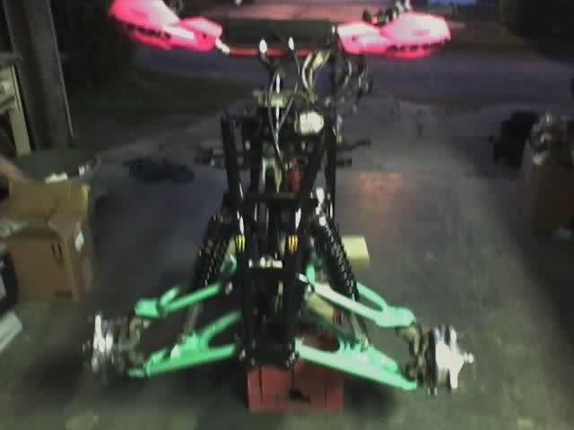

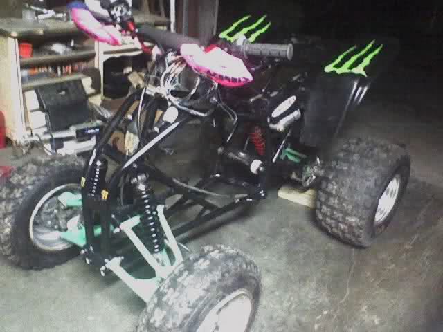

got most of the painting done, and startin to re-assemble it, got a pic of mrs. 305's old pink acerbis handgaurds, told the boy he has to keep them pink till he can outrun me on his blasty, he didnt think that was funny, so i painted them black, and gonna highlight the raised acerbis symbol the same color green as the other parts, which the green doesnt match exactly with the monster grafix, but i didnt wanna do chartruese, i like this color better, and the few small monster decals you may see on the frame and carrier are under the clearcoat, maybe they'll last a little longer like that???
still gotta make a bracket to lower the trx250r shock on the swinger, the ass is sitting way too high, i'll update with pics as i do that tomorrow, but i now have a roller, motor goin in prolly early next week, so i can still ride over the weekend, (remember it's in my bike and running good) not near the juice my oconnor ported motor has but still strong
oh yeah, did the footpegs that color green also, to tie in the middle of the bike

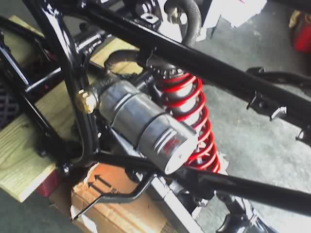

put the brand new yfz 450 heelgaurds on over the weekend, got the rear upper brackets made and mounted after this pic was taken,
and painted the pink 305 handgaurds and mounted them too

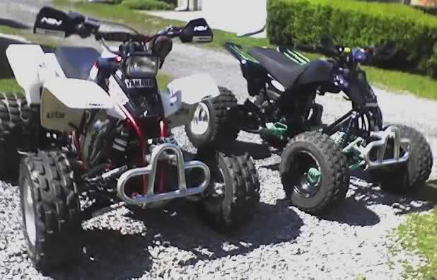

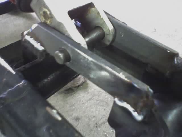

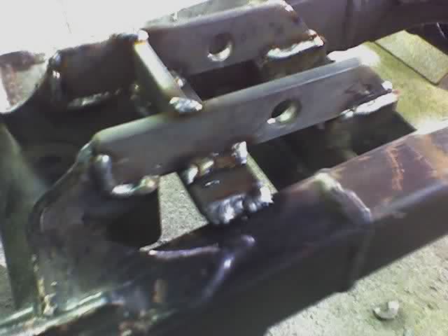

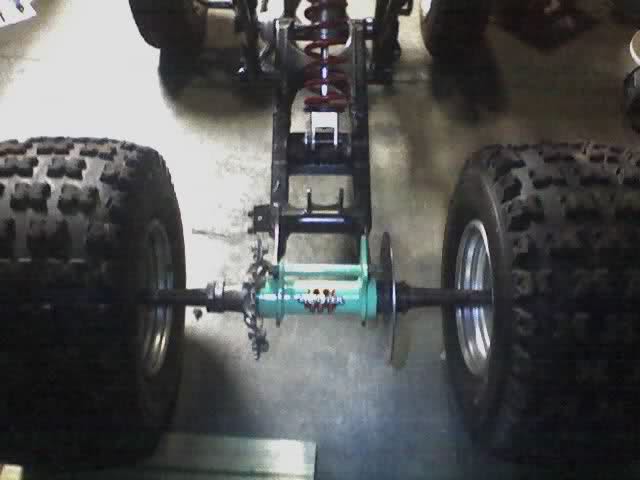

didnt like how high the trx250r shock made it sit when placed in the new mount someone made in the +4 swinger, the rear fenders were at least 8 inches higher than mine, and when i moved it to the stock mount still on it, it sat too low, cut both mounts off flush and level, then made 2 rails that span the gap, repositioned the shock to my likings, drilled new holes for the mounting pin, and had it welded up, moving the pin back about 2 inches lowered it the 6 inches needed, still sits a little higher than mine, but i like it, and it has soooo much shock travel
might drill a few more holes in the rails to allow it to be adjustable???? just gotta get the new mounts and welds repainted now
thats exactly what i was gonna say...drill more holes so it can be adjustable...
i wouldnt make too many mabye 3 so that it doesnt weaken the mount. wouldnt wanna hear that it broke and he got hurt...
i may drill 2 more spaced out holes behind the one i have now, but i kinda set it to my liking, gotta get him on it and adjust the sag then see, and thats some pretty harc sh*t i used, burnt up a bit on the first set i try'd to just bolt on, then decided to weld it

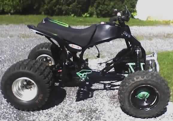

had to throw my baby in a couple pics, and one to show the rear height difference still, between my 450r shock and the 250r shock with the +4 swinger
