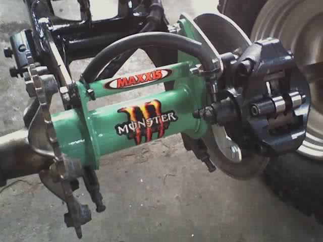

and of course it got a set of "awks" gsxr brakes, but damn, the line that came with this set would prolly fit a +12 swinger, musta been on an extended gsxr???
i have a shorter one i was saving for ,mine, but prolly gonna change this one out???

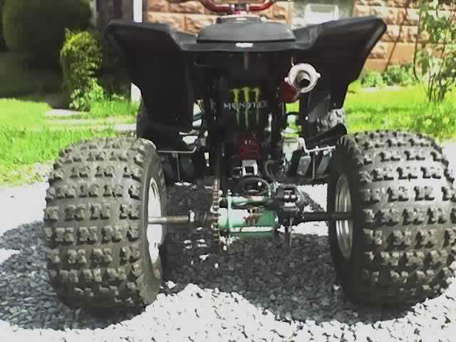

but heres some pics, it was already dark when we got finished so they're a little sh*tty, i'll get better ones tomorrow....................

and found that when i flipped the rear banshee rims i gained 1 inch each side, so plus 2 inch rear width, just from flipping the rims

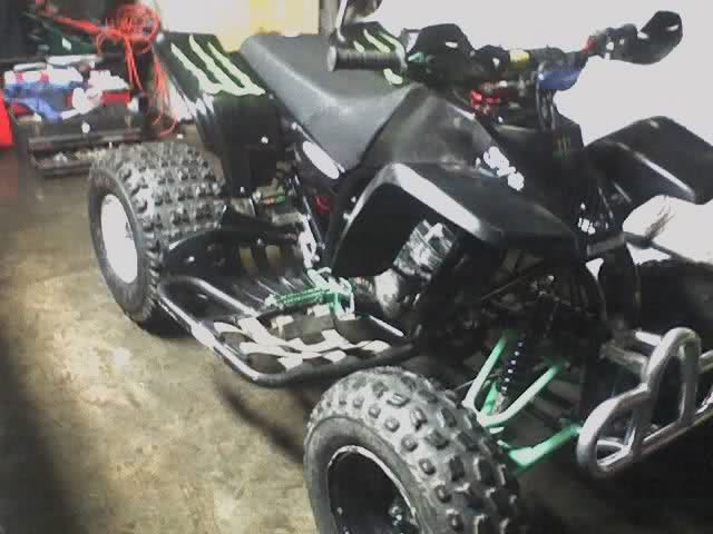

got a few better pics today, and also got my motor back in and fired up, still got some tuning/jetting to do,

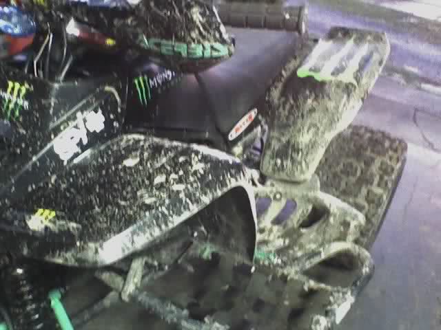

found a broken reed in the stock cage, put a set of stock pedals on the vf2 cage to replace the one broken one on it, runs good and strong now, had it out and got it a little muddy, but this suspension really needs some help, saw a thread the other day called "boing, boing" and that describes this to a "t", i think these banshee fronts may be blown, i can stand on it and bounce up and down, and the bike will actually come off the ground, i do need to turn the spring back down on the 250r rear shock, its a little soft too, but these fronts have to go,
"works" coming soon!!,
this thing is dangerous like this, way too much power for sh*tty front suspension
