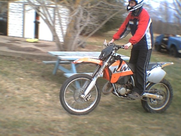

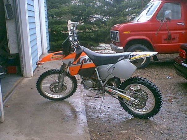

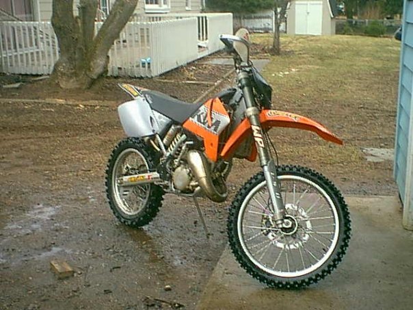

Did 4 hours of woods and trail riding on my KTM 125 with my daughter yesterday.
A bit sore and a few blisters, have I ever missed this! Lots of mud and I had my highway tire and sprocket on, got through anyway.
Your motor is at least a 250 from the early 1990s, your forks post 2000 if they are KTM. This bike will work well when you get it together. Piston diameter will tell you if it is a 250, 300 or 360. Show some more picts! I love these motors.
