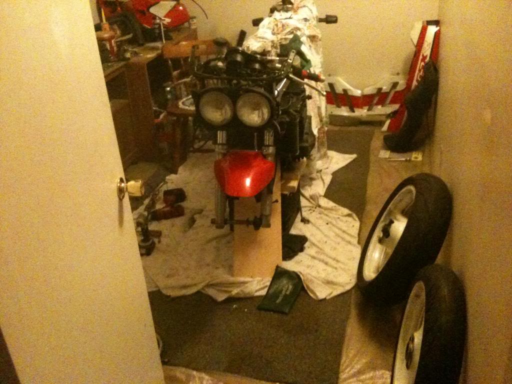

in pieces!!!! LMFAO!!!!!!!!!!!!
i know, i tried going on the gixxer forums but theyre a bunch of stuck up ass holes!!! still, i dont know how everyone would feel about a bike rebuild thread in a 4 wheeler forum???
