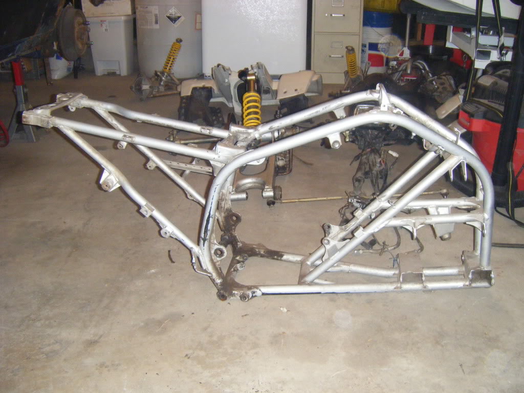

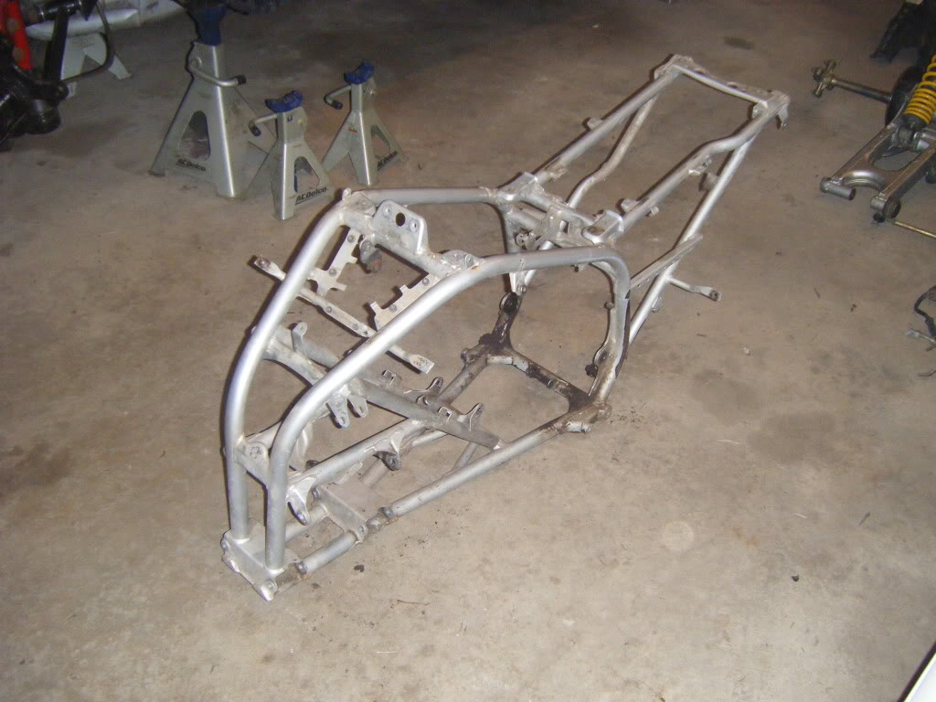

Anyway I actually made a little progress tonight. I am going to take the frame to work with me tomorrow and powerwash it and strip it.

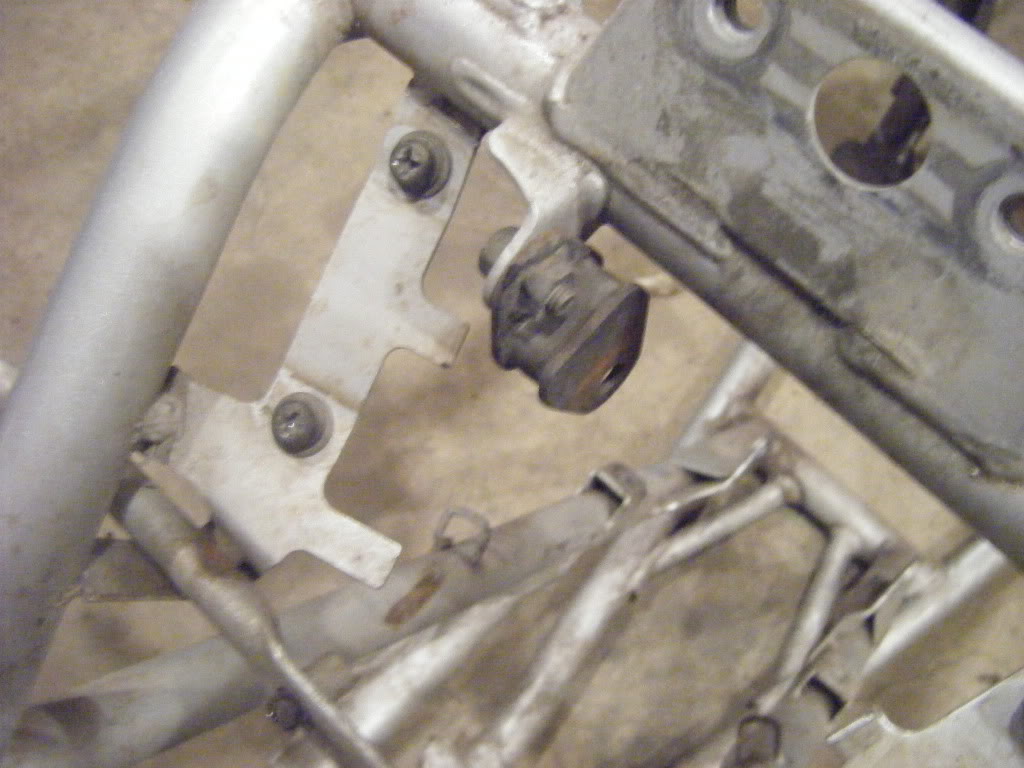

What the hell hooks up to this? I am pretty sure I didnt take anything off of it....
You talking about that black bracket right under where the gas tank goes..?? If so thats where the top of the header connects for support. I dont know about other headers but if you got an FMF Fatty or a stock it bolts on to there. Theres a little bracket on top of the header, they meet up and bolt together when installed.
Oh ok, I didnt think I took anything off of that. The previous owner had the pipe off already.

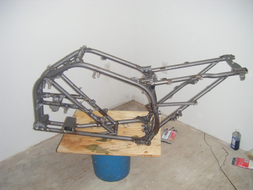

This is comming along pretty smooth now. I got the frame taken down to bare metal at work and when I got home I wiped it all down with some paint prep and sprayed the acid etching primer on it.
I did find the bracket for the front fenders was broke on one side so I welded that back together before spraying it with primer...

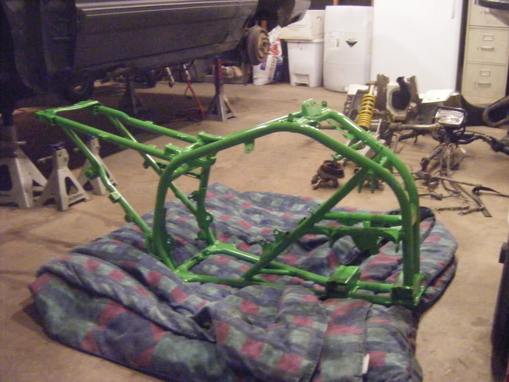

I have completely finished painting the frame. My basement looks ridiculous with the a-arms, heel guards, brake pedal, grab bar, bumper and 2 brackets hanging up.... I will get some pictures up tomorrow. I have the case halves together but thats the only progress I have made. I am waiting on the seals and gaskets to show up. I am leaning heavily towards flotek to do my top end, he is the only one that has returned my pm's and emails.

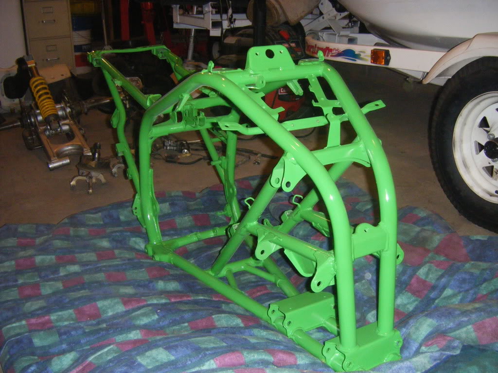

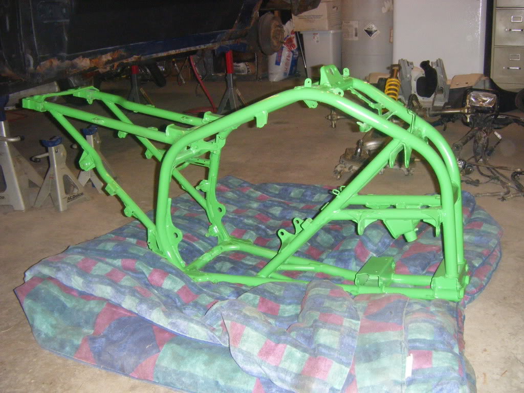

So I finally got some new pictures up of the frame all painted. They came out weird. I dont know if its my garage lighting or the camera flash. Its been raining and snowing and sh*tty here in Iowa. If the sun ever comes out I will get some pictures of her in the yard. These pics make it look really light colored I think.
