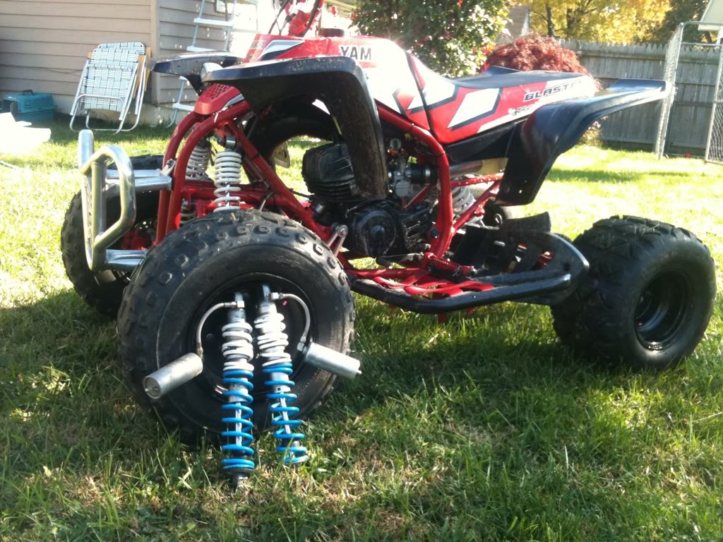

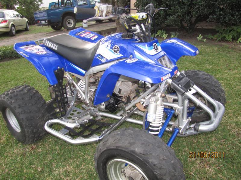

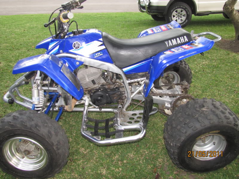

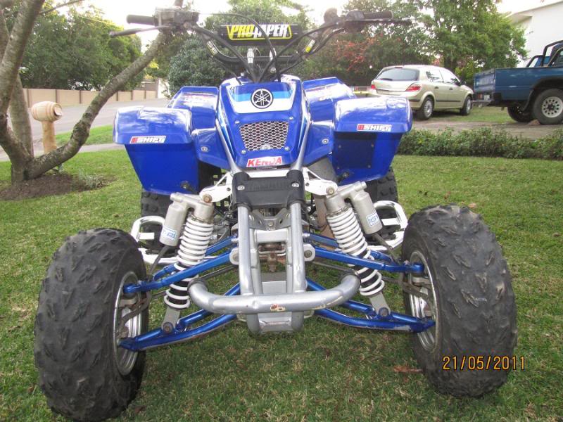

A Arms: Stock
Swingarm: Stock
Steering Stem: Stock
Stabilizer: None
Axle : Stock length with 3 inch wheelspacers
Carrier: stock
Locknut: stock
Hubs F|R: blaster stock hubs
Bars: Fly Racing
Throttle/Clutch Lever: Shorty Clutch Lever Yamaha Throttle Cover
Grips: Protaper Rockstar MX Grips
Nerfs: Custom Built
Bumper: Jaws bumber
Grab Bar: DG Grab Bar
Front Shocks: Pep Racing Shocks With remote Rezzies
Rear Shock: Pep Racing Rear Shock With remote Rezzy
Brake Lines: Motion Pro
Rotors F|R: Stock
Rims F|R: Stock Yamaha Rims
Tires F|R: Nankang MX Tires Flipped Front Tires
Body:
Frame: 1996 Stock Yamaha Frame
Plastic: 1996 Stock Fenders And Maier Race hood
Graphics|Seat Cover: Aftermarket seat not sure of the brand Monster energy stickers and many others
Number Backgrounds: none
Handguards: None yet
Bar Pad: Fly Racing MX Bar Pad
Fuel Tank: Stock 2.5 Gallons
Engine|Drive System:
Cylinder|Head: Stock Head And cylinder WSM PLATIUMN Top End rebuild
Bore & Stroke: Stock
Displacement: 195cc
Cam:Vitos Dual Stage reeds
Carburetor:Stock Jetted 270 main needle postion 4th
Air Filter|Box: UNI Pod Filter Removed Airbox Lid
Pipe|Silencer: DMC Alien Exhaust System
Clutch|Plates: Stock as far as i know
Gearing F|R: 14/40 with moose alumiumn rear sprocket
CDI|Killswitch: Stock Kill Switch
Cooling: Stock Air Cooled
Other: Was a raced before i got it and was returned to stock before i got it also. I am currently Building it back to get it race ready and am getting ready to race it. Thanks to all the great memebers on this forum for the advice and knownaldge below is a video of it when i got it to today.

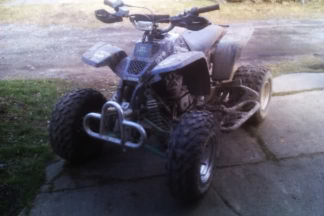

Re: January 2011 BOTM Entries
Modification Form

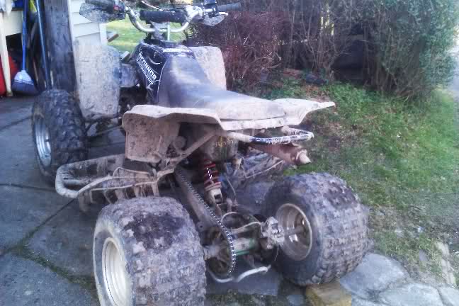

A Arms: Stock
Swingarm: +3 by Tater
Steering Stem:Stock
Stabilizer:None
Axle :Stock Banshee
Carrier:Stock
Locknut:Boss Racing Billet
Hubs F|R:Banahee/ Stock
Bars:Stock
Throttle/Clutch Lever:Stock
Grips: Oury
Nerfs:Fat bar with nets
BumperG
Grab Bar: Stock
Front Shocks:Stock Banshee/ Works tripple rate with resavore. Owned but not installed yet.
Rear Shock:400ex
Brake Lines:GSXR rear/ SS Braided front
Rotors F|R: Banshee/ Stock
Rims F|R:Stock
Tires F|R:Stock/ Duro flat track 18's
Body:2000
Frame:2000
Plastic:2000
Graphics|Seat CoverMC
Number Backgrounds:N/A
Handguards:N/A
Bar Pad:N/A
Fuel Tank: Stock
Cylinder|Head:Stock with HJR agressive MX port/ Ken O'Conner redesigned head
Bore & Stroke:80 over/ Stock
Displacement:
Cam:VF 3 reeds
Carburetor: 30 mm OKO flat slide race carb
Air Filter|Box:Uni/ CFM
Pipe|Silencer:F7/Toomey
Clutch|Plates:Stock
Gearing F|R:14/41
CDI|Killswitch:Teatherkill switch
Cooling:
Other:Billet exhaust coupler,Billet tail light cover,Billet bar clamp,Billet axle nut,Billet gas cap,Norman420 front spindles,Awk08 rear GSXR rear brake. This was rebuilt from the ground up from a stock Blaster. It was built by me with the help of this forum and many of it's great members. Thanks to Shane(owner of dirt paradise forum) for the free port work.

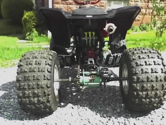

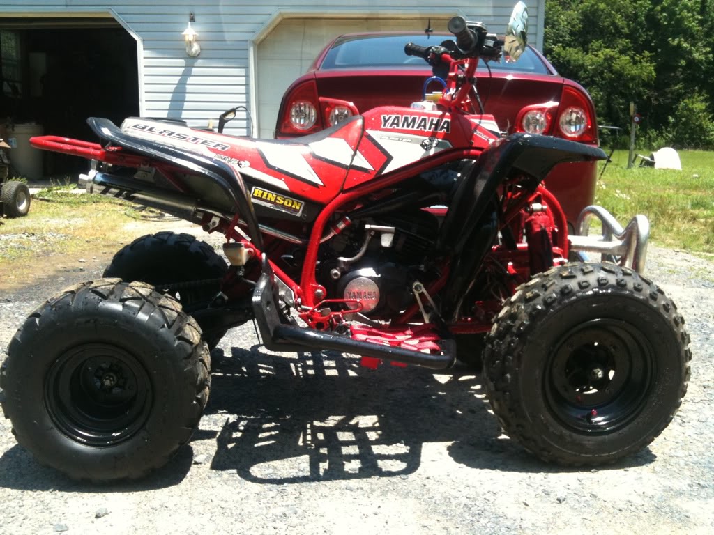

1.A Arms: pro x racing +3 +1
2.Swingarm: +4 bytator
3.Steering Stem: stock with Nac racing clamp
4.Stabilizer: na
5.Axle : banshee
6.Carrier: stock
7.Locknut: stock
8.Hubs F|R:shock front/stock rear
9.Bars: moose racing
10.Throttle/Clutch Lever: stock
11.Grips: moose grips
12.Nerfs: tusk
13.Bumper: tusk
14.Grab Bar: custom made
15.Front Shocks: yfz 450
16.Rear Shock: 400 ex
17.Brake Lines: braided
18.Rotors F|R: banshee front
19.Rims F|R: itp front rims/oem rear
20.Tires F|R: itp hole shots
Body:
1.Frame: oem
2.Plastic: maier racing front and gas tank cover, maier banshee rear fender
3.Graphics|Seat Cover: stock
4.Number Backgrounds: na
5.Handguards: tusk
6.Bar Pad: moose racing
7.Fuel Tank: oem
1.Cylinder|Head: vitos big bore kit aggressive trail port
2.Bore & Stroke:, 72.50 wiseco forged piston/stock stroke
3.Displacement:
4.Cam: na
5.Carburetor: 34mm Keihin
6.Air Filter|Box: UNI pod filter/ CFM aluminum
7.Pipe|Silencer: full fmf
8.Clutch|Plates: stock
9.Gearing F|R: 14/38
10.CDI|Killswitch: tusk
11.Cooling: na
12.Other: tusk gas cap, awks rear gsxr brakes, banshee front hydro brakes, monster shock cover,tors removed

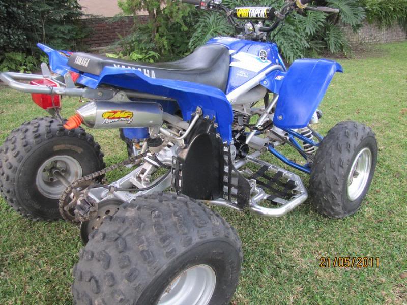

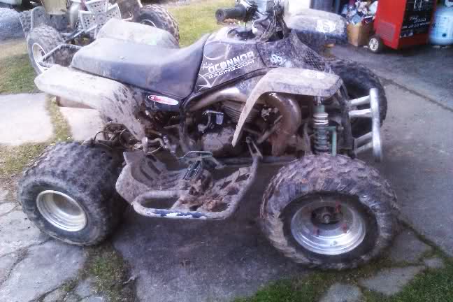

A Arms: STOCK
Swingarm: +4
Steering Stem: STOCK
Stabilizer: OLD GIBSON
Axle : STOCK
Carrier: STOCK
Locknut: 2 OF THEM...STOCK
Hubs F|R: F-BANSHEE R-BANSHEE
Bars: PROTAPER
Throttle/Clutch Lever: CR STYLE EZ-PULL
Grips: OURY
Nerfs: A/C
Bumper: D-G
Grab Bar: CUSTOM WELDED IN
Front Shocks: WORKS DUAL RATE
Rear Shock: TRX250R W/ADJUSTABLE REMOTE REZZIE
Brake Lines: F-BANSHEE R-BRAIDED STAINLESS
Rotors F|R: F-BANSHEE R-STOCK
Rims F|R: F-DOUGLAS ROLLED LIP R-BANSHEE
Tires F|R: F-CARLISE TRAIL WOLFS R-MAXXIS RAZR'S
Body: SEXY ONE
Frame: HANDED DOWN FROM ME
Plastic: MUDDY MAIER'S
Graphics|Seat Cover: GRIPPER
Number Backgrounds: N/A
Handguards: ACERBIS
Bar Pad: BLACK FOAM/LOST COVER
Fuel Tank: ALMOST EMPTY
Cylinder|Head: STOCK BORE, KEN OCONNOR VERY MILD PORT CLEANUP & HEAD MOD
Bore & Stroke: STOCK
Displacement: 1/2 MY GARAGE
Cam: NEWTON
Carburetor: STOCK
Air Filter|Box: MAIER
Pipe|Silencer: LRD ADJUSTABLE/F7 SILENCER
Clutch|Plates: STOCK
Gearing F|R: 13/40
CDI|Killswitch: N/A
Cooling: COOL MOUNTAIN AIR
Others...........
KEN OCONNOR RACING TANK GRAFIX
VF3'S,
UNI FILTER
A/C NERFS,
YFZ HEELGAURDS,
AWKS GSXR HYDRO'S,
BANSHEE HYDRO'S/NORMS SPINDLES,
DOUBLED PEGS-YFZ OVER STOCK,
ADVANCED AUTO FOG LIGHT,
GREEN L.E.D. REAR RUNNING LIGHTS,
MONSTER GRAFIX UNDER THE MUD,
GREEN O-RING CHAIN,
Nobody said anything about having a motor in the blaster yet! If this is not allowed feel free to delete this. Here goes!

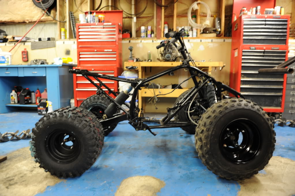

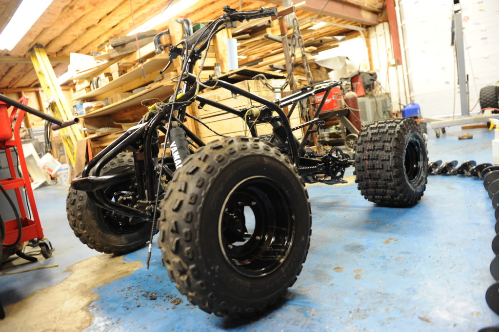

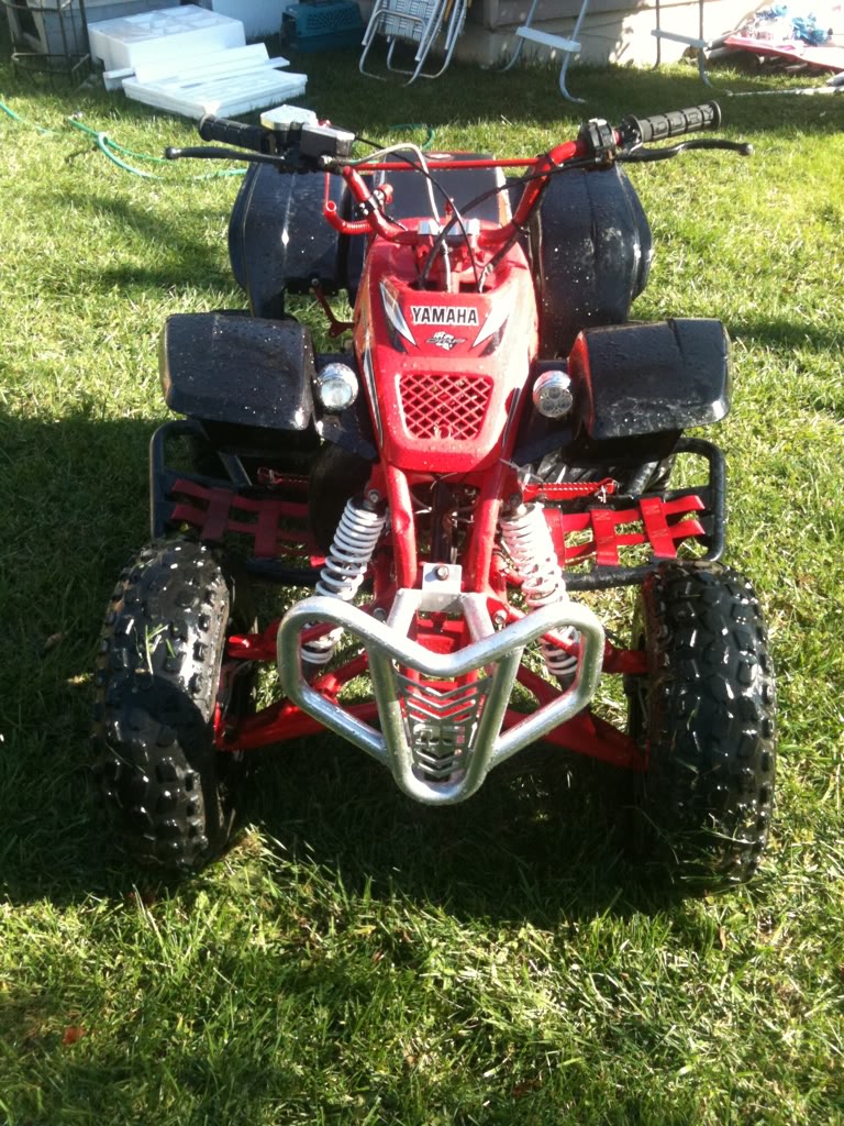

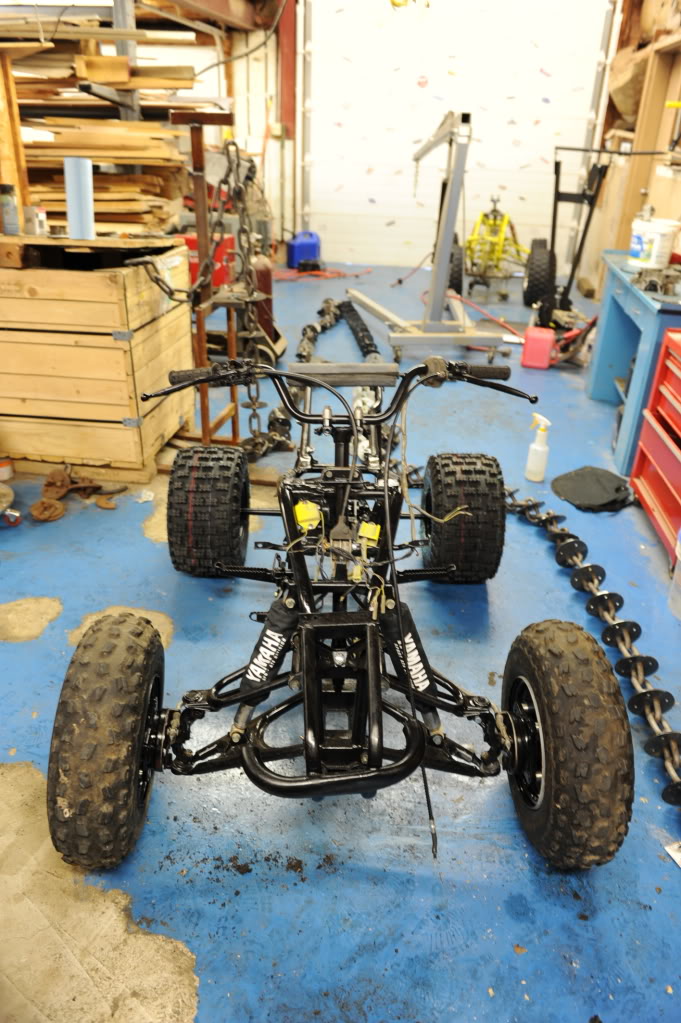

A Arms: Stock
Swingarm: Stock
Stabilizer: None
Axle : Stock
Carrier: Stock
Locknut: Stock
Hubs F|R: Stock
Bars: Stock
Throttle/Clutch Lever: Stock
Grips: Scott Waffle Grips
Nerfs: None yet
Bumper: Stock
Grab Bar: None
Front Shocks: Stock
Rear Shock: Stock
Brake Lines: Stock
Rotors F|R: Stock drums
Rims F|R: Stock flipped
Tires F|R: Artrax in the rear and stock in the front
Body:
Frame: Stock
Plastic: Stock
Graphics|Seat Cover: Stock
Number Backgrounds:None
Handguards: None
Bar Pad: I am going to not use one.
Fuel Tank: Once again, Hummer V1 gas tank of course!
Cylinder|Head:None
Bore & Stroke:None
Displacement:None
Cam:None
Carburetor:None
Air Filter|Box: None
Pipe|Silencer: None
Clutch|Plates: None
Gearing F|R:None
Cooling:None
Other: 1 Inch wheel spacers on each wheel plus flipped rims!
