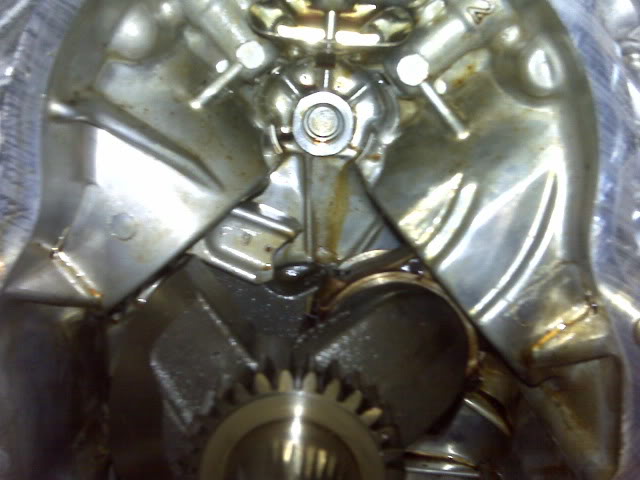

This is what the engine looks like currently. I'm in the process of building it, was run low on oil.
