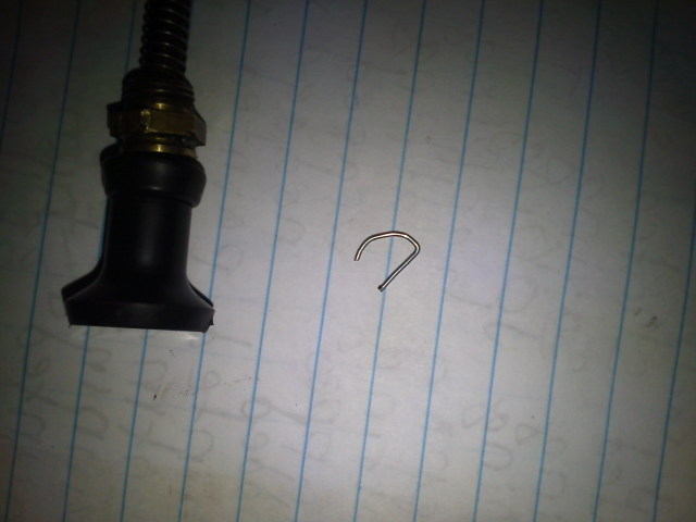

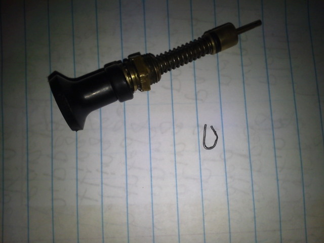

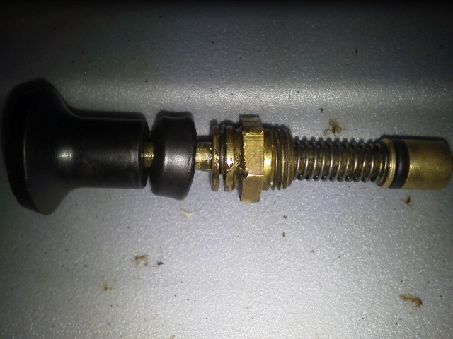

This is one of the first problems I found on my blaster. Here's where my problem was, under the rubber boot is a groove
In that groove is a metal clip
See how its got a spot worn in it, I did my best to bend a paper clip to the same shape
It doesn't work perfect because the metal is not as stiff but it does work just takes a little patience
No typo .. cuz I cannot edit my post.....26 mm piece of junk
I found the spring clip ,under the cover ,it was broken and fell out. ,It does start on the 2nd kick but it was sticking too , the shaft is bent and galled bad anyway. Guess Ill cough up $38. at the dealer to end this agony.
