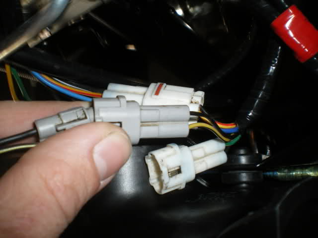

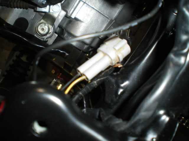

Step 1 - Locate and unplug the two following connectors.
The first is under the hood and can be found by following down the wires from the thumb throttle, It looks like this -
You will find the second, If you trace the wires coming out of the TORS unit located on the top of your carb. It is pictured here - (already unplugged)
At this point you can unplug both connectors. You will be left with what is pictured above.

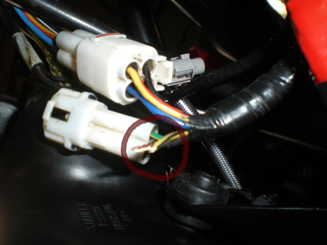

So back to the TORS. Now that you have both connectors unplugged you will need to cut them off (connectors on ECU side not carb and throttle side)
You will have two wires (black and yellow) left with no connector. one set under hood, one set under seat. Once again, make sure you have cut the connectors on ECU side not carb and throttle side.
Lastly, strip the ends of the wires and splice the yellow and black wires together where they have been cut. (you must splice both sets).
Here is what you should have - (hood side shown only, though you must also splice rear set)
At this point I would suggest you solder them for good connection and then cap them. If doing quickly you can just tape em off after splicing.

cut and connect the yellow/black stripe to the solid black, coming directly out of the ECU, that fools it.
just as the pics show.....
once those are connected and the ECU fooled, none of the other wiring matters, not at the throttle or the carb, as the circut that monitors them is jumped together upstream of them.

the solid black and yellow/black stripe wire MUST be connected to fool the TORS electronics........
if you deleted the yellow/black stripe (?) you'll need to find a way to replace it so it can be spliced,
or get a new CDI/TORS unit and wiring harnes, or whatever it takes to replace that yellow/black wire.
this bike will never run without a stock, unmolested, working tors sytem or properly cut/connected wiring.
