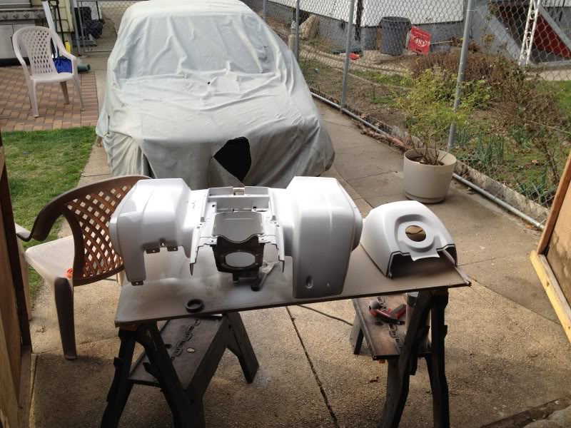

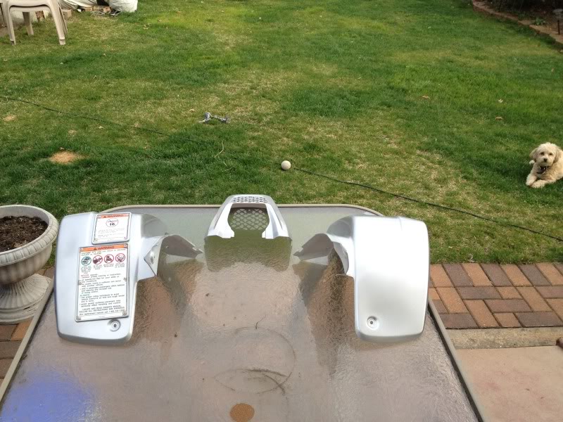

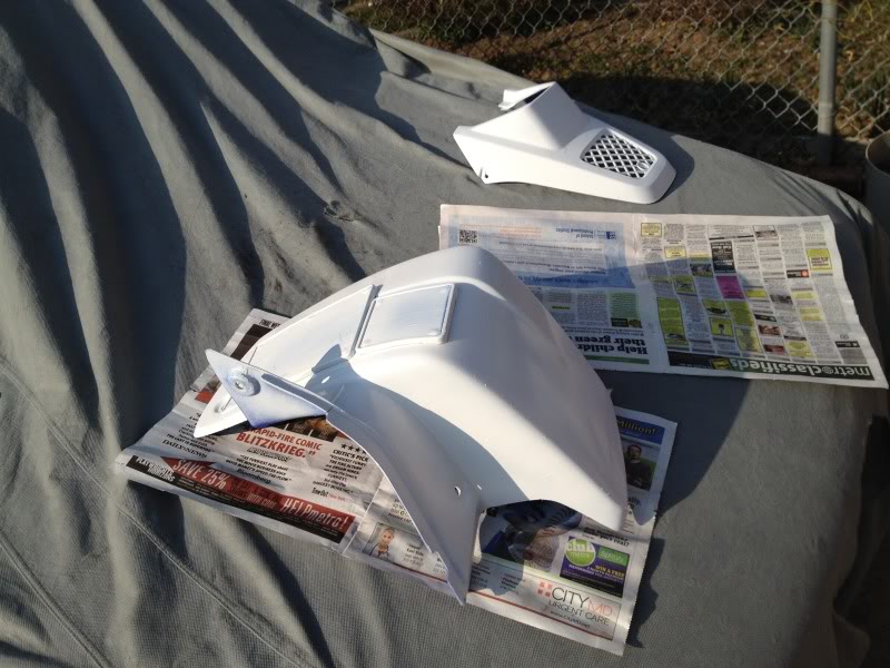

Sup Guys... I used Rust-oluem paint for plastics.. Work still in process here are some pics. 2 Coats of Primer, 2 Coats of paint and 2 coats of clear coat. I didn't bother to sand the plastics before or after priming so there are still a bit of imporfections on the plastics (regular rinding nicks) but still looks good.
Primer
Paint & Clear coat.
