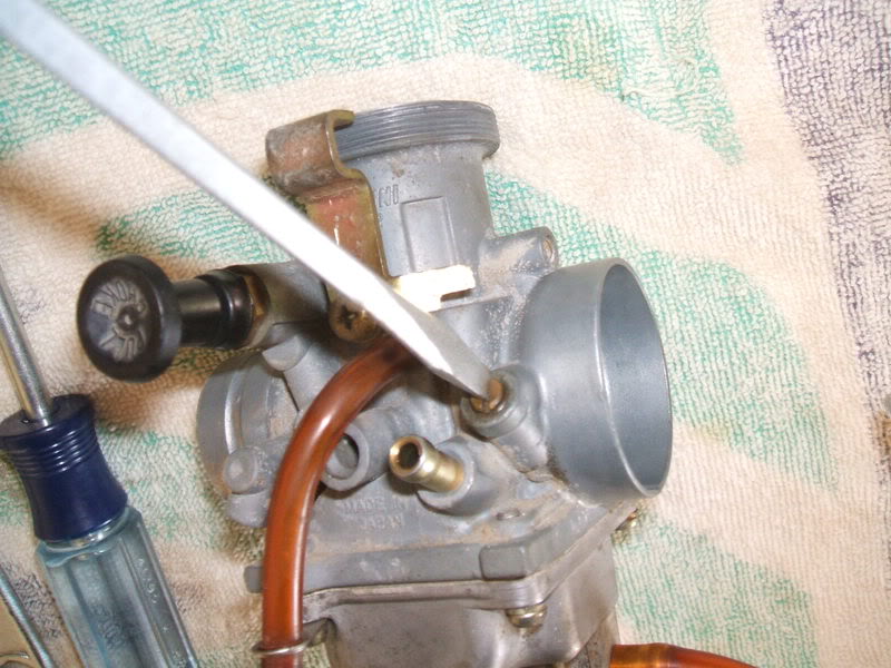

I'm tryin to get my carb off , how do I get the black off in the back of the carb?

In your second picture there is a little hole beside where the gas line hooks up and the choke, is that just supposed to be open?
Yes, that hole is supposed to be there. The banshee has 2 carbs with a tube connecting them and i think that is why that hole is there. It is drilled through then plugged for banshees and just not drilled on blasters.
