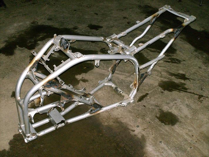

how and where to gusset the frame
Thanks man, here is a pic of what I did to my frame.
blaster1
Thanks for this pic. I've been wanting to do mine for a while now. This shows exactly the trouble spots.
TORKER.
the only place I have EVER seen a blaster frame crack and seperate is on the downtube between the swingarm mount and the pegs. and the front motor mounts. they are fairly stout. now stock 250r frames crack all over the place.

lol:o old thread but yamaha blaster gusset cracked frame after doing the triple at the track .
1 spot Trenga forgot to mention is the part right under the lowest part on the seat......basically right below where your balls sit on the seat. That location is under the most stress on the rear subframe as it absorbs all the force from you as a rider and is still connected to the core of the frame where it endures vertical stress from the swingarm mount and opposite horizontal stress from the front shocks.
