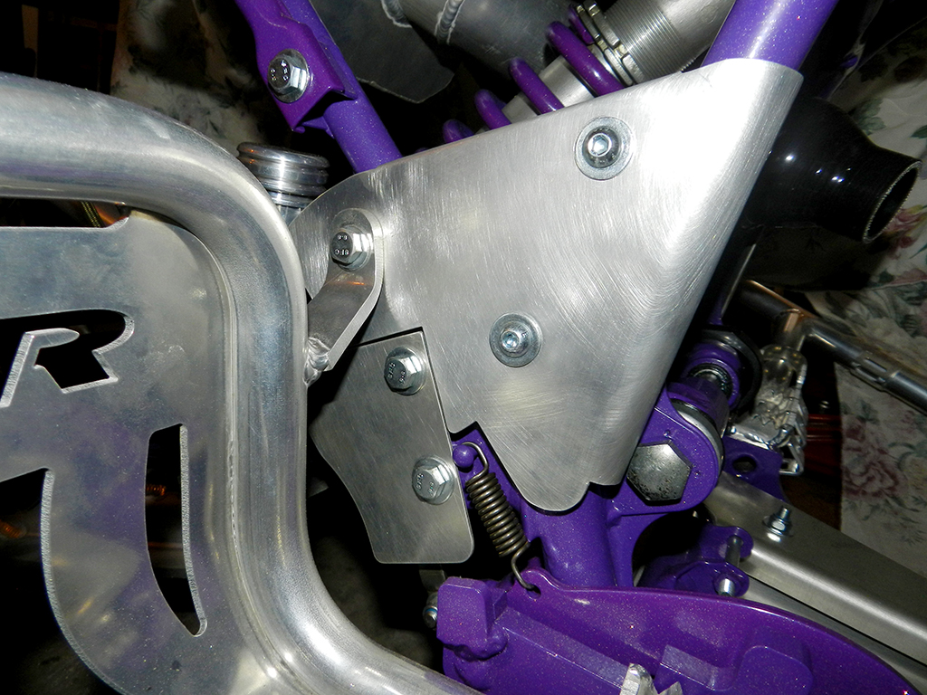

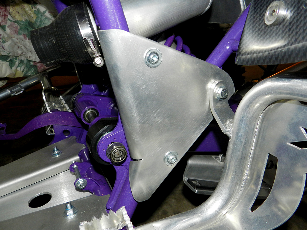

Here are some pic of my concept! They are 16 ga aluminum.
This is how i had to cut my right side to fit my brake setup! Going to do some more trimming on it also!
Left side before.
Left side after.
You can see the pencil marks where i have to drill holes for the heel guard mount spot!

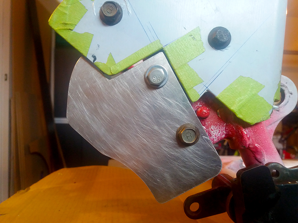

Drilled the holes!
The modded conduit clamps i used on my old guards will work on the new ones!
I use 3M double sided tape to hold the modded conduit clamps in place!
Trying to get the right side to fit, as you can see in pic the frame guard is hitting my master cylinder guard, and wont sit flat. So im going to cut some off!
Using the old wiss hand snips, i cut it down.
Did some more fine trimming.
It fit!
I made the frame guards with 6" of straight tying to cover as much as possible. BUT the frame underneath is not straight, only the top and bottom of the guard touch the frame. The middle does not.
Looking good dude and I like that master cylinder guard.
I would end up mounting mine so they are not touching the frame. Did it on my CR125 I had. Just but some washer in the middle of the frame guard and the mounts. Also thinking about just putting a couple of welded tabs on the frame with a hole in them that I can mount the frame guards on to the blaster as the frames in the middle of getting welding done on it and will not be getting it powered to later in year.

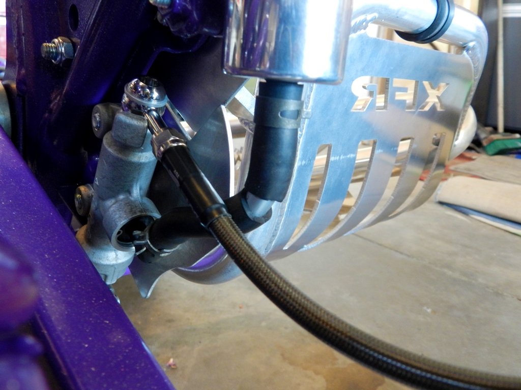

Ended up trimming a little more off the brake side guard and making a cover for the rear master cylinder.
The master cylinder cover.
