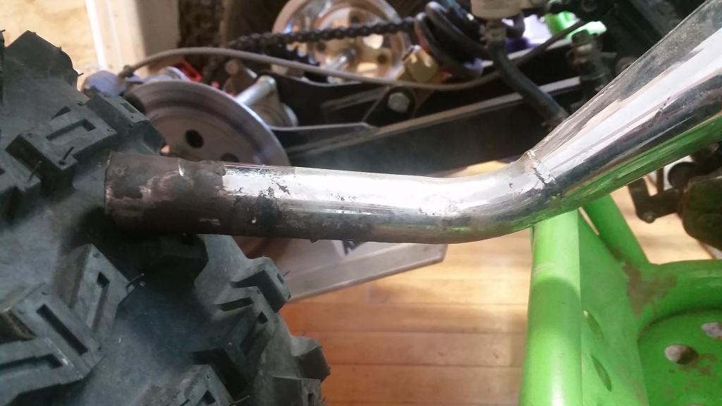

im pondering he thought of welding the flange to my pipe. but with the flange on, it wont come off the frame.
so, im wondering now if i cut about 3 inches off the part that connects to the stinger, if it would fit then?
anyone have thoughts on this? this is the part im thinking of cutting
I wanna know how that turns out if you do it. Could be a possible fix to the dreaded leaky flange! I don't remember, but is it possible to remove it with flange on without the a arm on?
no, its a pain iun the rear to remove lol.
i dont want to just cut it off without knowing... but we will see.
and blasterfun, i would just take that 3" and put it on the stinger and it would mount up fine with a little modification
Ahh i see, if it makes it easier i do have a size uo clamp in black, if you covered shipping i can just send the coupler and you can use the clamps from the green
i will send you a picture of how the pipe goes together when im out in the playhouse next. its weird to explain.
also, if you welded another mount onto the pipe, it wouldnt move at all. currently when its mounted to the a-arm bolt, it can pivot around the bolt. which is why they wont seal, because when it pivots, it pulls straight out of the flange
So true! It's so difficult to make that pipe sit square in the hole. Square and circle, seems unlikely. I tried spacing it with washers off the bracket. Helped a little.
