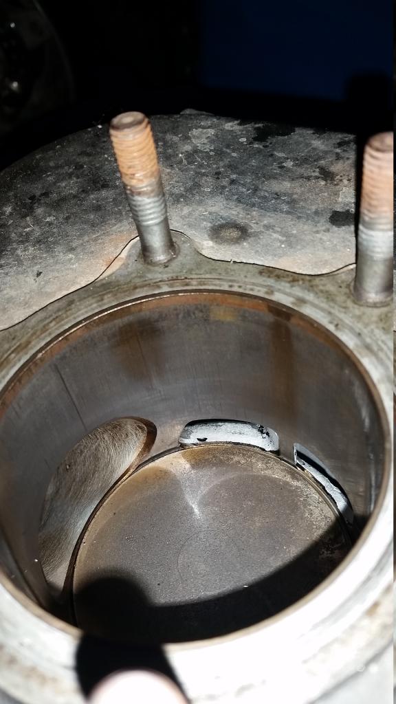

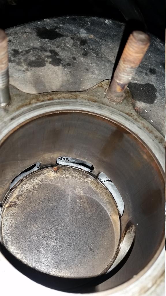

Not trying to dampen your spirits Herp, but how good are the head studs?
It may pay to replace them as well, if the PO had to mix and match nuts, did they stretch the threads some.
New studs will not stretch the budget much further, but may save some strife later in the build!
all of the studs/nuts were the correct threading.
i really dont know where the different sizes came from, unless i was imagining and they all would have fit the same socket lol
studs have a little rust, but nothing major. its only above where the nuts are
As long as you are comfortable that the studs have not been stretched, it should be ok.
Not something that I would recommend, using new nuts on old (unsure about what abuse the PO has given them) studs!
