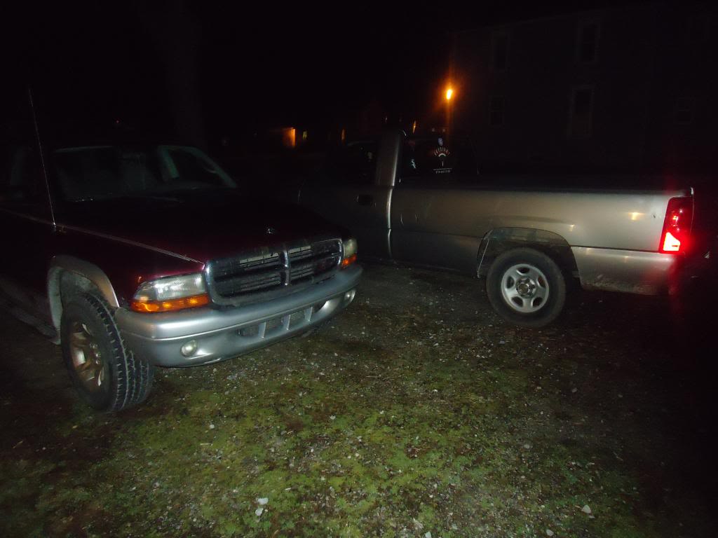

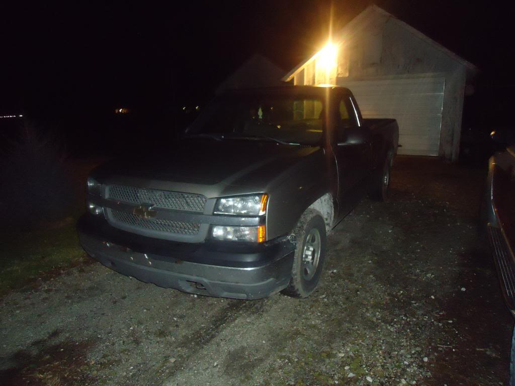

Well I went and picked up my truck last night from my dad. We came to a deal of 2000 dollars on payments and it needs payed uo by january 31st of 2015. The truck is an 03 silverado with the 4.3 v6 and a 5speed manual. All i have right now is a crappy cell phone picture, but when it gets back from my moms work(she had to drive it today while hers was in the shop) illg et some better pictures.
The truck is in really good shape and has 85k miles on it.
only three bads
1.)Needs tires which my dad and i ahve a deal on that
2.)Needs a parking brake release cable
3.)reverse lights are broken.
In case your wondering about teh tire deal, in febuary he is going to buy new ones for his new one and im going to get the old ones off the new truck(nice tread) because their the same size.

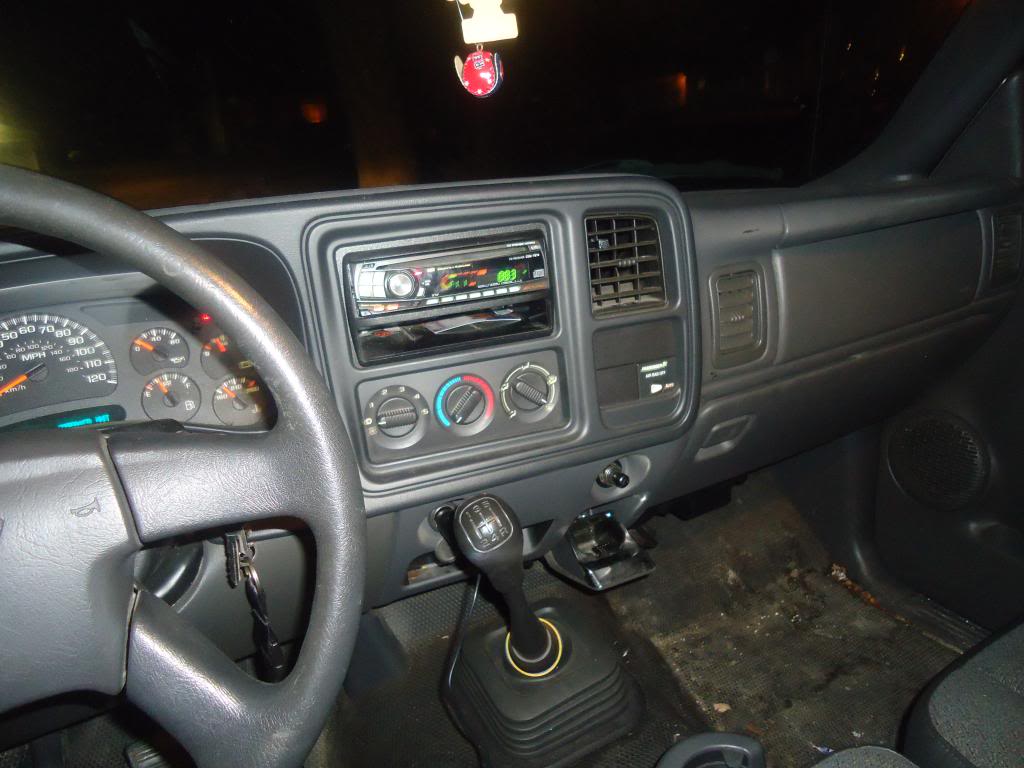

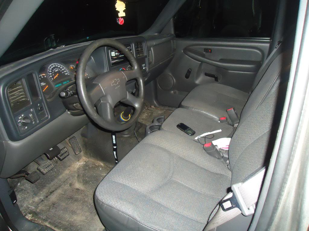

Heres some more pics. ll have t get a few more when its daylight. As you can see the durangos back as well.
First thing is first the stickers on teh back are coming off right away(tomorrow morning) excpet for teh white sox ones(im a huge white sox fan and i put them on there today). Looking to buy a blasterforum.com decal to run on the back of there.
The truck is a little dirty, but that should be cleaned up here in the next couple days.

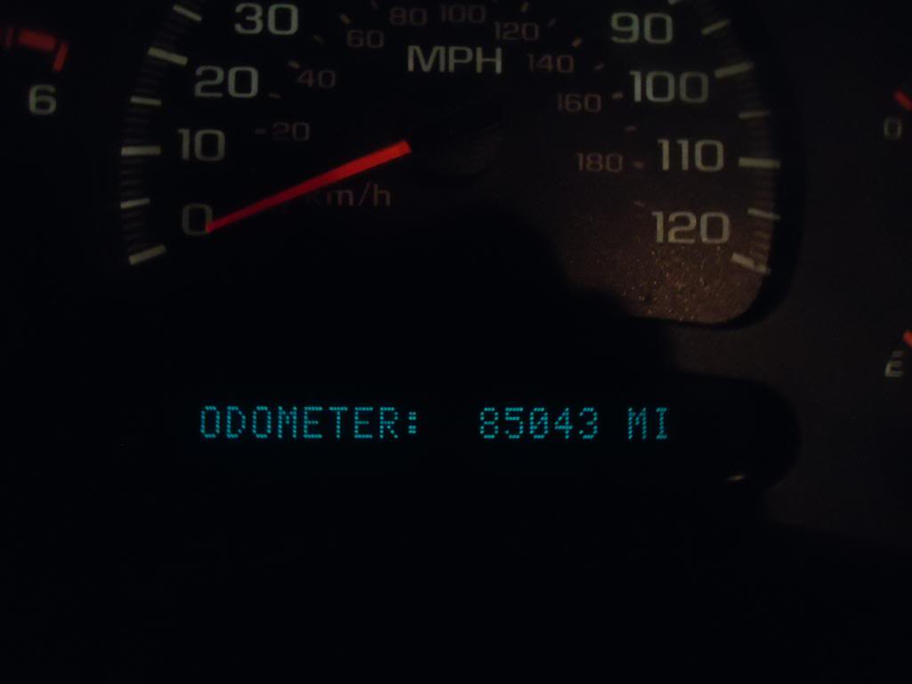

yeah speedometer on the way home from my dads was reading 45 when i was actually doing 70. Its kinda wierd on it. Dont know how to fix it other than a new dash
Don't get a new dash. You can remove your dash (it's easy) and send it out to get fixed. Doesn't take long and is less than 100 bucks. Do a search on stepper motors for your truck. You'll find some companies. I know these trucks pretty good feel free to ask.

doing the motors yourself seems pretty easy. 20 minutes of getting the gauge cluster out and a few hours doing the swap. Wouldnt be to hard.
I sent mine out. Unless you are really good a soldering don't attempt it. The contact points are close together and you have to be careful with heat on the circuit board. If you mess the board up you will have to get one and get all your mileage transferred to it. I am usually a DIY er, but I opted out of that one.

The gauge cluster problems are caused by plastic drive gears in the stepper motors. As the gears wear, they jam and release at random, causing the needles to go crazy. On my 2004 Siverado, the cluster lasted about 85K. I had a mobile repair guy come out and rebuild it right in the parking lot at work. Never had a problem since. The new stepper motors have metal gears, so no more sticking.
