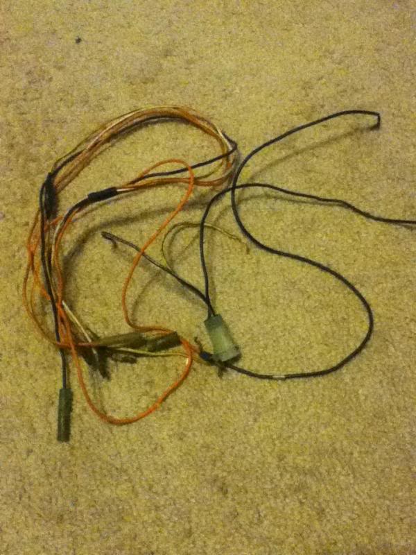

Guess that's my next step, re-thread and put a new matching flange nut on. I've got alot of little crap to take care of, already cleaned the carb, need to make a new wire harness. Check to see if the oil pump was deleted properly, possibly remove the tors system. I gotta order a compression tester and see where it's at. It will turn over now since I removed the flywheel and has compression. So things are looking up so far. I:I I'll update as I find out more.

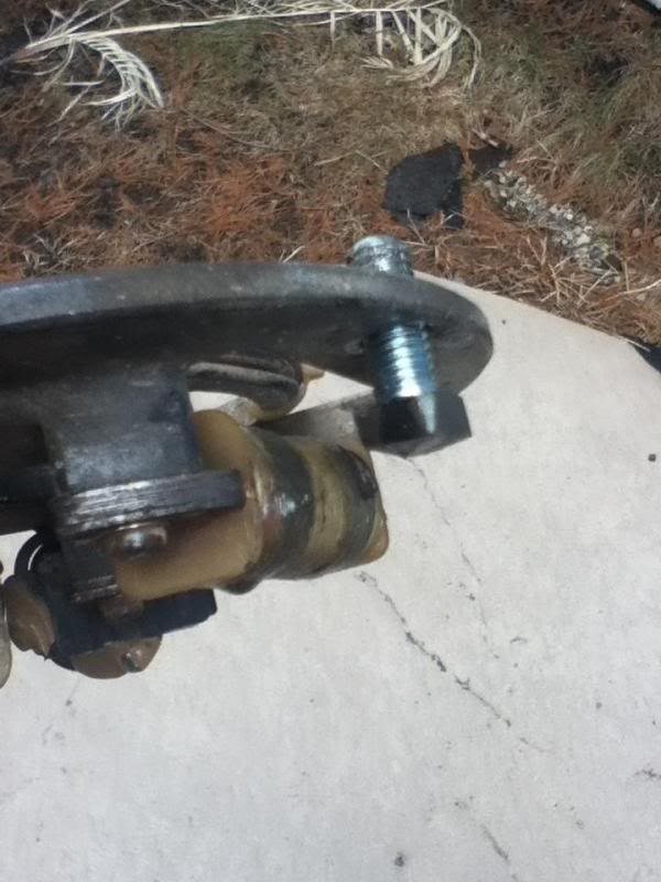

Ok I finally pulled the stator off and I found the culprit. Someone had ground a bolt head square supposedly to fit under the flywheel but the flywheel was torqued against it and locked the motor up. So I don't think there is anything wrong with the wheeler besides the stripped crank. The seal looks new and there is zero play in the crank end. I plan on doing a leak test to be sure. I haven't looked at the other side yet. Are there special tools to pull the clutch or does it slide right off? I might not even mess with it unless the test shows a leak somewhere.

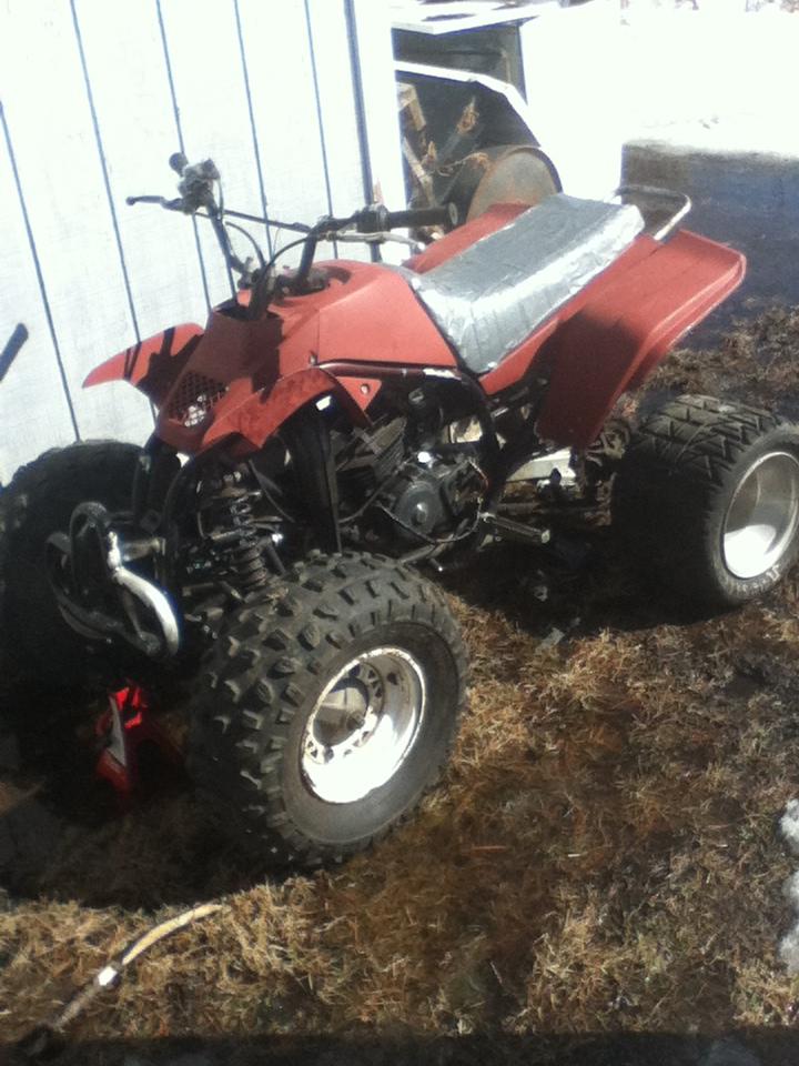

Ok I finally got the blaster back together today and wired up. I got it to start but it won't rev up well and bogs out and stalls. Any ideas where to go from here? Also would the fuel mixture effect it at all?
Set float level, adjust idle, check that jets are correct for your mods, but first leak test it.

It's all stock, what jetting should I start with? I swapped carbs and never thought to check the jetting but I couldn't get it to start with the stock carb that was on the motor. I switched to a different spare stock carb that I just got off someone.
The stock 230 main jet should be fine if its all stock, so I would start there. Make sure the main wasn't swopped out and while the carb is off check your reed cage and reed petals. Bad, cracked or worn out reeds would cause it to bog and stall out when given gas.
Never swap a carb without checking it for cleanliness or jetting.
Take the carb off, clean, adjust float, correct jetting for stock is #230 main, #32.5 pilot ,needle on middle slot.
