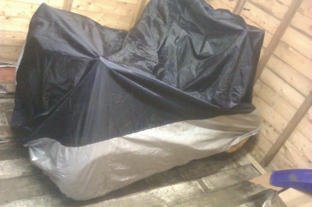

Quad Back In Bed Too Cold To Do Anything! :( doesn't help when shed is leaking like f*ck :\

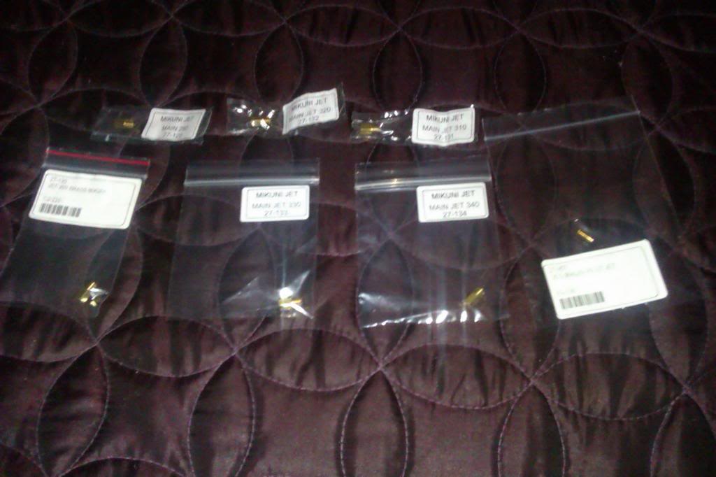

Got My Jets Ordered :D 290-340 Sizes and the 32.5 stock pilot jet guy is also sending me a higher size pilot for later on if need it. £25/$35 and that's me got quad ready to play!:D

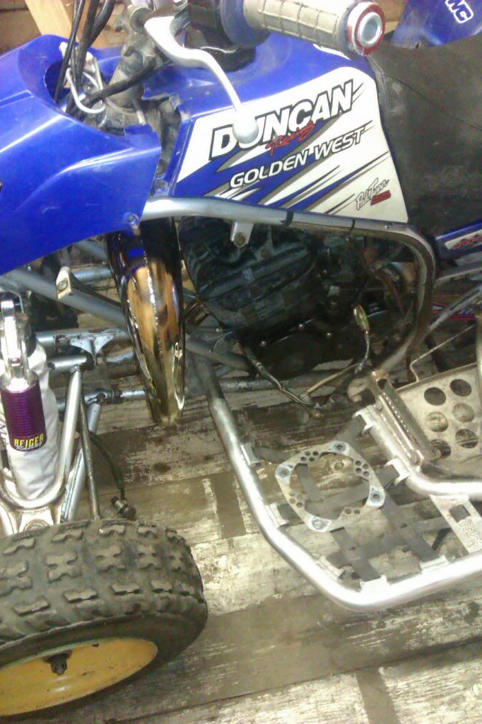

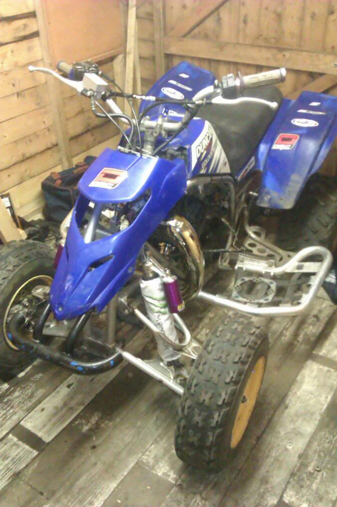

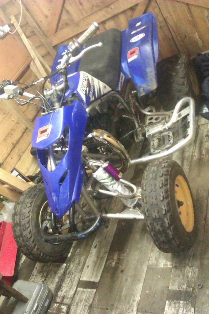

so got bored as not much to do now.. still got brakes to do but need to put quad on axle stands to get wheels off to get into calipers. anyway took some pictures :)
How do you like the shock covers? Im gonna get a pair because i dont feel like painting shocks. How is the quality of them?
there no bad man i also have the yamaha ones but prefer the white ones for color etc Velcro good as i rode quad with them on few months back :) easier to put in washing machine! haha
my jets should be here monday :) was going to go get brakes done tonight but due to my roof leaking its broke my light so its pish black :( need to do it tomorrow hopefully. anyone know if that slime stuff would seal my front rim (its damaged) for me to use it until i get front rims next month? just i really want out this month but my rim won't hold air. its defo rim as its only the one and its the one that had the most damage.
gonna start jets tomorrow. thinking about just doing a plug chop as it would be safer. anyone got a link to how to plug chop searched earlier but didn't show a thread with on how to.
