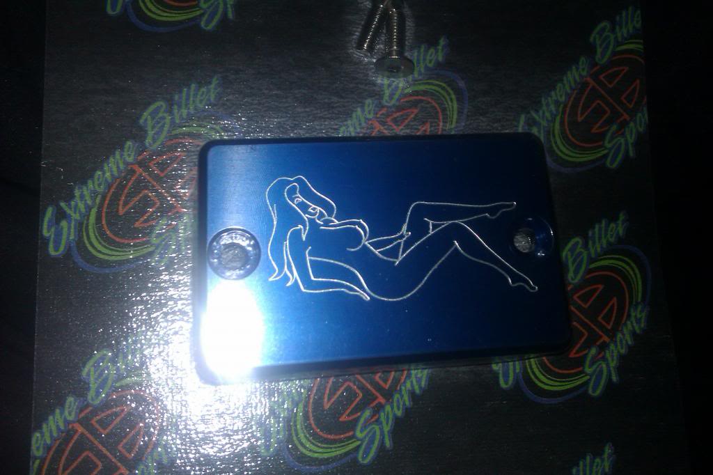

ordered this tonight
BLASTER BANSHEE RAPTOR 660 RIDE IT LIKE YOU STOLE IT BLUE BILLET BRAKE COVER | eBay
my stock parts are just not selling really thinking about just putting them up on ebay at 99p start and let them run. rims and tires won't be ordered(if i can't sell stock parts) until feb when i get birthday money as im skint plus won't be able to work on quad alot the now as starting my course on monday. but will HOPEFULLY! get out next month need out badly not been out since june.
guy posted out my brake cover today i got him to change it to the Lady Billet one instead of the one mentioned above as i want to get the throttle cover to match.

that sexy brake lid is going to distract you while riding and cause a crash :) LOL
haha ;) hope not :p haha il be getting the throttle one to match :D need to get some rims and tires first though as can't ride it without them as one of my rims are leaking and the tires are beyond bald lol. but getting a good deal on rims and razr 2 tires I:I hopefully be able to order them in 2 weeks once i get birthday money :)
