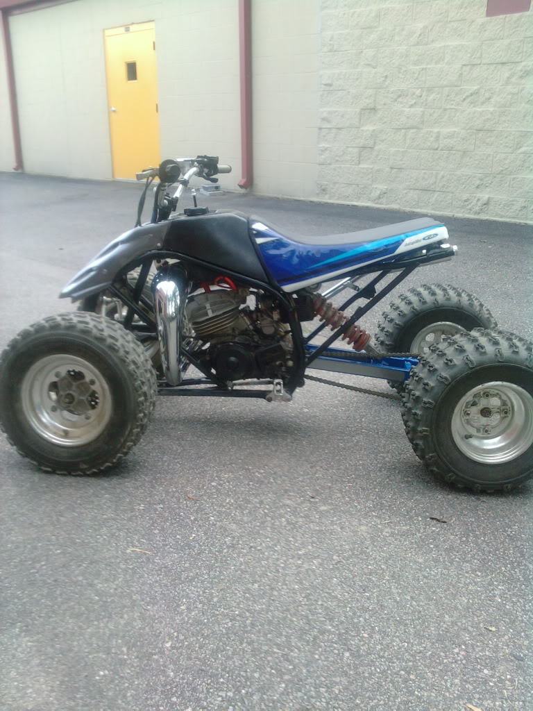

yeah thats not bad.. i dont know how much you have thought about the subject, but gearing plays a big role.
i have thought about it but it seems i get mixed reviews. in my mind gearing lower will make me faster but some like gearing higher for less shifting. i dunno. im running 14-40 with 20" tires and i start off in 2nd gear and i like it.
imo its all testing and tuning, 14-40 is a great trail ratio but prob not going to cut it for drags, also it all depends on what your specific motor can pull effectively. if you want to keep a 14t up front throw a 38 in the rear
none the less that thing is movin! great job on the build homie I:I my ladys raptor 350 runs 7.0 on the 300' so your cookin
congrats on 2nd place win :)

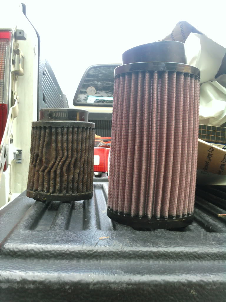

a little update here i was able to put on a nology coil and ended up changing the intake setup to a pod filter directly onto the carb. had to do a little cutting with the sawzall to get the pod filter to clear the frame... seems to be running much better! its rich now with the 180 like it should be, gotta swap some jets working my way down slow till she is juuuuust right!! slades on the 15 for another race, maybe even a 1/8th mile asphault tomorow. will get some more pics and hopefully a vid or 2.

figured i could show a before and after..
after
oh BTW nice build, looks like a totally different machine in the before-after pics...hard to belive its the same bike
thanks dude! i plan on painting the a arms but im tossing around the idea to make it a ridgid setup by welding chromoly tubing to spindles with spindle mount wheels.
bike looks good what type of swing arm is that?
the swingarm was made by strokedtater and its freagin awsome! he does excelent work!

that looks similar to the sized used in cfm's? am i right? i went from a pod like your old one but uni to a cfm. WOW
