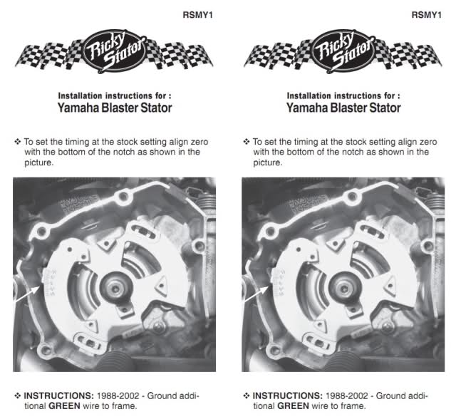

thanks for the tip bro. i also installed a adjustable timming plate. unfortunatly i dont see where its supposed to line up... anyone have one that can shed some light?
the ricky stator's line up with something in the cases..i cannot remember for sure. have you tried looking at the ricky stator website for help..sorry i cannot remember exaclty what, but it does go off of something in the cases where it sits. if you have that one.

haha thanks guys!! i got it set up right now. i also had the keyway partially sheered off and that wasnt helping me get anything straight.

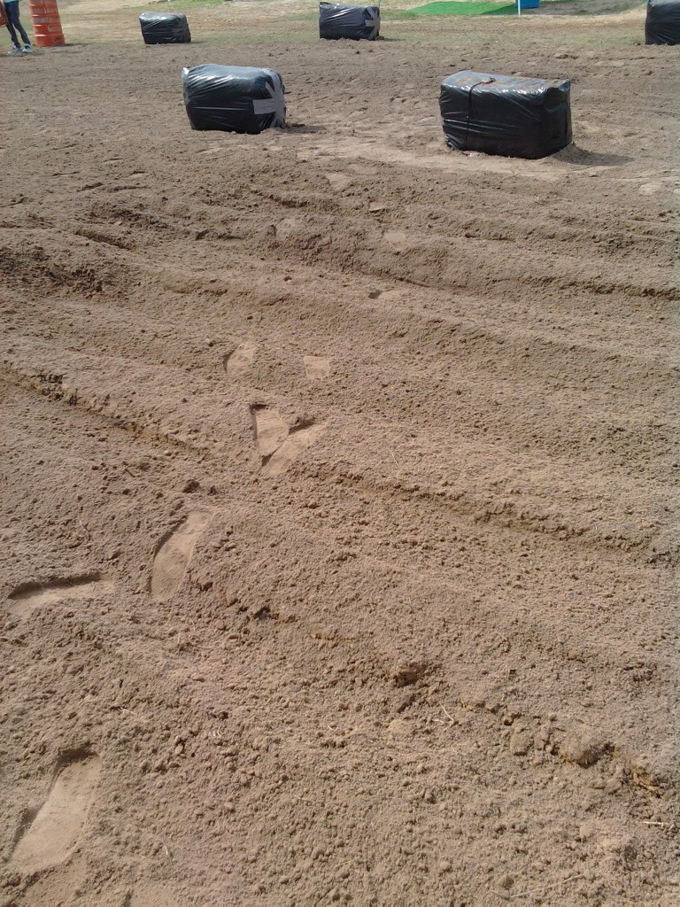

had to work on it at the track a little bit but seems to be running great. needs to be faster though... hha. i got the jetting pretty damn close and now i can start messing with the timming. i cant really tell much of a difference with the q16 other than it smells bad untill i put some bubble gum stuff in it. maybe it will do better once i start upping the timing. i had it close to stock trying to get this jetting right with the different fuel. it calls for 4-6% increase in fuel and i ended up pretty damn close to what i was running witch is 48-175 from 45-170 without the fuel. i am also one of the only guys without paddle tires at the track . once the motorcycles run it the stuff gets pretty deep.
get some haulers and dont look back! i tried my 10 paddle haulers on the trail bike last sunday and she was throwing 20ft roosts all day, pulled them just fine I:I

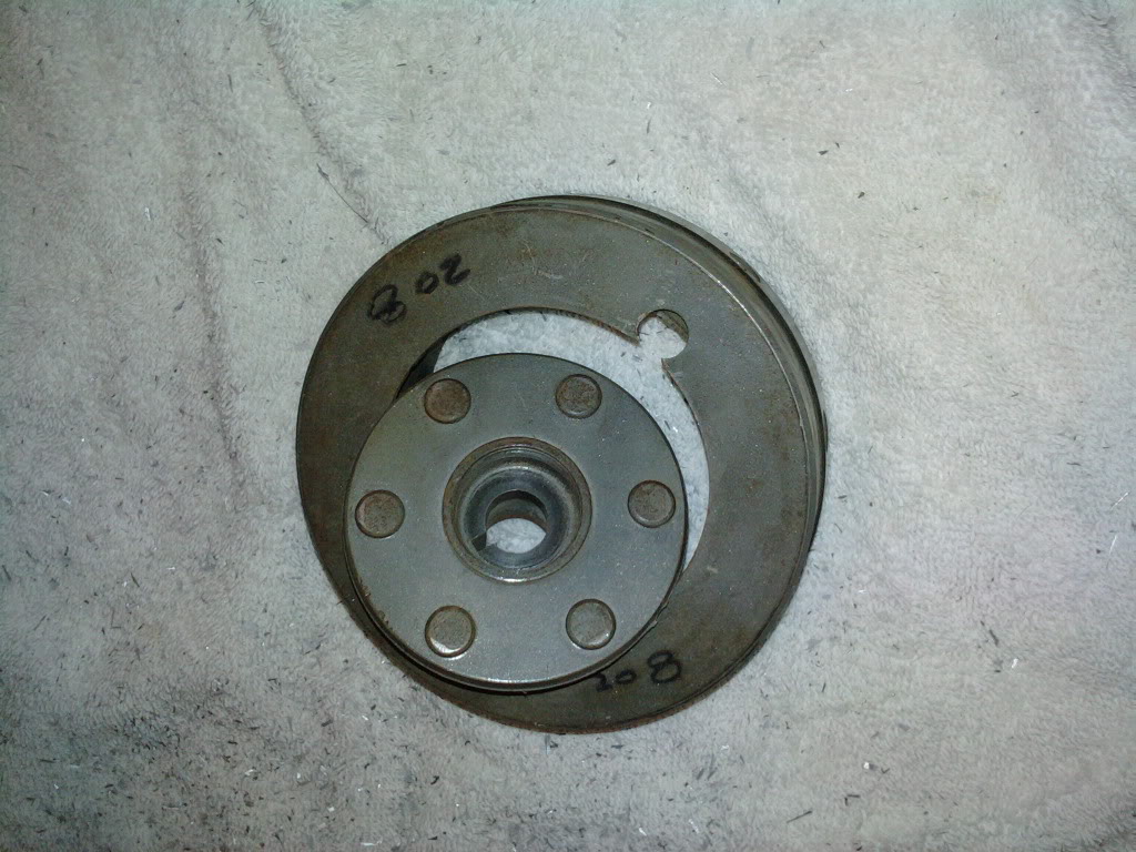

did some 300 ft runs on friday night at busco and it was a lot of fun. my best time was 6.3 witch is ok but still think i need the drag port and some pro wedges or paddles. not sure witch way to go with it yet. i had a couple problems while i was there mainly flywheel issues. then sheered a keyway right after.
big thanks to mike (con8quest) for letting me use his flywheel and keyway from his trail bike so he could wax me on the track.

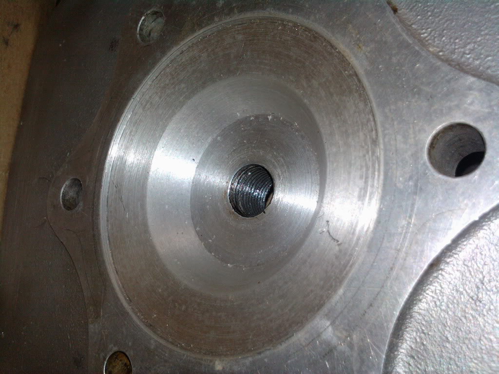

i found an la sleeve 240 topend for her! i also found a member that wanted my flotek ported motor so its now sold:( denny is a little to buisy to do the work on the new topend so i just sent it to another accomplished and professional engine builder for a drag port for a +3 stroker. the la sleeve topend i found on ebay and had suposidly been ported already by ct racing (fluffed and buffed) basically just cleaned up the casting but i want an all out drag port! this is a pic of the head that had been moddified by ct. it will be getting fixed...
