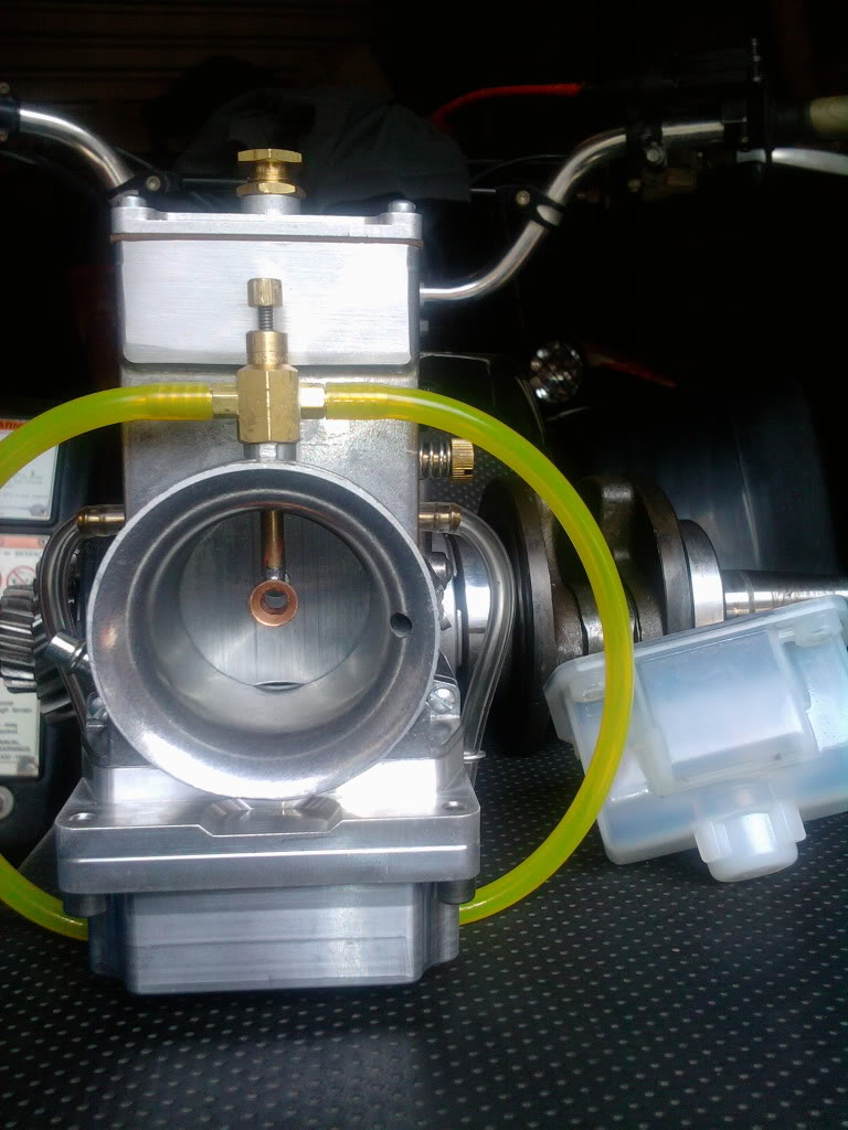

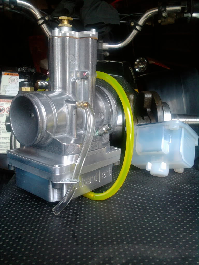

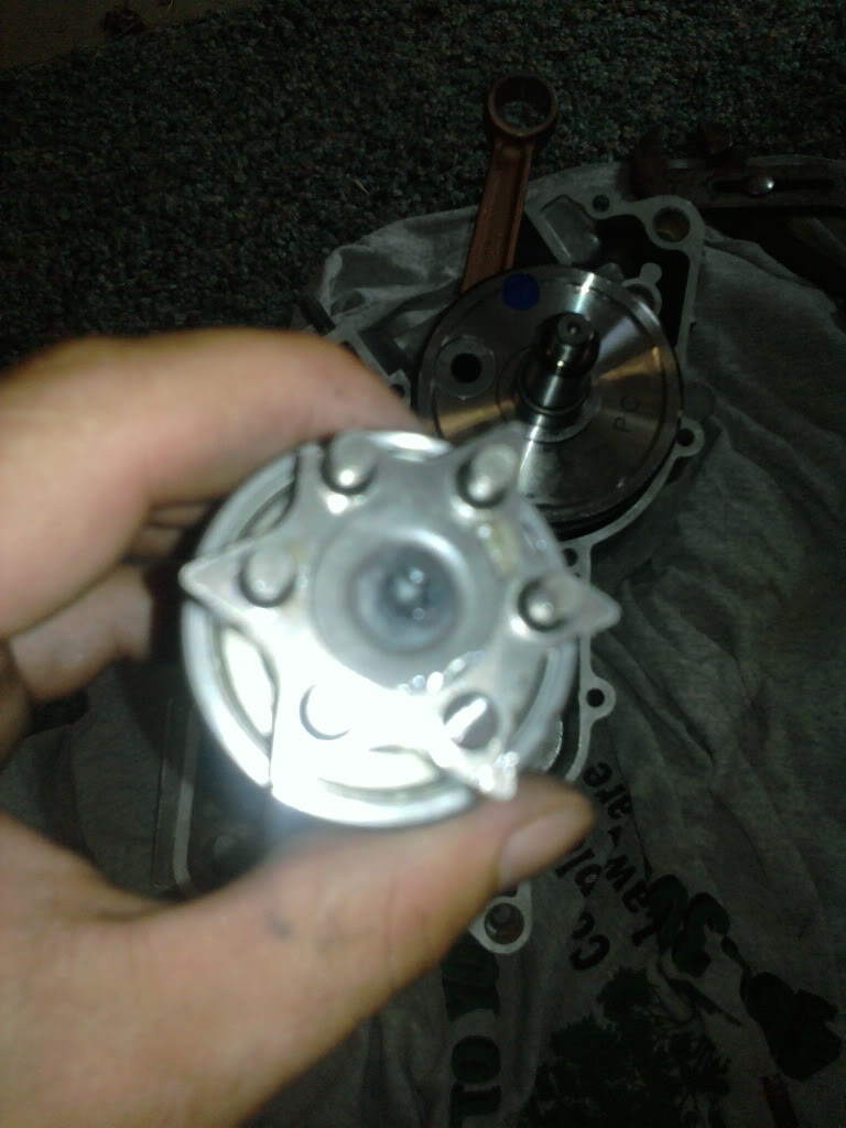

got a few parts in the mail one of witch is a saweet efin carb!! im still waiting on the trans to put the motor together though. the billet bowl is on the carb and the clear looking one to the right is the original.

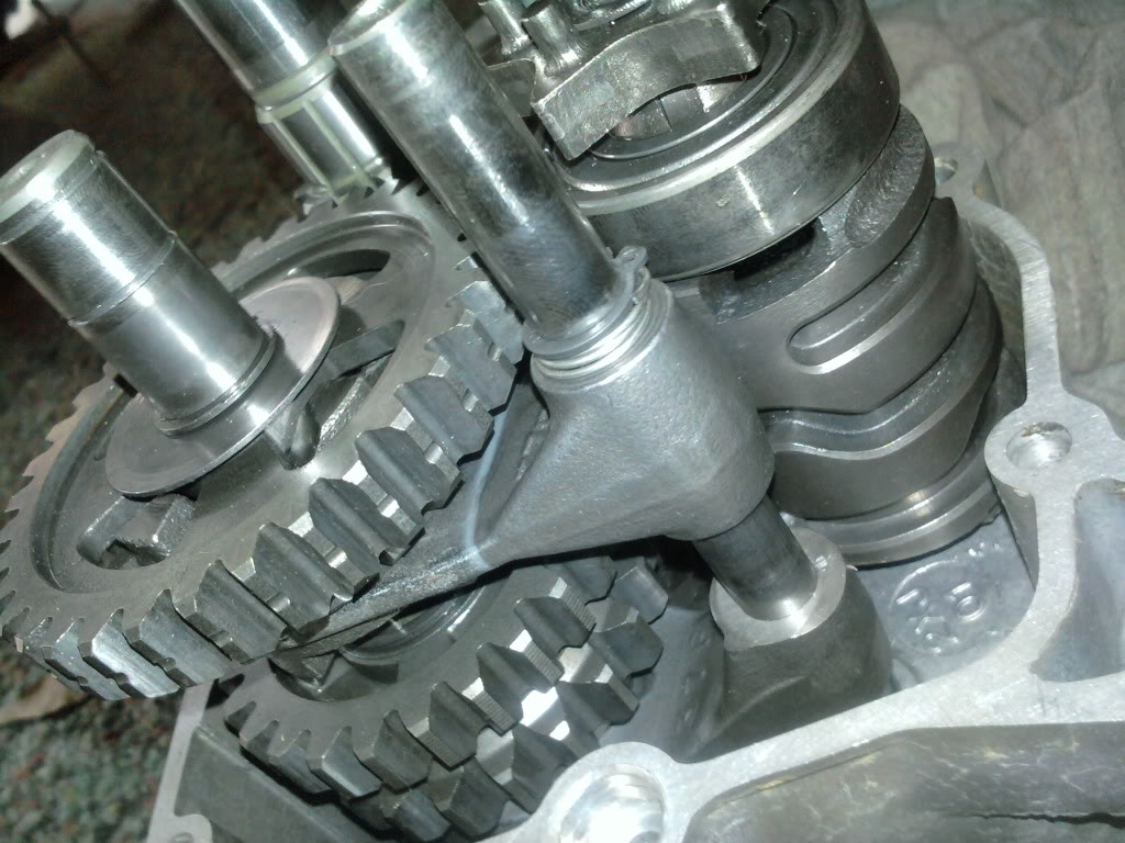

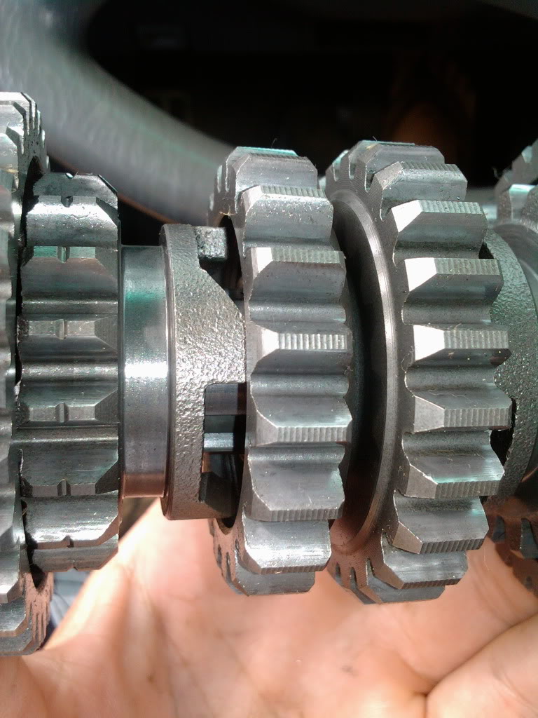

thanks guys!! i finally got my overide tranny in yesterday. so here are some pics
there is a spring between the c clip and the shift fork and i had to trim it a little to let it go into 1st gear
because there is not a 6th gear i had to remove the pin that puts it into 6th
thanks to brad at tyson for the tranny!!

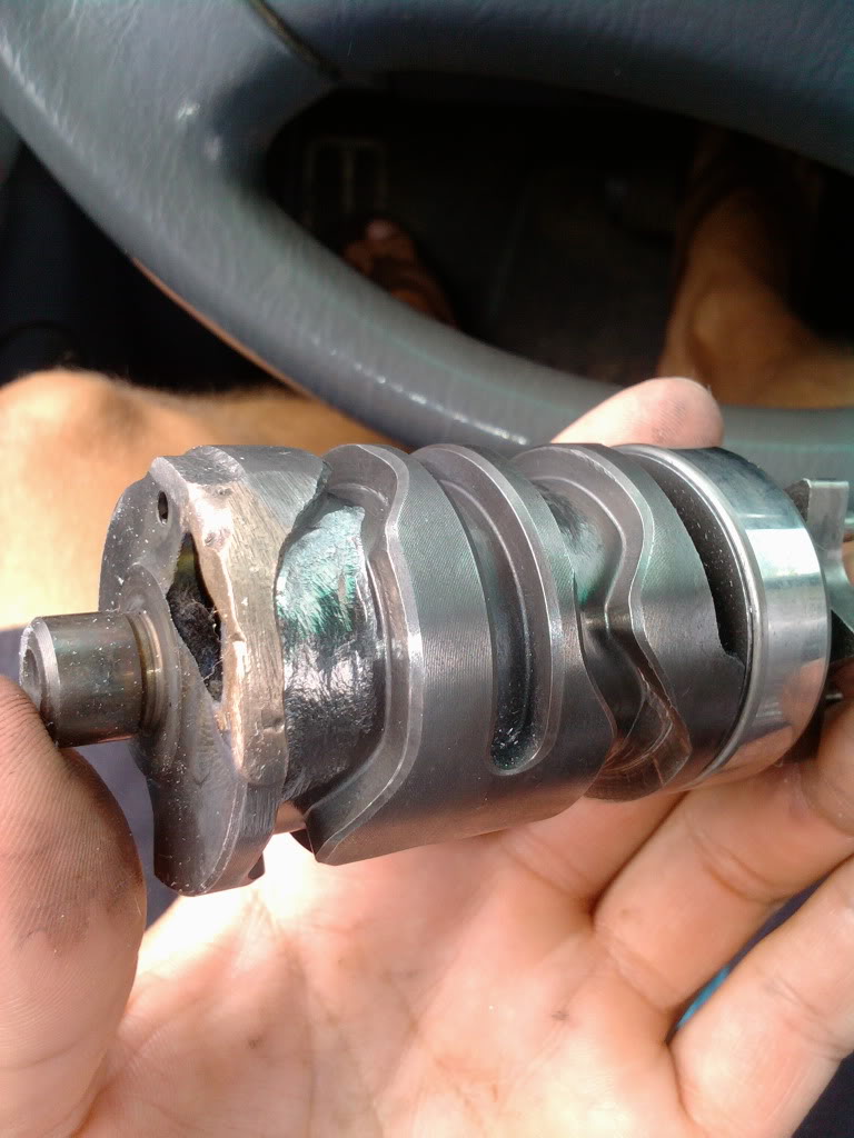

honestly dont know. i wish i had a stock tranny to compare it to. the motor is already put together so i cant do much but ride it now :)
just wondering.. i had one from an unknown builder done like that.. well the flotek HP totally shattered 2nd gear and made a big ole nasty mess. X(
well i hope that doesnt happen to mine.. of course i dont have flotek power :(
i have learned alot about these trannys this year and how my last one was cut is def. not the way to go. your drum is different though so i do not think my problem tranny was done by brad.

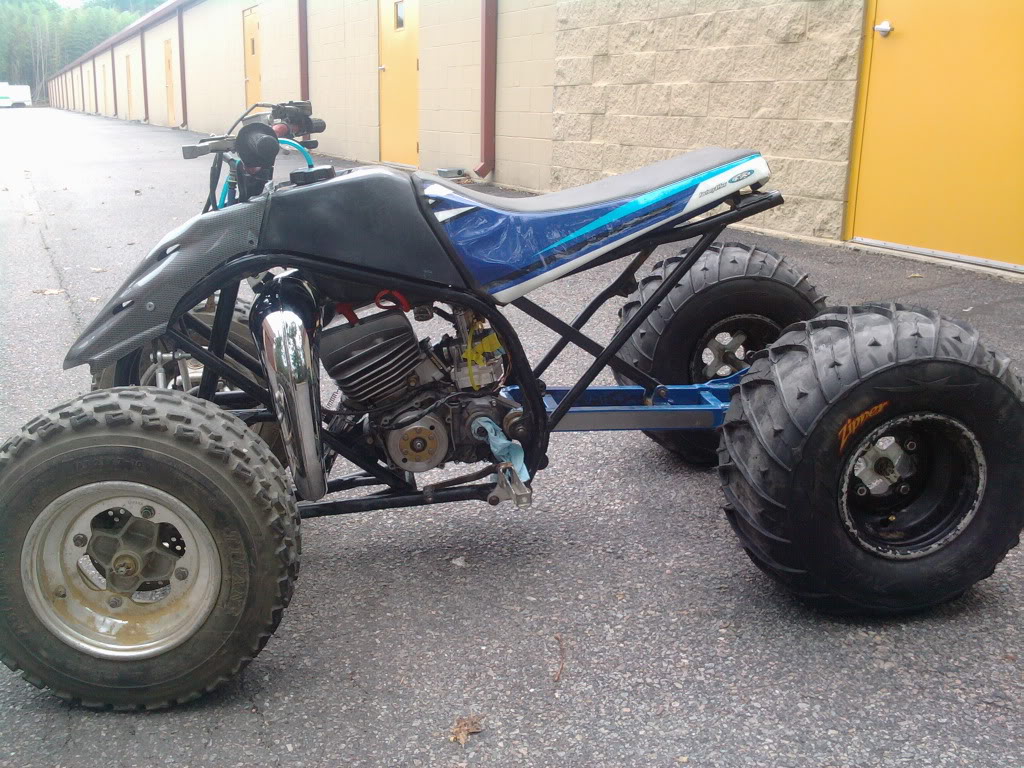

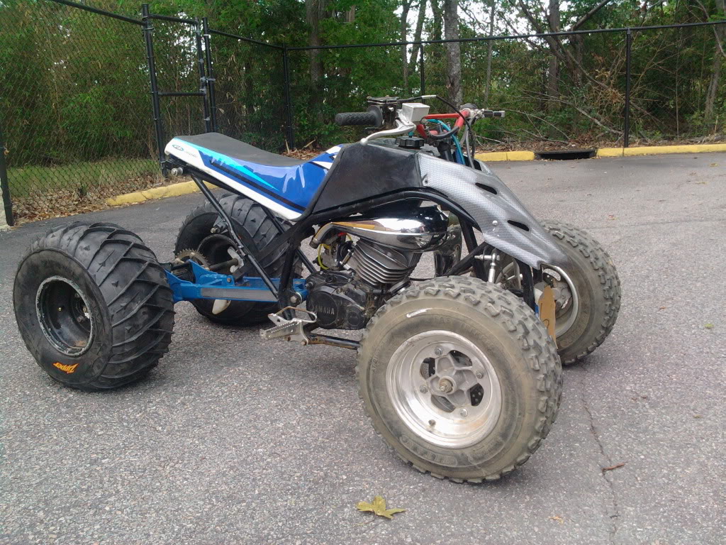

im calling it a rat rod for now.. nothing is pc or chrome. haha. im missing an oil seal for the output shaft where the sprocket goes. hopefully will be picking one up in the am.
I like it except your rear spring rate might be little to tight. 8-|
