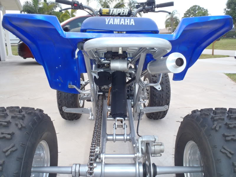

I had a Uni pod filter on my stock carb.. couldnt get it jetted right.. its sluggish in the low end.. just rebuilt.. no air leaks
everyone says to run a balancer tube/velocity stack..
lets see if they're right!

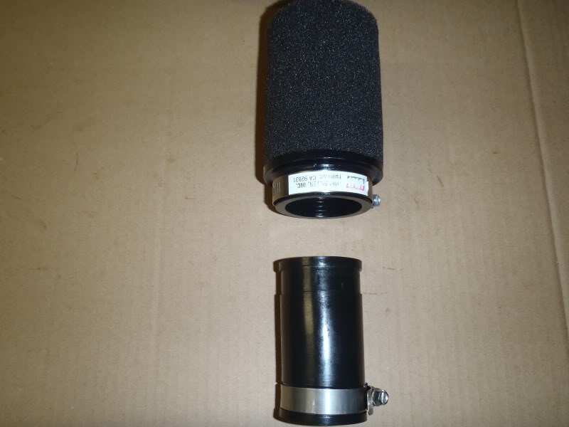

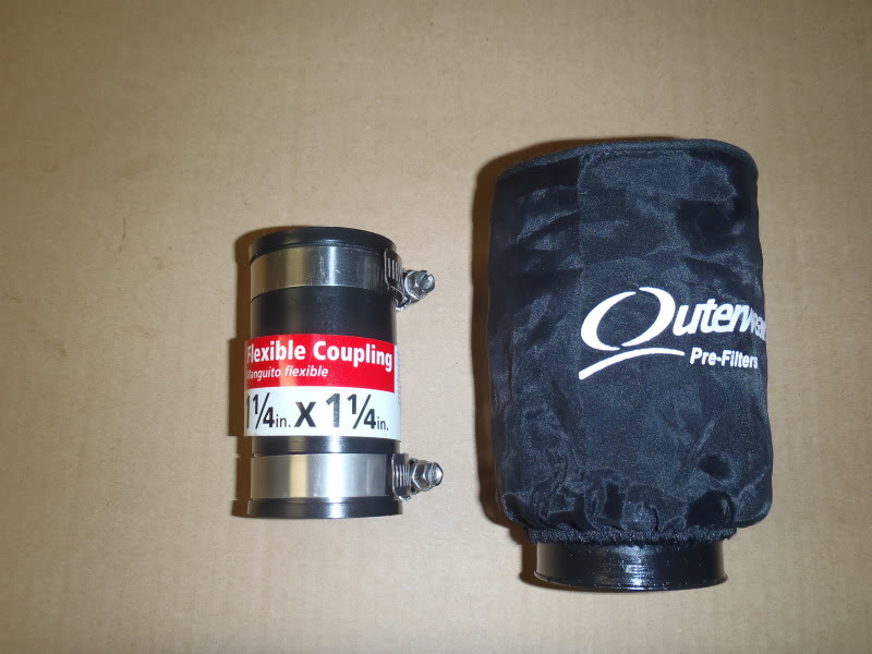

started with these parts

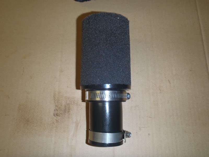

i removed the clamp off one side of the coupling and then inserted into the uni filter. it actually kinda snaps in..nice and tight.. i put the clamp on it just in case.

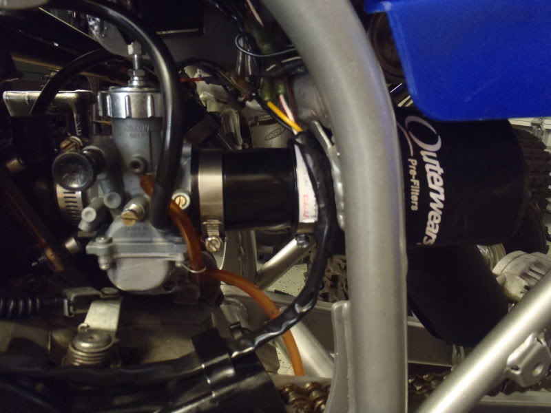

installed
my jetting prior to tube instal.
320 main jet
stock pilot
needle at 2nd from top
screams on the top end
sluggish at bottom/mid throttle
plug chop shows its running right
ive tried all kinds of jetting combos and cant get the low end to rip like it use to.
im gonna run it tomorrow and see if i can dial it in with this tube.
installed
320 main jet
stock pilot
