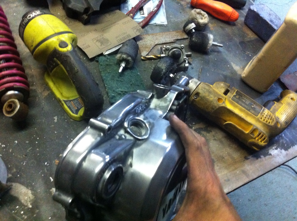

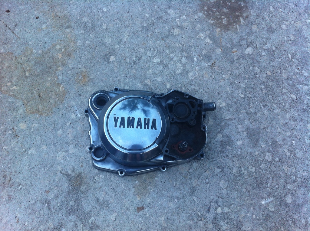

decied to find something to do that didnt hurt my tailbone so i pollished my clutch cover!!! i used my pollish wheel and a drill and some compound

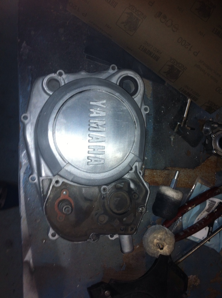

first you going to most likely need to sandblaster then sand with 600 than 1200 the object is to get it as shiny as possible (by sanding) before you pollish it(i recomend a buffer wheel) pollish pollish pollish. start with a harder wheel and work your way down to a drill you can use block compound or buffing compound i used both

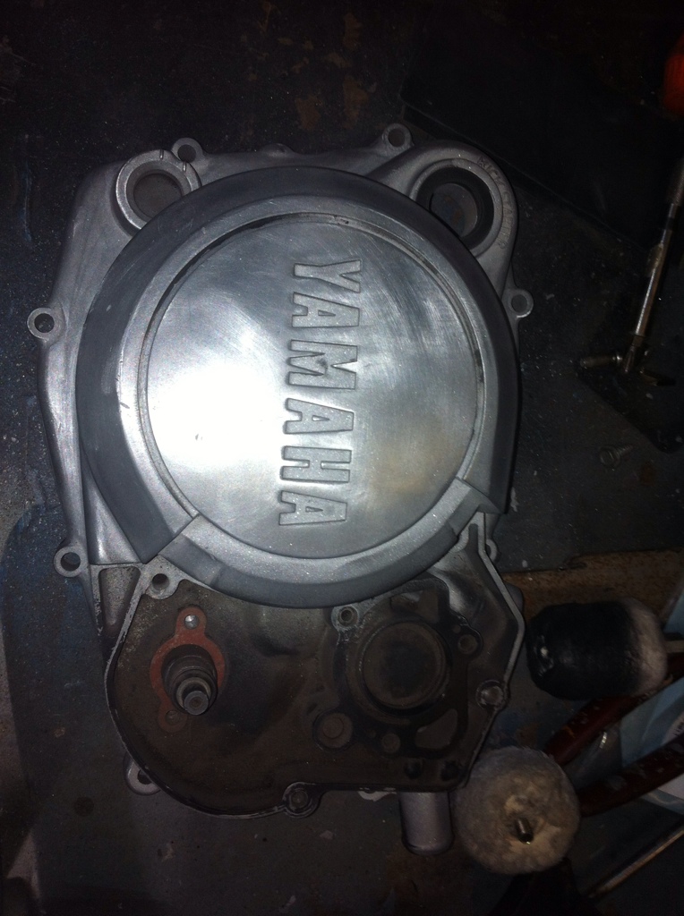

start:
after sandblasting:

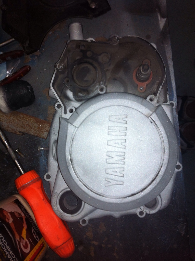

after 600 grit:
after 1200 grit:
so far:

start:
![7f3dd77b.jpg](/proxy.php?image=http%3A%2F%2Fi1242.photobucket.com%2Falbums%2Fgg535%2Fmotoman159%2F7f3dd77b.jpg&hash=e7999a402e8d9926aa25aaf271e6e026)
after sandblasting:
![7e7da078.jpg](/proxy.php?image=http%3A%2F%2Fi1242.photobucket.com%2Falbums%2Fgg535%2Fmotoman159%2F7e7da078.jpg&hash=21eb31a8870fc418b9fa6d45bdc070e6)
after 600 grit:
![7f6ceb2e.jpg](/proxy.php?image=http%3A%2F%2Fi1242.photobucket.com%2Falbums%2Fgg535%2Fmotoman159%2F7f6ceb2e.jpg&hash=e28f13ac6c1cd0c5a7f1fe1ab73feae1)
after 1200 grit:
![d45ec79f.jpg](/proxy.php?image=http%3A%2F%2Fi1242.photobucket.com%2Falbums%2Fgg535%2Fmotoman159%2Fd45ec79f.jpg&hash=5282527b95e00c41ebc9f3f826a22a12)
so far:
![ffa497a7.jpg](/proxy.php?image=http%3A%2F%2Fi1242.photobucket.com%2Falbums%2Fgg535%2Fmotoman159%2Fffa497a7.jpg&hash=17dfa89629993d59afac57b4a5f66670)
![bd1515de.jpg](/proxy.php?image=http%3A%2F%2Fi1242.photobucket.com%2Falbums%2Fgg535%2Fmotoman159%2Fbd1515de.jpg&hash=2ee4518d4f9fc221dcfeb5fb889489f8)
