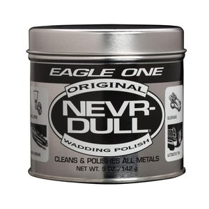

Looking kick ass already!
May I suggest this product here when you get to your final stages...
3
Sure man only thing is I live in Scotland so not sure if I can purchase this stuff here. What does this product do? Just polish and prevent its dulling
