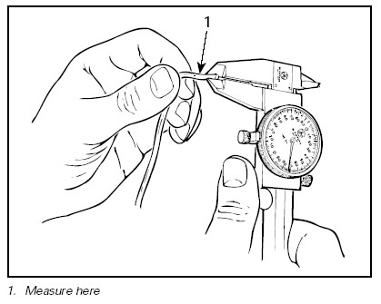

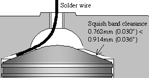

The burn on the squish area suggests the gap is too large.
You might need to tighten up your squish band a bit.
Measure it with 0.060" lead solder through the sparkplug hole like this:
You want to push the solder out to the edge of the cylinder and turn the flywheel over by hand.
Or you can take the head off and do it more accurately like this:
Measure the squished solder to get the gap:
Should be minimum 0.020" to maximum 0.050"
Ideally 0.030" to 0.040"
You can use thinner gaskets (cut basegaskets out of paper, headgaskets out of aluminum)
or skim the head or cylinder to tighten it up.
