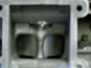

Ok so I hear a couple peeps talking about puttting a cr125 reed cage in thier blasters. Does ne one have ne info on this topic? What year to use? What mods must be done to make this work or is it direct bolt on? Good mod compared to vf3's?
check the other thread "reeds" colby(cwhutzell) can tell u everything u could want to know. he built my stock bore stroker engine and i can hang with a lot of the big bore blasters. your intake will take a good bit of widening to get ot to fit..ill try and get pics from my computer later....im on my cell right now lol.
heres my intake not widened for the cage and back when i was just 3mm
heres my intake as it looks now
